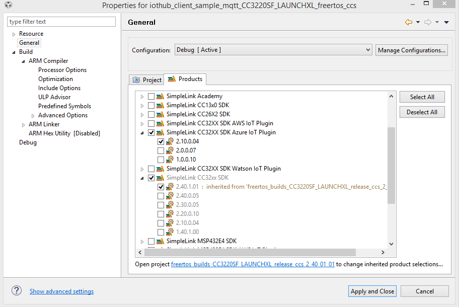

  • Hi Team,
    Sorry for delayed response i was on leave,
    One method:
    If i import azure example project(iothub_client_sample_mqtt) automatically taking latest version sdk.
    How to change sdk version v2.30 there is no option to change sdk version.

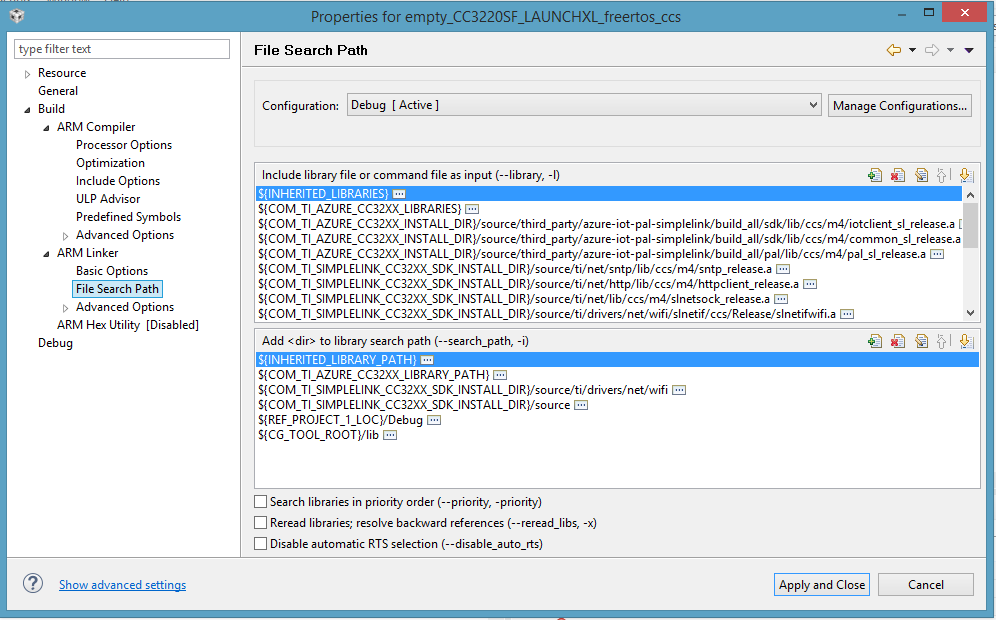

    I imported empty project(v2.30).
    Added all azure related library (project->properties->include Options and predefined symbols and file search path)
    After modification i am getting error.
    Why i am getting this is error.
    Thank You
        Vasu
  • Vasu,
    You can see that the SimpleLink SDK is being provided by a dependency in the project (FreeRTOS builds). You will need to delete this freeRTOS project and reimport the same project from the SDK you wish to use.
    BR,
    Vince
  • Hi Vincent,
    Thank you for your response,
    Finally i can able to communicate Azure IoT hub.
