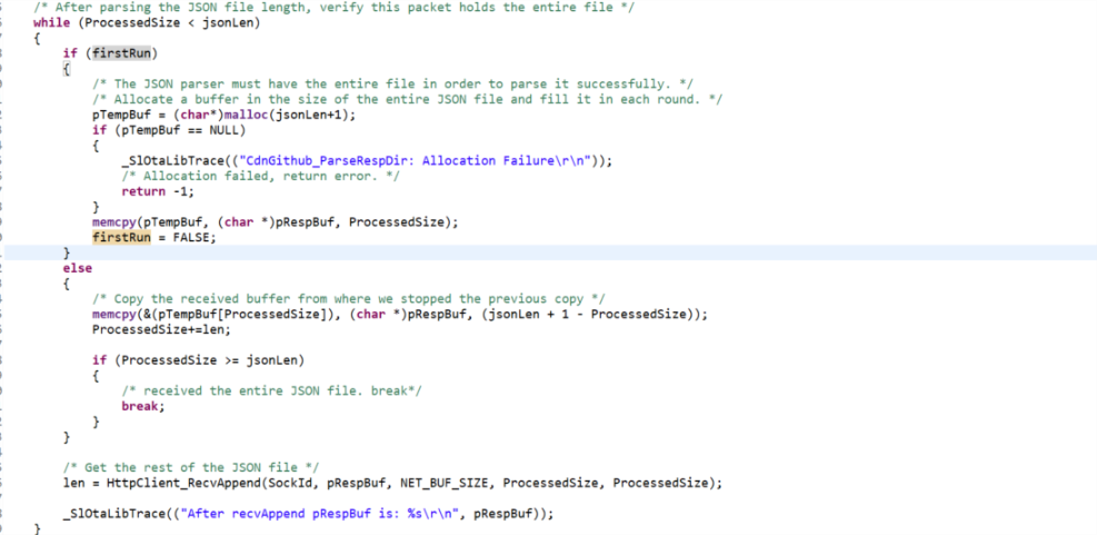

Trying to run the CloudOTA example.
After getting the response from the HTTP request, when it has to allocate the size as per the content length, it is unable to do so. It return -1.

    It looks like the malloc failure. I tried to increase the value of the "Not Configurable numbers" in the ota.h because when printed out the value of the response buffer, I realized that it's not able to get the download URL but there are several warnings about the integer truncation so I put that back to normal. The response length of the json(response after hitting the APIs) is 212436. This is what it's trying to allocate in the above screenshot.

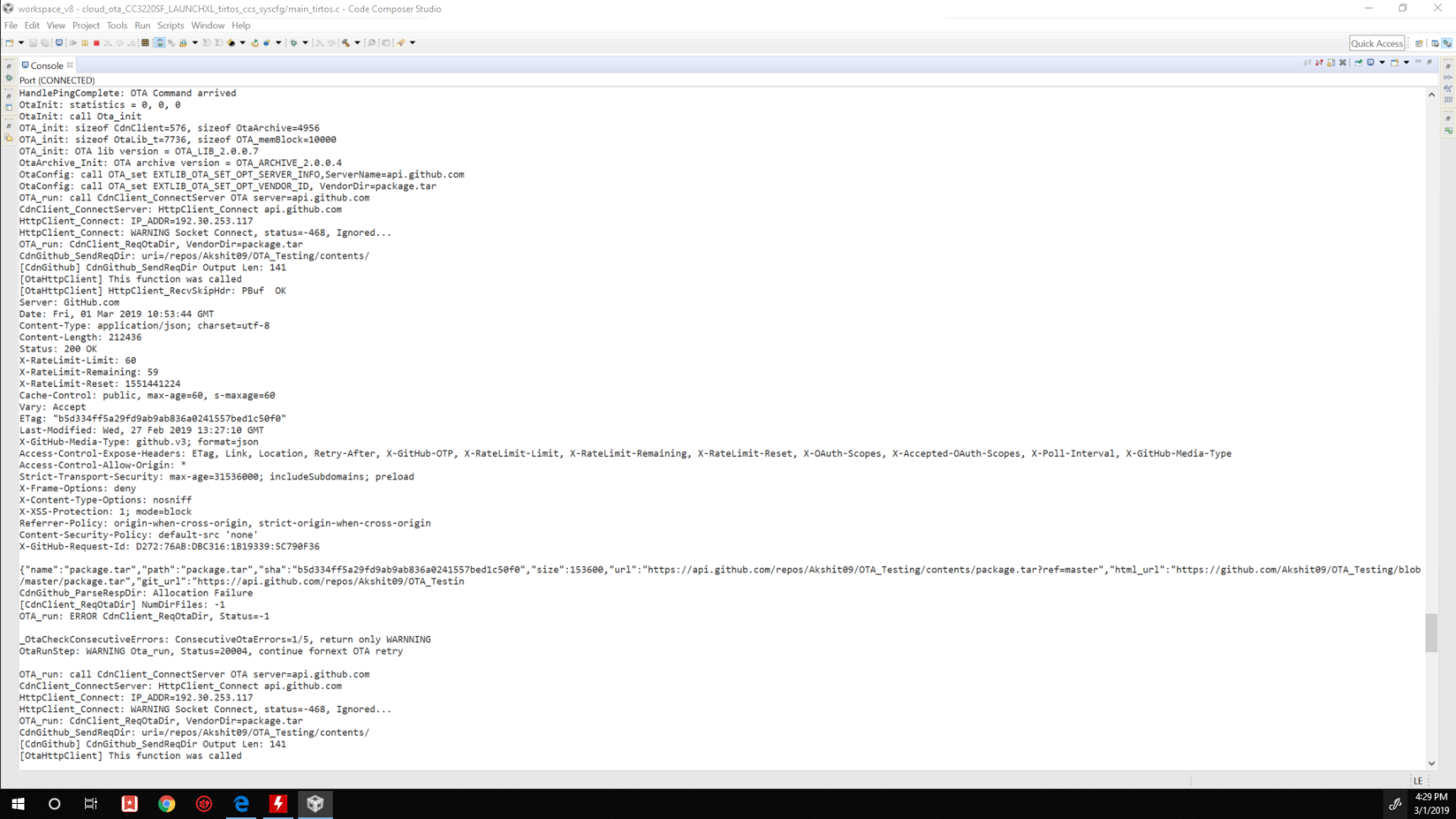

    As you asked for the complete log, below is the screenshot of that, with that I have also printed the buffer received after the API.
  • Well, this is the problem. You are trying to read a very long tar file (i guess this is your OTA image tarball) while this step tries to read the content of your OTA folder in the GitHub (i.e. "ls").
    OTA_VENDOR_DIR should contain the folder in which the tar file is located and not the tar file itself.
    Please refer to the OTA documentation for the instructions of the required github repository.
