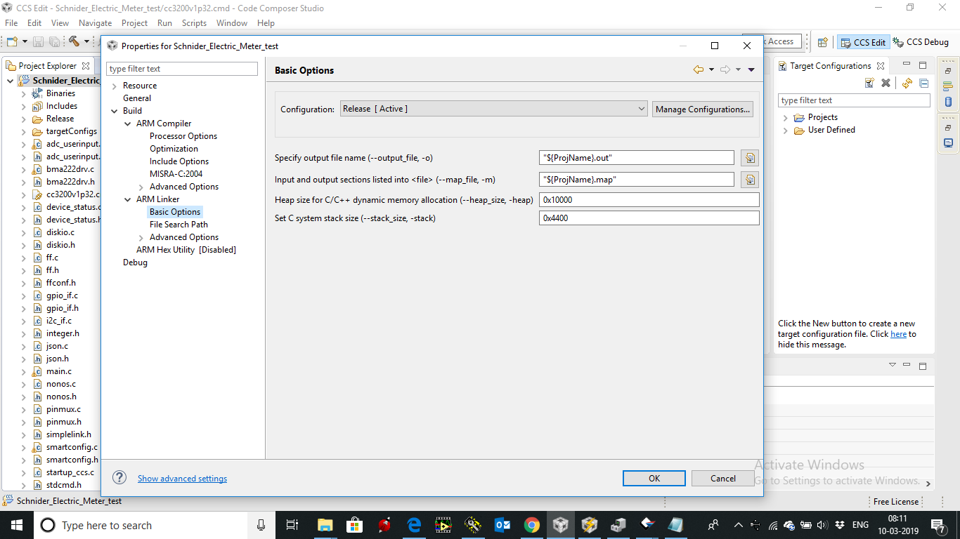

    I am using the freeRTOS. I have increased the stack size and adjusted the size of DATA RAM and CODE RAM.
    Please look into this. I am attaching the files below. Is this fine for my application?

  • I can't help you with the stack size since it depends on your application.
    Try to increase it by a lot to make sure it is not related to the stuck.
    the linker command setting seems ok.
    To further optimize the RAM usage, you should be able to use only one SRAM section (instead of the separated SRAM_DATA and SRAM_CODE):
    SRAM (RWX) : origin = 0x20004000, length = 0x3C000
    Br,
    Kobi
    How can I get to know, how much I need the stack size according to my application?
  • use a large number (e.g. 0x11000). If it works, try a smaller one.
