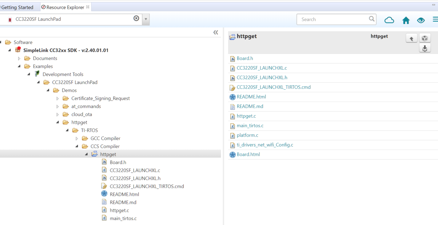

    Do you mean following project for HTTP get example?
    And, is there a sample so that PC and CC 3220 communicate with 1:1 directly via wifi?
    BestRegards
    Yes. You can modify http get to send whatever request you want to send to whatever server application you have running on your computer or you can run the device as http server and have you computer connect to it.
    If you want you can also just setup two socket applications (one on CC3220 and other on PC) to connect to each other communicate like that.
    EDIT: Our network_terminal example allows you to setup a socket easily via terminal.
