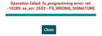

CC3220SF-LAUNCHXL: WRONG SIGNATURE when uniflashing with real code signing certificate
Part Number: CC3220SF-LAUNCHXL
Hi guys,
I got hands on a real code signing certificate from Thawte.
Sadly Uniflash keeps giving me:

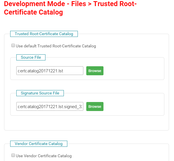

I followed instructions as in document SWPU332. My file list is as follows:
I set the standard certificate catalog (NOT the playground).
Are there any obvious mistakes?
Could you give direct support on this, by mail or other means?
I could share files to let you do some tests.
Thanks for your time,
Francesco
  • Hi Francesco,
    Are you sure you're using the private key for the certificate you trying to sign your code with? I can re-create your exact error when I purposely put the wrong private key in Uniflash.
    Jesu
