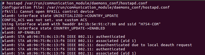

Hello everybody,
I'm trying to create custom Wi-Fi access point on my device, based on AM3358 and WL1807 chips. On the face of it, everything is fine: I use hostapd v2.6-devel-R8.7_SP3, fetched  from TI repo, and my phone successfully connects to it.
But when I'm trying to connect with another phone, following issue appears:
As I understand, the phone disconnects by itself for unknown reason, but at the same time, other phone connects normally. I've though, that this issue can be caused by low entropy for /dev/random, it jittered from 700 to 800. Therefore standard linux rng has been changed on TRNG Hardware Accelerator: it works fine, now entropy reaches 3000 and rngtest passes with minimal errors (0-1 failures from 1000 cases). But it doesn't help, the same issue still appears.
I have now idea, what causes this behavior for distinct devices, while other devices normally works with my AP.
Can anybody help me to solve this problem? I also attach my hostapd.conf and verbose log from hostapd.

nl80211: Event message available
nl80211: BSS Event 59 (NL80211_CMD_FRAME) received for wlan0
nl80211: MLME event 59 (NL80211_CMD_FRAME) on wlan0(84:1b:5e:91:c7:06) A1=84:1b:5e:91:c7:06 A2=a8:96:75:0c:13:f6
nl80211: MLME event frame - hexdump(len=30): b0 00 3a 01 84 1b 5e 91 c7 06 a8 96 75 0c 13 f6 84 1b 5e 91 c7 06 d0 f8 00 00 01 00 00 00
nl80211: Frame event
nl80211: RX frame da=84:1b:5e:91:c7:06 sa=a8:96:75:0c:13:f6 bssid=84:1b:5e:91:c7:06 freq=2417 ssi_signal=-48 fc=0xb0 seq_ctrl=0xf8d0 stype=11 (WLAN_FC_STYPE_AUTH) len=30
wlan0: Event RX_MGMT (19) received
mgmt::auth
authentication: STA=a8:96:75:0c:13:f6 auth_alg=0 auth_transaction=1 status_code=0 wep=0 seq_ctrl=0xf8d0
  New STA
ap_sta_add: register ap_handle_timer timeout for a8:96:75:0c:13:f6 (300 seconds - ap_max_inactivity)
nl80211: sta_remove -> DEL_STATION wlan0 a8:96:75:0c:13:f6 --> -2 (No such file or directory)
nl80211: Add STA a8:96:75:0c:13:f6
  * supported rates - hexdump(len=0): [NULL]
  * capability=0x0
  * aid=1 (UNASSOC_STA workaround)
  * listen_interval=0
  * flags set=0x0 mask=0xa0
wlan0: STA a8:96:75:0c:13:f6 IEEE 802.11: authentication OK (open system)
wlan0: STA a8:96:75:0c:13:f6 MLME: MLME-AUTHENTICATE.indication(a8:96:75:0c:13:f6, OPEN_SYSTEM)
wlan0: STA a8:96:75:0c:13:f6 MLME: MLME-DELETEKEYS.request(a8:96:75:0c:13:f6)
authentication reply: STA=a8:96:75:0c:13:f6 auth_alg=0 auth_transaction=2 resp=0 (IE len=0)
nl80211: send_mlme - da= a8:96:75:0c:13:f6 noack=0 freq=0 no_cck=0 offchanok=0 wait_time=0 fc=0xb0 (WLAN_FC_STYPE_AUTH) nlmode=3
nl80211: send_mlme -> send_frame
nl80211: send_frame - Use bss->freq=2417
nl80211: send_frame -> send_frame_cmd
nl80211: CMD_FRAME freq=2417 wait=0 no_cck=0 no_ack=0 offchanok=0
CMD_FRAME - hexdump(len=30): b0 00 00 00 a8 96 75 0c 13 f6 84 1b 5e 91 c7 06 84 1b 5e 91 c7 06 00 00 00 00 02 00 00 00
nl80211: Frame TX command accepted; cookie 0x4c
nl80211: Drv Event 19 (NL80211_CMD_NEW_STATION) received for wlan0
nl80211: New station a8:96:75:0c:13:f6
nl80211: Drv Event 60 (NL80211_CMD_FRAME_TX_STATUS) received for wlan0
nl80211: MLME event 60 (NL80211_CMD_FRAME_TX_STATUS) on wlan0(84:1b:5e:91:c7:06) A1=a8:96:75:0c:13:f6 A2=84:1b:5e:91:c7:06
nl80211: MLME event frame - hexdump(len=30): b0 00 00 00 a8 96 75 0c 13 f6 84 1b 5e 91 c7 06 84 1b 5e 91 c7 06 00 00 00 00 02 00 00 00
nl80211: Frame TX status event
wlan0: Event TX_STATUS (17) received
mgmt::auth cb
wlan0: STA a8:96:75:0c:13:f6 IEEE 802.11: authenticated
nl80211: Set STA flags - ifname=wlan0 addr=a8:96:75:0c:13:f6 total_flags=0x20 flags_or=0x0 flags_and=0xfffffff1 authorized=0
nl80211: MLME event frame - hexdump(len=113): 00 00 3a 01 84 1b 5e 91 c7 06 a8 96 75 0c 13 f6 84 1b 5e 91 c7 06 e0 f8 11 04 01 00 00 08 48 37 35 34 2d 43 4f 4d 01 08 82 84 8b 96 0c 12 18 24 32 04 30 48 60 6c 30 14 01 00 00 0f ac 04 01 00 00 0f ac 04 01 00 00 0f ac 02 0c 00 2d 1a 2c 01 03 ff 00 00 00 00 00 00 00 00 00 00 00 00 00 00 00 00 00 00 00 00 00 00 dd 07 00 50 f2 02 00 01 00
nl80211: RX frame da=84:1b:5e:91:c7:06 sa=a8:96:75:0c:13:f6 bssid=84:1b:5e:91:c7:06 freq=2417 ssi_signal=-48 fc=0x0 seq_ctrl=0xf8e0 stype=0 (WLAN_FC_STYPE_ASSOC_REQ) len=113
mgmt::assoc_req
association request: STA=a8:96:75:0c:13:f6 capab_info=0x411 listen_interval=1 seq_ctrl=0xf8e0
WMM IE - hexdump(len=7): 00 50 f2 02 00 01 00
Validating WMM IE: OUI 00:50:f2  OUI type 2  OUI sub-type 0  version 1  QoS info 0x0
  new AID 1
nl80211: Set beacon (beacon_set=1)
nl80211: Beacon head - hexdump(len=59): 80 00 00 00 ff ff ff ff ff ff 84 1b 5e 91 c7 06 84 1b 5e 91 c7 06 00 00 00 00 00 00 00 00 00 00 64 00 11 04 00 08 48 37 35 34 2d 43 4f 4d 01 08 82 84 8b 96 0c 12 18 24 03 01 02
nl80211: Beacon tail - hexdump(len=131): 07 06 52 55 20 01 0d 14 2a 01 04 32 04 30 48 60 6c 30 14 01 00 00 0f ac 04 01 00 00 0f ac 04 01 00 00 0f ac 02 0c 00 3b 02 51 00 2d 1a 0c 00 1d ff 00 00 00 00 00 00 00 00 00 96 00 01 00 00 00 00 00 00 00 00 00 00 3d 16 02 00 00 00 00 00 00 00 00 00 00 00 00 00 00 00 00 00 00 00 00 00 7f 08 04 00 00 00 00 00 00 40 dd 18 00 50 f2 02 01 01 00 00 03 a4 00 00 27 a4 00 00 42 43 5e 00 62 32 2f 00
nl80211: ifindex=9
nl80211: beacon_int=100
nl80211: dtim_period=2
nl80211: ssid - hexdump_ascii(len=8):
     48 37 35 34 2d 43 4f 4d                           H754-COM
  * beacon_int=100
nl80211: proberesp (offload) - hexdump(len=190): 50 00 00 00 00 00 00 00 00 00 84 1b 5e 91 c7 06 84 1b 5e 91 c7 06 00 00 00 00 00 00 00 00 00 00 64 00 11 04 00 08 48 37 35 34 2d 43 4f 4d 01 08 82 84 8b 96 0c 12 18 24 03 01 02 07 06 52 55 20 01 0d 14 2a 01 04 32 04 30 48 60 6c 30 14 01 00 00 0f ac 04 01 00 00 0f ac 04 01 00 00 0f ac 02 0c 00 3b 02 51 00 2d 1a 0c 00 1d ff 00 00 00 00 00 00 00 00 00 96 00 01 00 00 00 00 00 00 00 00 00 00 3d 16 02 00 00 00 00 00 00 00 00 00 00 00 00 00 00 00 00 00 00 00 00 00 7f 08 04 00 00 00 00 00 00 40 dd 18 00 50 f2 02 01 01 00 00 03 a4 00 00 27 a4 00 00 42 43 5e 00 62 32 2f 00
nl80211: hidden SSID not in use
nl80211: privacy=1
nl80211: auth_algs=0x1
nl80211: wpa_version=0x2
nl80211: key_mgmt_suites=0x2
nl80211: pairwise_ciphers=0x10
nl80211: group_cipher=0x10
nl80211: SMPS mode - off
nl80211: beacon_ies - hexdump(len=10): 7f 08 04 00 00 00 00 00 00 40
nl80211: proberesp_ies - hexdump(len=10): 7f 08 04 00 00 00 00 00 00 40
nl80211: assocresp_ies - hexdump(len=10): 7f 08 04 00 00 00 00 00 00 40
HT: STA a8:96:75:0c:13:f6 HT Capabilities Info: 0x012c
update_sta_ht STA a8:96:75:0c:13:f6 - no greenfield, num of non-gf stations 1
update_sta_ht STA a8:96:75:0c:13:f6 - 20 MHz HT, num of 20MHz HT STAs 1
hostapd_ht_operation_update current operation mode=0x0
hostapd_ht_operation_update new operation mode=0x4 changes=1
nl80211: Beacon tail - hexdump(len=131): 07 06 52 55 20 01 0d 14 2a 01 04 32 04 30 48 60 6c 30 14 01 00 00 0f ac 04 01 00 00 0f ac 04 01 00 00 0f ac 02 0c 00 3b 02 51 00 2d 1a 0c 00 1d ff 00 00 00 00 00 00 00 00 00 96 00 01 00 00 00 00 00 00 00 00 00 00 3d 16 02 00 04 00 00 00 00 00 00 00 00 00 00 00 00 00 00 00 00 00 00 00 7f 08 04 00 00 00 00 00 00 40 dd 18 00 50 f2 02 01 01 00 00 03 a4 00 00 27 a4 00 00 42 43 5e 00 62 32 2f 00
nl80211: ifindex=9
  * beacon_int=100
nl80211: proberesp (offload) - hexdump(len=190): 50 00 00 00 00 00 00 00 00 00 84 1b 5e 91 c7 06 84 1b 5e 91 c7 06 00 00 00 00 00 00 00 00 00 00 64 00 11 04 00 08 48 37 35 34 2d 43 4f 4d 01 08 82 84 8b 96 0c 12 18 24 03 01 02 07 06 52 55 20 01 0d 14 2a 01 04 32 04 30 48 60 6c 30 14 01 00 00 0f ac 04 01 00 00 0f ac 04 01 00 00 0f ac 02 0c 00 3b 02 51 00 2d 1a 0c 00 1d ff 00 00 00 00 00 00 00 00 00 96 00 01 00 00 00 00 00 00 00 00 00 00 3d 16 02 00 04 00 00 00 00 00 00 00 00 00 00 00 00 00 00 00 00 00 00 00 7f 08 04 00 00 00 00 00 00 40 dd 18 00 50 f2 02 01 01 00 00 03 a4 00 00 27 a4 00 00 42 43 5e 00 62 32 2f 00
nl80211: privacy=1
wlan0: STA a8:96:75:0c:13:f6 IEEE 802.11: association OK (aid 1)
nl80211: Set STA a8:96:75:0c:13:f6
  * supported rates - hexdump(len=12): 82 84 8b 96 0c 12 18 24 30 48 60 6c
  * capability=0x411
  * ht_capabilities - hexdump(len=26): 0c 00 03 ff 00 00 00 00 00 00 00 00 00 00 00 00 00 00 00 00 00 00 00 00 00 00
  * aid=1
  * listen_interval=1
  * flags set=0xa8 mask=0xa8
  * qosinfo=0x0
nl80211: send_mlme - da= a8:96:75:0c:13:f6 noack=0 freq=0 no_cck=0 offchanok=0 wait_time=0 fc=0x10 (WLAN_FC_STYPE_ASSOC_RESP) nlmode=3
CMD_FRAME - hexdump(len=134): 10 00 00 00 a8 96 75 0c 13 f6 84 1b 5e 91 c7 06 84 1b 5e 91 c7 06 00 00 11 04 00 00 01 c0 01 08 82 84 8b 96 0c 12 18 24 32 04 30 48 60 6c 2d 1a 0c 00 1d ff 00 00 00 00 00 00 00 00 00 96 00 01 00 00 00 00 00 00 00 00 00 00 3d 16 02 00 04 00 00 00 00 00 00 00 00 00 00 00 00 00 00 00 00 00 00 00 7f 08 04 00 00 00 00 00 00 40 dd 18 00 50 f2 02 01 01 00 00 03 a4 00 00 27 a4 00 00 42 43 5e 00 62 32 2f 00
nl80211: Frame TX command accepted; cookie 0x4d
nl80211: MLME event frame - hexdump(len=134): 10 00 00 00 a8 96 75 0c 13 f6 84 1b 5e 91 c7 06 84 1b 5e 91 c7 06 00 00 11 04 00 00 01 c0 01 08 82 84 8b 96 0c 12 18 24 32 04 30 48 60 6c 2d 1a 0c 00 1d ff 00 00 00 00 00 00 00 00 00 96 00 01 00 00 00 00 00 00 00 00 00 00 3d 16 02 00 04 00 00 00 00 00 00 00 00 00 00 00 00 00 00 00 00 00 00 00 7f 08 04 00 00 00 00 00 00 40 dd 18 00 50 f2 02 01 01 00 00 03 a4 00 00 27 a4 00 00 42 43 5e 00 62 32 2f 00
mgmt::assoc_resp cb
wlan0: STA a8:96:75:0c:13:f6 IEEE 802.11: associated (aid 1)
wlan0: STA a8:96:75:0c:13:f6 MLME: MLME-ASSOCIATE.indication(a8:96:75:0c:13:f6)
wpa_driver_nl80211_set_key: ifindex=9 (wlan0) alg=0 addr=0xbe960 key_idx=0 set_tx=1 seq_len=0 key_len=0
wlan0: STA a8:96:75:0c:13:f6 IEEE 802.11: binding station to interface 'wlan0'
nl80211: wlan0[9]: set_sta_vlan(a8:96:75:0c:13:f6, ifname=wlan0[9], vlan_id=0)
nl80211: Set STA flags - ifname=wlan0 addr=a8:96:75:0c:13:f6 total_flags=0x62 flags_or=0x2 flags_and=0xfffffff3 authorized=0
wlan0: STA a8:96:75:0c:13:f6 WPA: event 1 notification
IEEE 802.1X: Ignore STA - 802.1X not enabled or forced for WPS
wlan0: STA a8:96:75:0c:13:f6 WPA: start authentication
WPA: a8:96:75:0c:13:f6 WPA_PTK entering state INITIALIZE
nl80211: Set STA flags - ifname=wlan0 addr=a8:96:75:0c:13:f6 total_flags=0x62 flags_or=0x0 flags_and=0xfffffffe authorized=0
wlan0: STA a8:96:75:0c:13:f6 IEEE 802.1X: unauthorizing port
WPA: a8:96:75:0c:13:f6 WPA_PTK_GROUP entering state IDLE
WPA: a8:96:75:0c:13:f6 WPA_PTK entering state AUTHENTICATION
WPA: a8:96:75:0c:13:f6 WPA_PTK entering state AUTHENTICATION2
WPA: Re-initialize GMK/Counter on first station
Get randomness: len=32 entropy=2
GMK - hexdump(len=32): [REMOVED]
Get randomness: len=32 entropy=0
Key Counter - hexdump(len=32): [REMOVED]
Get randomness: len=16 entropy=0
GTK - hexdump(len=16): [REMOVED]
wpa_driver_nl80211_set_key: ifindex=9 (wlan0) alg=3 addr=0x7bb4b key_idx=1 set_tx=1 seq_len=0 key_len=16
nl80211: KEY_DATA - hexdump(len=16): [REMOVED]
   broadcast key
WPA: Assign ANonce - hexdump(len=32): 63 8e 5b e9 fe 5c e7 f5 a4 28 13 13 91 49 7a 99 8b 4c e6 28 44 0c de 8f 8c 2f 55 ec 99 07 7a 27
WPA: a8:96:75:0c:13:f6 WPA_PTK entering state INITPSK
Searching a PSK for a8:96:75:0c:13:f6 prev_psk=(nil)
WPA: a8:96:75:0c:13:f6 WPA_PTK entering state PTKSTART
wlan0: STA a8:96:75:0c:13:f6 WPA: sending 1/4 msg of 4-Way Handshake
WPA: Send EAPOL(version=2 secure=0 mic=0 ack=1 install=0 pairwise=1 kde_len=0 keyidx=0 encr=0)
WPA: Replay Counter - hexdump(len=8): 00 00 00 00 00 00 00 01
WPA: Use EAPOL-Key timeout of 100 ms (retry counter 1)
wlan0: hostapd_new_assoc_sta: reschedule ap_handle_timer timeout for a8:96:75:0c:13:f6 (300 seconds - ap_max_inactivity)
nl80211: Drv Event 64 (NL80211_CMD_NOTIFY_CQM) received for wlan0
wlan0: Event STATION_LOW_ACK (33) received
wlan0: Event EAPOL_TX_STATUS (38) received
IEEE 802.1X: a8:96:75:0c:13:f6 TX status - version=2 type=3 length=95 - ack=0
WPA: EAPOL-Key TX status for STA a8:96:75:0c:13:f6 ack=0
wlan0: STA a8:96:75:0c:13:f6 IEEE 802.1X: did not Ack EAPOL-Key frame (broadcast index=122)
wlan0: STA a8:96:75:0c:13:f6 WPA: EAPOL-Key timeout
WPA: Replay Counter - hexdump(len=8): 00 00 00 00 00 00 00 02
WPA: Use EAPOL-Key timeout of 1000 ms (retry counter 2)
WPA: Replay Counter - hexdump(len=8): 00 00 00 00 00 00 00 03
WPA: Use EAPOL-Key timeout of 1000 ms (retry counter 3)
WPA: Replay Counter - hexdump(len=8): 00 00 00 00 00 00 00 04
WPA: Use EAPOL-Key timeout of 1000 ms (retry counter 4)
wlan0: STA a8:96:75:0c:13:f6 WPA: PTKSTART: Retry limit 4 reached
WPA: a8:96:75:0c:13:f6 WPA_PTK entering state DISCONNECT
wpa_sta_disconnect STA a8:96:75:0c:13:f6
hostapd_wpa_auth_disconnect: WPA authenticator requests disconnect: STA a8:96:75:0c:13:f6 reason 2
wlan0: ap_sta_disconnect addr a8:96:75:0c:13:f6 reason=2
nl80211: send_mlme - da= a8:96:75:0c:13:f6 noack=0 freq=0 no_cck=0 offchanok=0 wait_time=0 fc=0xc0 (WLAN_FC_STYPE_DEAUTH) nlmode=3
CMD_FRAME - hexdump(len=26): c0 00 00 00 a8 96 75 0c 13 f6 84 1b 5e 91 c7 06 84 1b 5e 91 c7 06 00 00 02 00
nl80211: Frame TX command accepted; cookie 0x4e
wlan0: STA a8:96:75:0c:13:f6 WPA: event 3 notification
wlan0: ap_sta_disconnect: reschedule ap_handle_timer timeout for a8:96:75:0c:13:f6 (5 seconds - AP_MAX_INACTIVITY_AFTER_DEAUTH)
WPA: a8:96:75:0c:13:f6 WPA_PTK entering state DISCONNECTED
nl80211: Set STA flags - ifname=wlan0 addr=a8:96:75:0c:13:f6 total_flags=0x2 flags_or=0x0 flags_and=0xfffffffe authorized=0
nl80211: MLME event frame - hexdump(len=26): c0 00 00 00 a8 96 75 0c 13 f6 84 1b 5e 91 c7 06 84 1b 5e 91 c7 06 00 00 02 00
mgmt::deauth cb
STA a8:96:75:0c:13:f6 did not acknowledge deauth
wlan0: Deauthentication callback for STA a8:96:75:0c:13:f6
wlan0: Removing STA a8:96:75:0c:13:f6 from kernel driver
nl80211: sta_remove -> DEL_STATION wlan0 a8:96:75:0c:13:f6 --> 0 (Success)
wlan0: STA a8:96:75:0c:13:f6 MLME: MLME-DEAUTHENTICATE.indication(a8:96:75:0c:13:f6, 2)
nl80211: Drv Event 20 (NL80211_CMD_DEL_STATION) received for wlan0
nl80211: Delete station a8:96:75:0c:13:f6
wlan0: ap_handle_timer: a8:96:75:0c:13:f6 flags=0xa00 timeout_next=3
wlan0: STA a8:96:75:0c:13:f6 IEEE 802.11: deauthenticated due to local deauth request
hostapd_ht_operation_update current operation mode=0x4
hostapd_ht_operation_update new operation mode=0x0 changes=1
nl80211: ifindex=9
  * beacon_int=100
nl80211: privacy=1
ap_free_sta: cancel ap_handle_timer for a8:96:75:0c:13:f6
nl80211: MLME event frame - hexdump(len=26): c0 00 3a 01 84 1b 5e 91 c7 06 a8 96 75 0c 13 f6 84 1b 5e 91 c7 06 00 f9 03 00
nl80211: RX frame da=84:1b:5e:91:c7:06 sa=a8:96:75:0c:13:f6 bssid=84:1b:5e:91:c7:06 freq=2417 ssi_signal=-45 fc=0xc0 seq_ctrl=0xf900 stype=12 (WLAN_FC_STYPE_DEAUTH) len=26
wlan0: mgmt::deauth
wlan0: deauthentication: STA=a8:96:75:0c:13:f6 reason_code=3
wlan0: Station a8:96:75:0c:13:f6 trying to deauthenticate, but it is not authenticated
nl80211: MLME event frame - hexdump(len=30): b0 00 3a 01 84 1b 5e 91 c7 06 a8 96 75 0c 13 f6 84 1b 5e 91 c7 06 e0 02 00 00 01 00 00 00
nl80211: RX frame da=84:1b:5e:91:c7:06 sa=a8:96:75:0c:13:f6 bssid=84:1b:5e:91:c7:06 freq=2417 ssi_signal=-47 fc=0xb0 seq_ctrl=0x2e0 stype=11 (WLAN_FC_STYPE_AUTH) len=30
mgmt::auth
authentication: STA=a8:96:75:0c:13:f6 auth_alg=0 auth_transaction=1 status_code=0 wep=0 seq_ctrl=0x2e0
  New STA
  * capability=0x0
  * listen_interval=0
nl80211: Frame TX command accepted; cookie 0x4f
mgmt::auth cb
nl80211: MLME event frame - hexdump(len=113): 00 00 3a 01 84 1b 5e 91 c7 06 a8 96 75 0c 13 f6 84 1b 5e 91 c7 06 f0 02 11 04 01 00 00 08 48 37 35 34 2d 43 4f 4d 01 08 82 84 8b 96 0c 12 18 24 32 04 30 48 60 6c 30 14 01 00 00 0f ac 04 01 00 00 0f ac 04 01 00 00 0f ac 02 0c 00 2d 1a 2c 01 03 ff 00 00 00 00 00 00 00 00 00 00 00 00 00 00 00 00 00 00 00 00 00 00 dd 07 00 50 f2 02 00 01 00
nl80211: RX frame da=84:1b:5e:91:c7:06 sa=a8:96:75:0c:13:f6 bssid=84:1b:5e:91:c7:06 freq=2417 ssi_signal=-47 fc=0x0 seq_ctrl=0x2f0 stype=0 (WLAN_FC_STYPE_ASSOC_REQ) len=113
mgmt::assoc_req
association request: STA=a8:96:75:0c:13:f6 capab_info=0x411 listen_interval=1 seq_ctrl=0x2f0
  new AID 1
nl80211: ifindex=9
  * beacon_int=100
nl80211: privacy=1
nl80211: ifindex=9
  * beacon_int=100
nl80211: privacy=1
  * capability=0x411
  * aid=1
  * listen_interval=1
  * qosinfo=0x0
nl80211: Frame TX command accepted; cookie 0x50
mgmt::assoc_resp cb
Get randomness: len=32 entropy=3
WPA: Assign ANonce - hexdump(len=32): 35 c1 0b ed 10 2b fb fd 09 4b 4b 6e 09 ea 3e be d5 00 2e 87 72 64 16 23 0b 88 5e 2a 8b 4f b4 fc
wlan0: STA a8:96:75:0c:13:f6 IEEE 802.1X: did not Ack EAPOL-Key frame (broadcast index=62)
nl80211: Frame TX command accepted; cookie 0x51
mgmt::deauth cb
