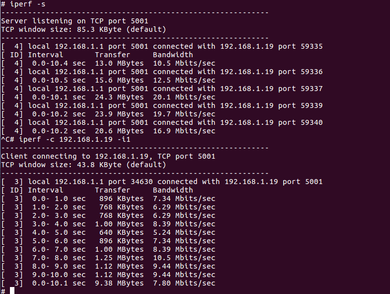

Hello everybody,
I've faced with Wi-Fi connection speed issue on my custom board, based on AM3358 and WL1807MOD chips.
My device is configured as AP in 802.11n generation mode via hostapd. All works fine, but connection speed, measured by iperf is too low. Uplink and downlink for 5GHz configuration do not exceed 3.25 Mbit/s and 13.6 Mbit/s respectively.

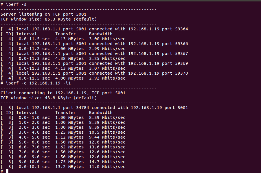

Moreover measurements for 2.4GHz configuration is higher than measurements for 5GHz band:
In managed mode the same speed test shows results compatible with 2.4GHz configuration.
TCP window size adjustment doesn't produce visible changes.
This speed is too low for my purposes. What can causes this speed drop?

    Are you testing it it in a shielded room? How congested is your environment?
    Are you getting the same numbers using all channels?
    Can you try also iperf UDP instead of TCP? Does it give you better numbers?
    Your numbers for both 2.4Ghz as well as 5Ghz are definitely lower than what you should see.

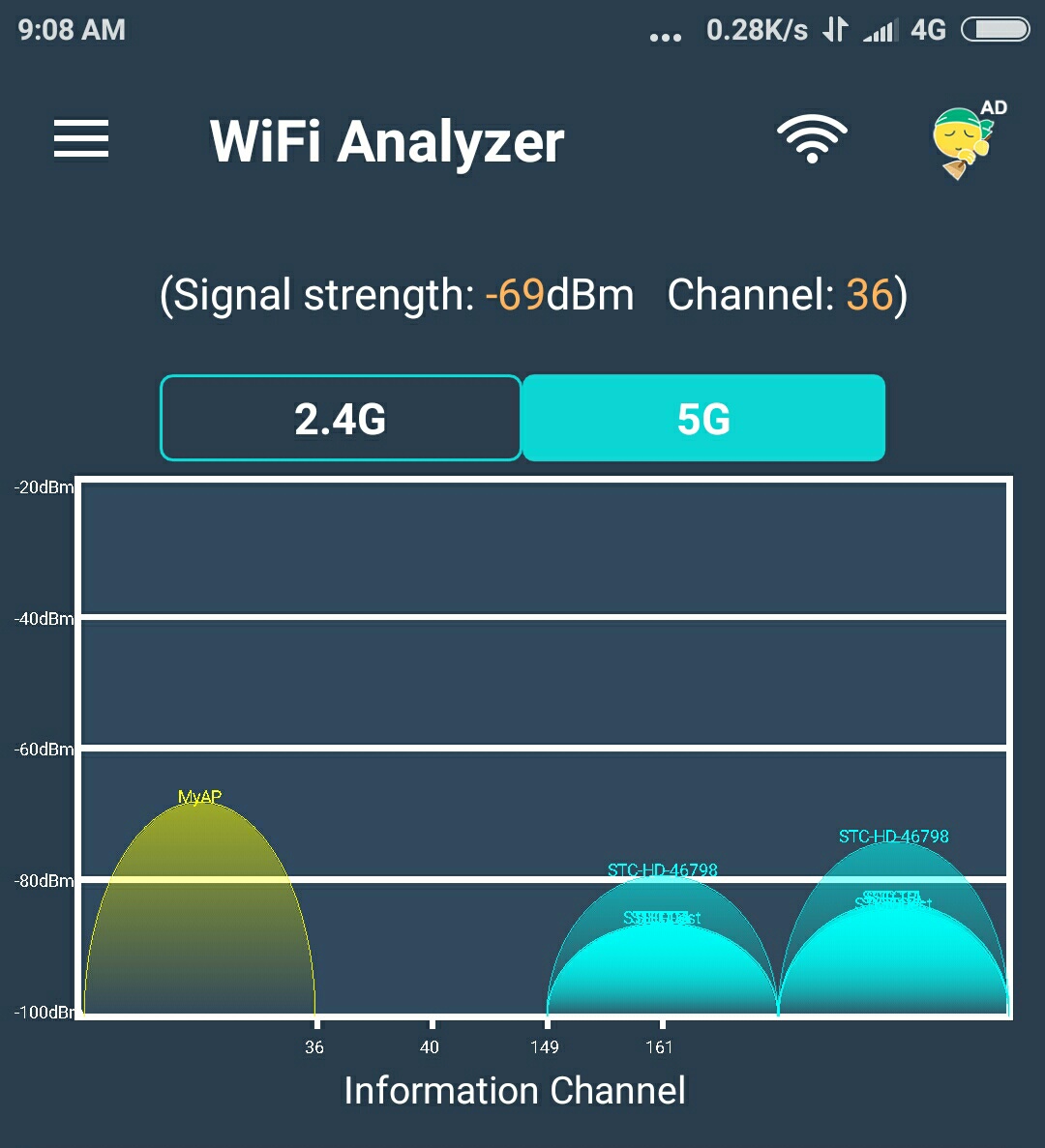

  • Hello Eyal,
    My testing room is an ordinary office space with desktop workstations and local WLAN routers.
    It's all the same result with other channels for both bands.

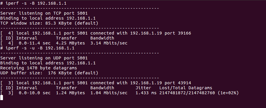

    With UDP both of uplink and downlink decrease:
    This is result acquired via Android Wi-Fi analyzer during iperf working time (detected channel matches with selected AP configured on the device):
    I'm also attaching a dump of wl18xx_conf.bin

    The phone wifi analyzer App is not a good enough tool to see what is happening.
    If you use a real wifi sniffer (like wire shark) and capture the wifi traffic on the air you would probably see that the packets are transmitted on lower rates due to congestion/packet loss in the air.
    BR,
