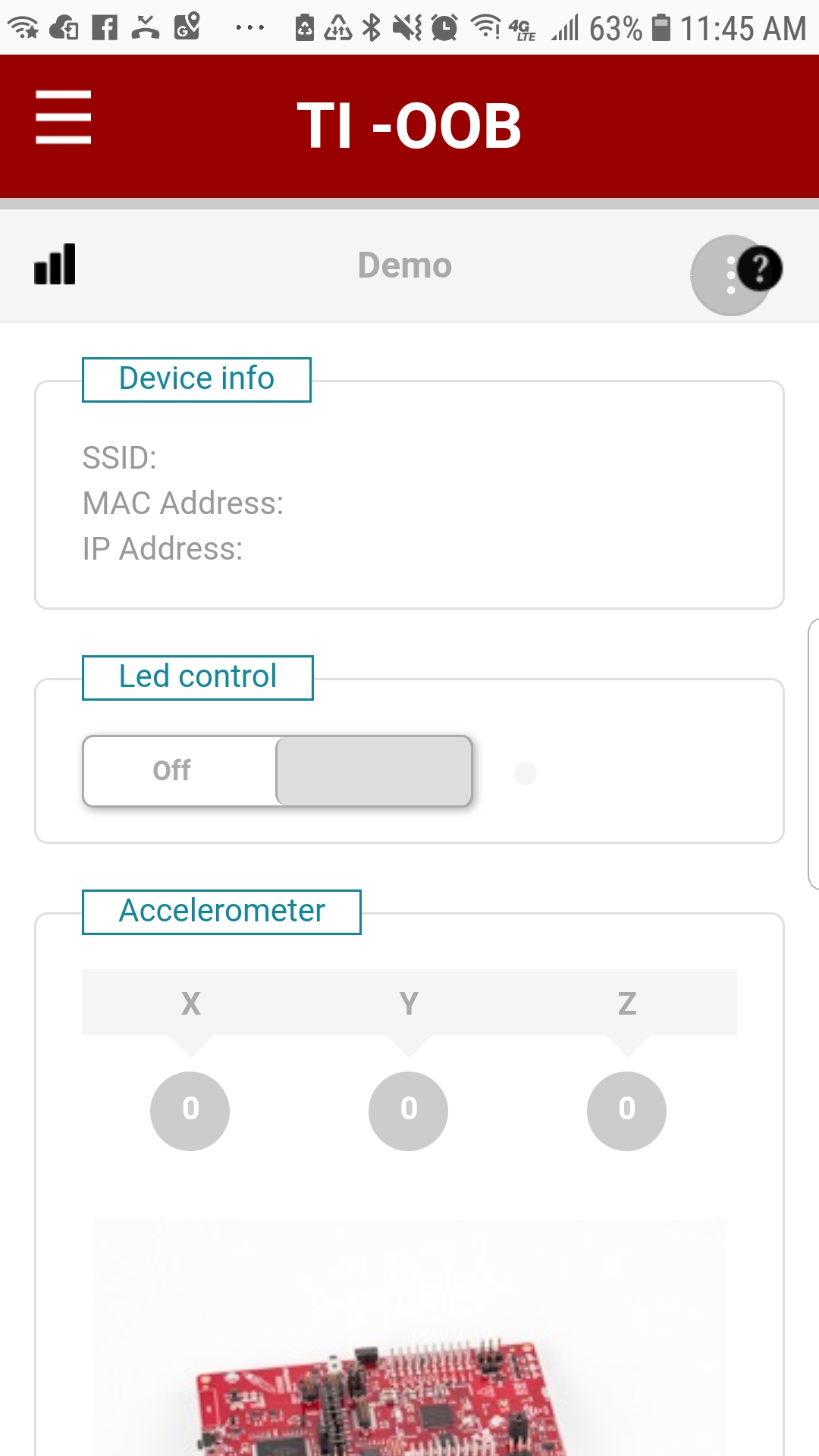

I too am having trouble getting my Galaxy 7 phone to connect to a CC3320MOD launch pad with the OOB.
I have loaded the SimpleLink Start Pro.

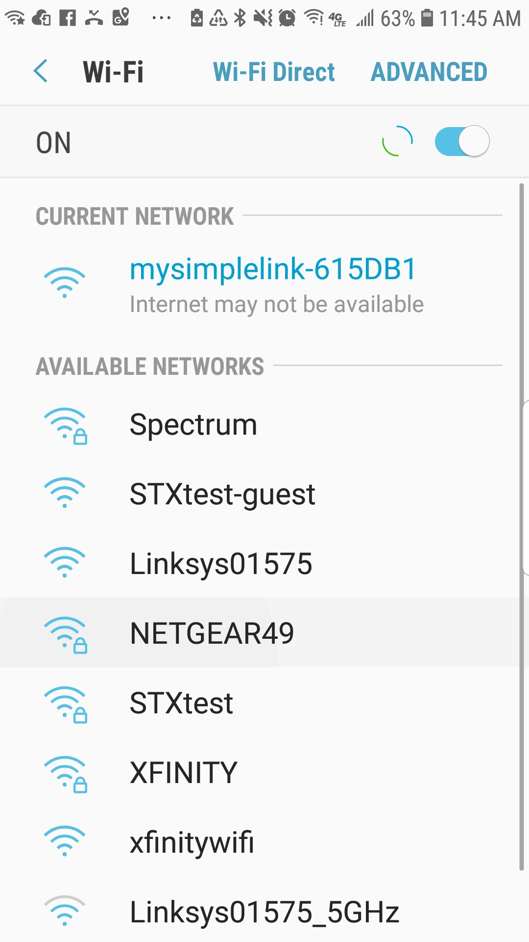

I have applied power to the Launchpad and connected a terminal to the debug port. See the debug terminal report below.
I have gone to my WiFi set up and selected the mysimplelink-615DB1 network
I opened a browser on my phone and typed in http://mysiimplelink.net
This got me to the demo web server but the LED on the Launchpad  and the accelerometer did not work.   I will try to load screen shots.

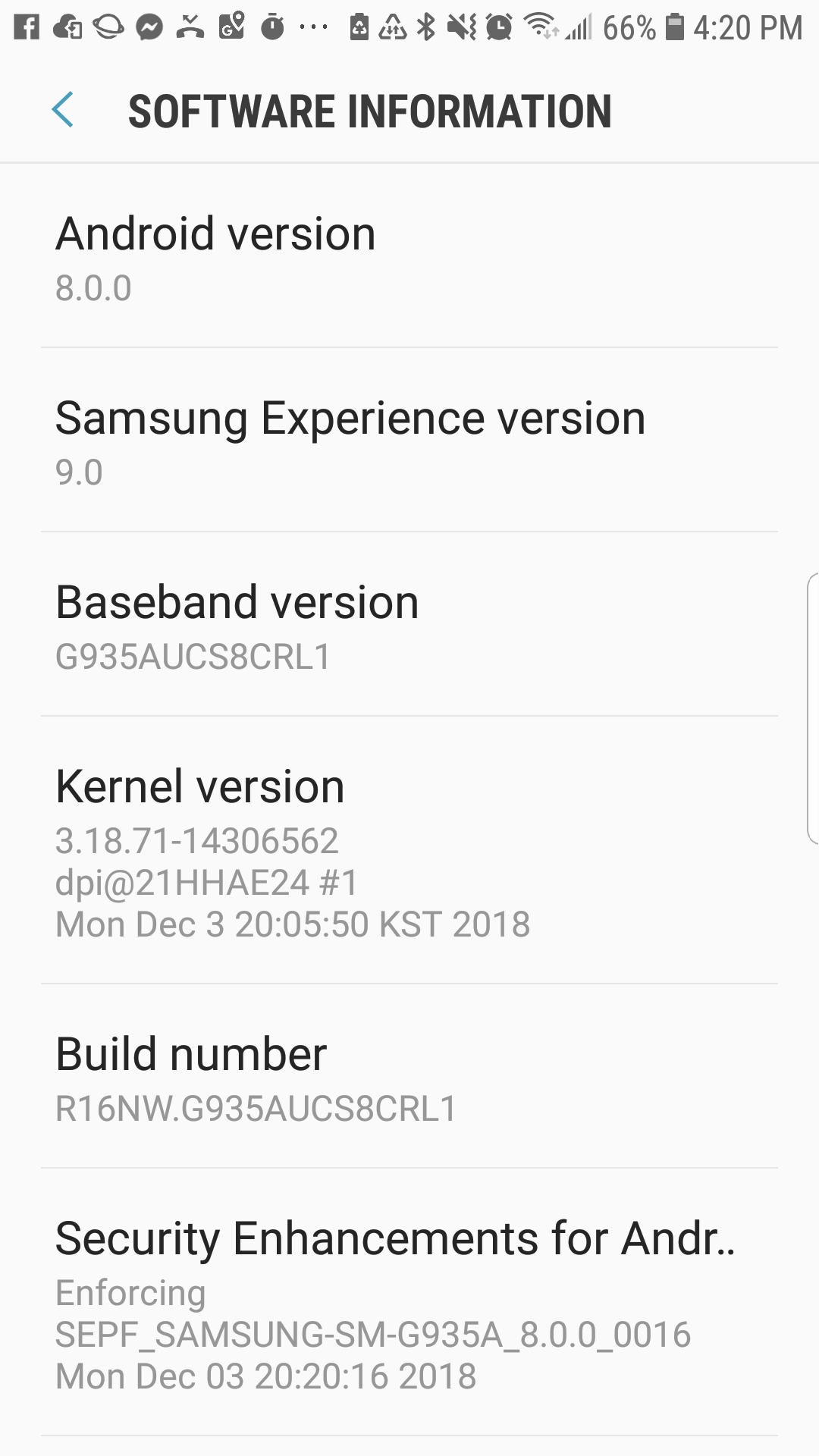

I first experenced this probelm last summer and a co worker with an older ?galaxy 5? was able to connect just fine and change the LED and get the accelerometer. Since I am primarily the hardware design guy I had to set this aside and am now just getting back to it.  I see others asking this same question on the forum.
FYI, I have read SWRU473 August 2018 version and it does not help me find the problem.  There are parts I simply cannot follow and it still needs review by someone who is able to write a much more detailed explanation.
Is there a better write up for working with the OOB and overcoming install problems?
Is there a known problem with Galaxy 7?  Is there some security setting in my Galaxy 7 I may need to change?

Debug terminal report:
[NETAPP EVENT] IP Acquired: IP=10.123.45.1 , Gateway=10.123.45.1
              out of box Example Ver: 1.00.00.09
            CHIP: 0x31000019
            MAC:  2.0.0.0
            PHY:  2.2.0.4
            NWP:  3.3.0.0
            ROM:  0
            HOST: 2.0.1.15
            MAC address: 50:f1:4a:61:5d:b1
[Provisioning task] Wake up on Power ON
[Provisioning task] detected device is CC3220SF
[Provisioning task] Device started as STATION
[Provisioning task] Cannot connect to AP or profile does not exist
[Provisioning task] Device is configured in default state
[Provisioning task] Device started in AP role
[Provisioning task] Host Driver Version: 2.0.1.15
[Provisioning task] Build Version 3.3.0.0.31.2.0.0.0.2.2.0.4
[Provisioning task] Starting Provisioning - [Provisioning task] in mode 2 (0 = A
P, 1 = SC, 2 = AP+SC)
[Provisioning task] Provisioning Started. Waiting to be provisioned..!!
