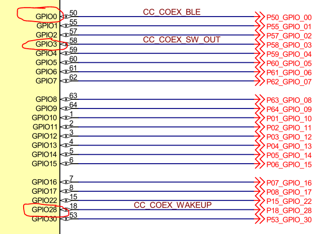

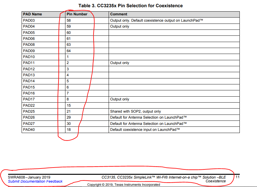

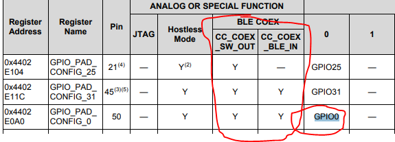

Hi e2e,
Our customer is using CC3235SF + BLE doing coexistence application, in CC3235SF datasheet and LP schematic, GPIO0 is used for coexistence, but in an application note, it doesn't mention the GPIO0 as coexistence function pin, what's the reason there?
and what's the different between CC_COEX_BLE and CC_COEX_WAKEUP in Launchpad design?
thanks in advance.
