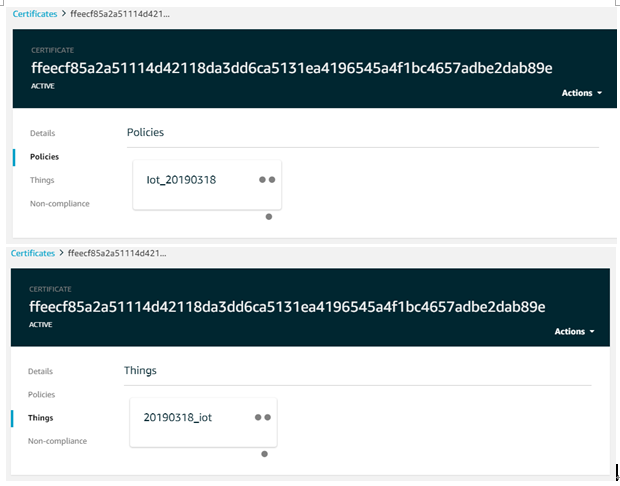

After creation "thing" , I get the client_cert_pem and the client_private_key_pem from AWS-iot .
I am sure the cretificate is active.

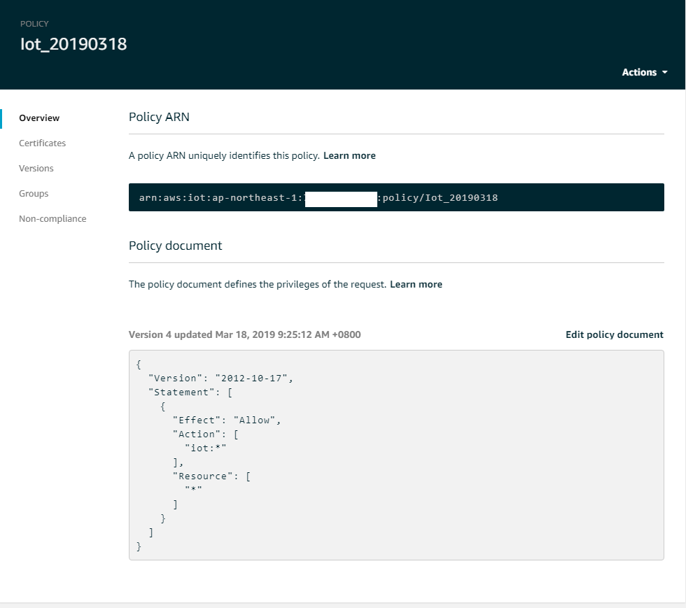

The policy  as below

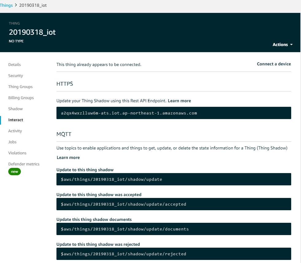

The "thing" picture  just as below:

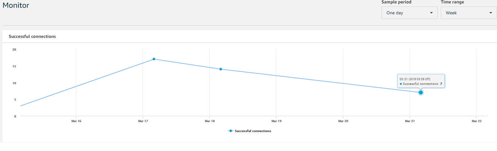

The monitor seems to be connected successfully.
I don't have any idea ,can someone help me for this please?
    For your certificate files, please be sure that you include a newline character at the end of each line.
    Also, for the root CA cert you will need the Starfield Class 2 Certificate Authority cert. Looking at the Amazon Root CA certs provided by your endpoint server during the TLS handshake, it seems like those certs are not self-signed, but instead specify a chain of Starfield certs ending in the Starfield Class 2 Certificate Authority. Thus, that is the certificate you must flash to the CC3220 and specify as the root CA when connecting to your AWS server. Please use that Starfield cert and try connecting again.
