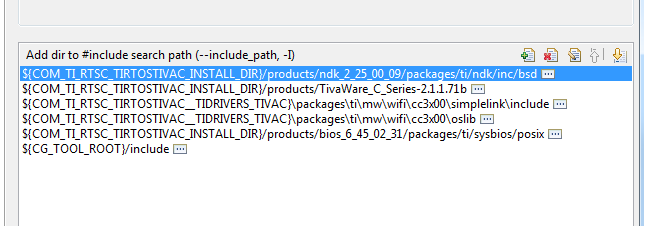

    After deeper investigation of tidrivers_tiva_<version> I figured out the following search path that is totally within tirtos_tivac.
    I looked at the ti-rtos spi driver files to understand how those link with simplelink related functions. Then I have realized that all necessary code is already included in ti-rtos at location:
    ${COM_TI_RTSC_TIRTOSTIVAC__TIDRIVERS_TIVAC}\packages\ti\mw\wifi\cc3x00\simplelink
    Modified search path, as shown above, looks better and makes more sense to me. Does the logic make sense?

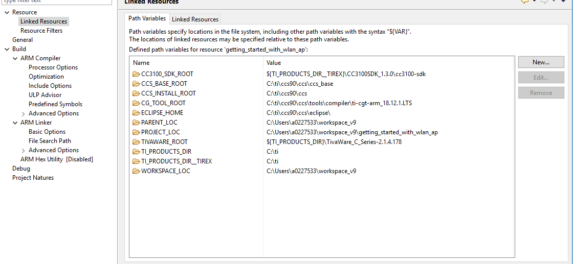

    I just built with no problem. Had to install CC3100SDK and Tivaware v2.1.4.178 here: .
    These are my project properties:
    Also make sure CCS recognizes your TivaC install in Windows->Preferences->Code Composer Studio->Products.
    Will show up as TI-RTOS for TivaC.
    Jesu
