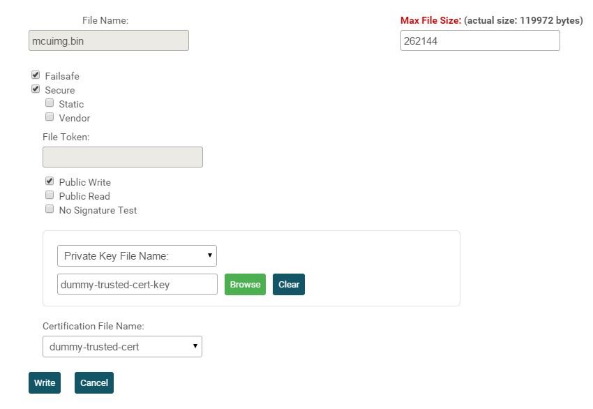

Customer doesn't plan to OTA upgrade with bundle tar file since they want to save some code space.
However while following the procedure below, /sys/mcuimg.bin was roll back.
1. Open /sys/mcuimg.bin with the following flags:
FsOpenFlags = SL_FS_CREATE;
FsOpenFlags |= SL_FS_OVERWRITE;
FsOpenFlags |= SL_FS_CREATE_SECURE;
FsOpenFlags |= SL_FS_CREATE_FAILSAFE;
FsOpenFlags |= SL_FS_CREATE_PUBLIC_WRITE;
FsOpenFlags |= SL_FS_WRITE_BUNDLE_FILE;
FsOpenFlags |= SL_FS_CREATE_MAX_SIZE( MaxSize ),
sl_FsOpen((const unsigned char*)g_OtaFile.filename, FsOpenFlags, &token);
2. Write the application image into /sys/mcuimg.bin: sl_FsWrite((int32_t)g_OtaFile.handle,g_OtaFile.offset, (uint8_t *)buffer,(uint32_t)length);
3. sl_Stop() and then sl_Start()
4. Invoke sl_FsCtl(SL_FS_CTL_BUNDLE_COMMIT, token, NULL, (uint8_t *)&FsControl, sizeof(SlFsControl_t), NULL, 0, NULL);
sl_FsCtl returned SUCCEEDED. But the application is still the original one after MCU reset.
Would you let us know if there is any problem for the above procedures? Thanks!
