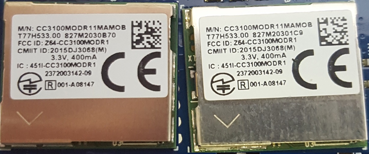

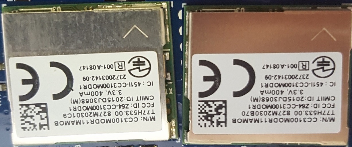

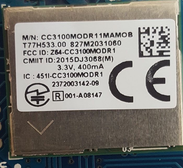

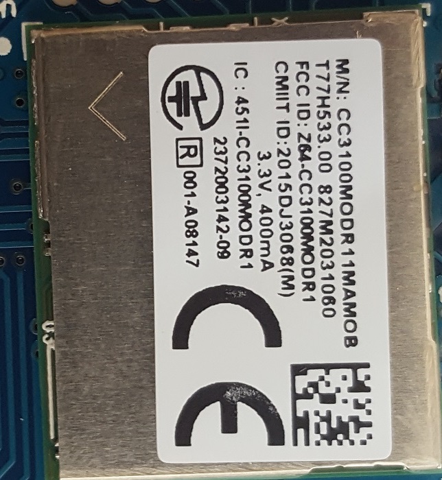

we have some problems with CC3100MOD modules.
1) the NWP_ver_problem.jpg of the CC3100MOD module where NWP version cannot be updated from host MCU.This is known problem with engineering samples (at leas this was the case last time);
2) the wifi_net_not_found.jpg is something new to us. With these two modules, no WiFi network can be found. Connection to host MCU works fine, PCB and antenna circuit are also OK.
do you have any clue or what to check?
any advice is more than welcome.
thanks a lot in advance
KR
Vincenzo

  • Hi Benjamin,
    this issue was raised by me and initially discussed with Vincenzo so let me continue.
    1) We use file system API to open and write servicepack file. I tested this problematic unit again by simply writng new file to file syetem and i get an SL_FS_NO_DEVICE_IS_LOADED.
    2) There is an issue with these two units on the photo plus 2 units i received this morning from EOL testing. More than hundred units were produced in this batch and all other are working fine.
    I do have some R&D samples of our system that have deliberately crippled antenna circuit where i can still get some WiFi networks nearby. With these units i mentioned i am not able to get any WiFi networks at all.
    BR,
    Primoz

  • Hi Kim,
    see updates below.
    Regarding units where servicepack file cannot be updated from host MCU. We used Uniflash tool to list files buf flash was not formatted as suggested in previous posts. Let me stress that CC3100MOD was brand-new and never used before. We don't like the idea to introduce Uniflash to production EOL and test/format every unit that does not come properly formatted from TI. Is there any way to assure that every module comes properly formatted?
    Now about units where no WiFi networks can be found. There were 3 units affected and following tests were done:
    Unit #1
    • no networks can be found
    • files can be listed with Uniflash and file /tmp/phy.cal does exist
    • No CW observed with spectrum analyzer
    Unit #2
    Unit #3 (most confusing)
    • There were no WiFi networks found at EOL but here in the lab i can sometimes list some of networks. 6 or 7 networks can normally be found but with this unit i can randomly find 0 up to 7 networks. Mind that the strongest WiFi network (around -44 dB) can't be alwasy found but others much more weaker can be (arond -80 dB). Cases vice versa where strongest networks can be found but weaker aren't were also observed.
    • We also tried to connect this unit in AP mode to one of WiFi networks found but connection was never made.
    We don't have X-ray results yet but i'll post here once available.
    I look forward for suggestions.
    BR,
    Primoz
