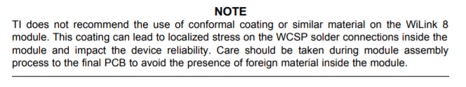

We have a question regarding this note on page 40 of the WL1837MOD datasheet.
Does that statement include using water soluble flux? Or chemical cleaner with no clean flux?
Thank you!
