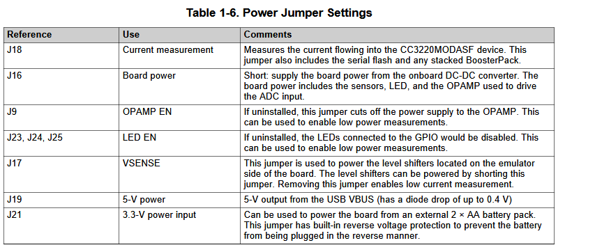

I am trying to measure the current and power consumption of  cc3220modasf board.I have read in the manual that J18 is for current measurement.But i am facing difficulty in figuring out which pin is J18 as it is not mention on the  board?
