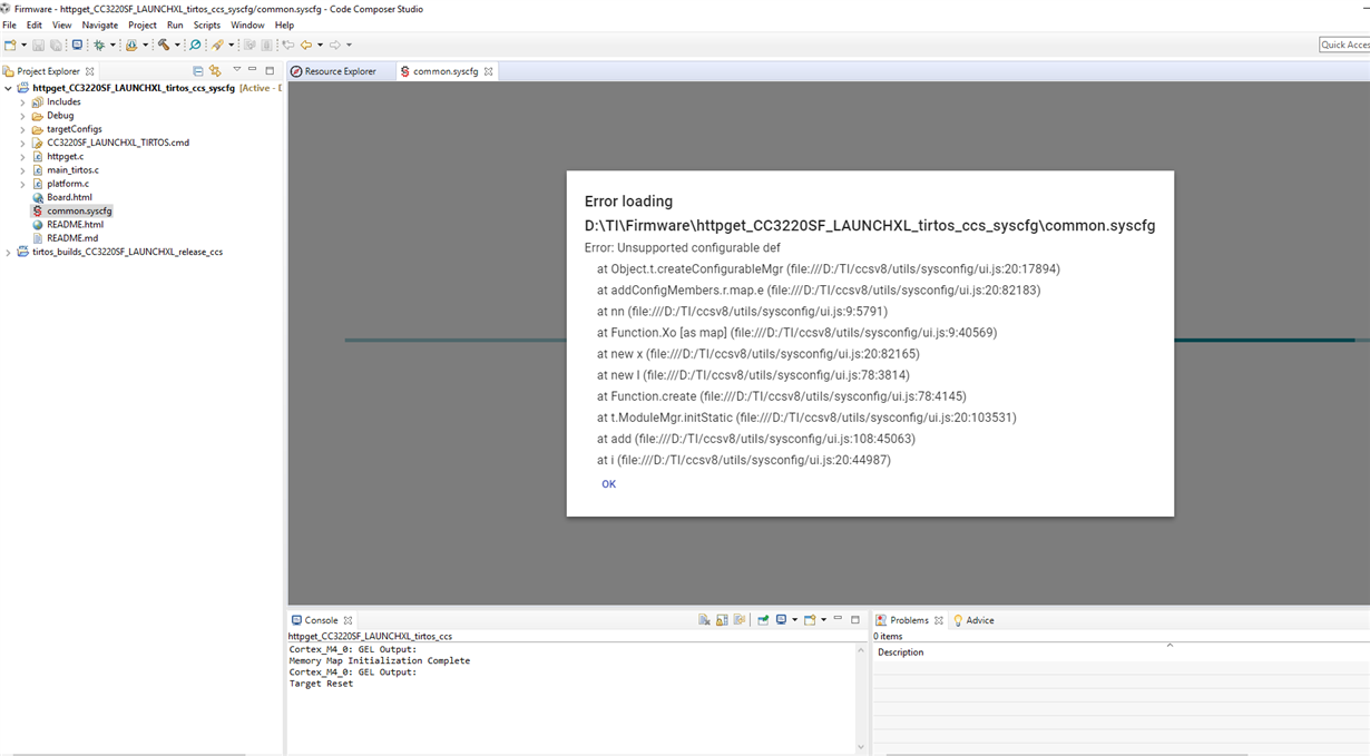

I downloaded the new 3.10 SDK to open the httpget using the syscfg_preview, however, when I choose CCS compiler, project, it does not open the common.syscfg correctly. I found that the gcc compiler project does open the .syscfg file.

    Q1: Can you provide a screenshot of the issue you are having? I

    Q1: Can you provide a screenshot of the issue you are having? I.
    See error below. I wanted to correct my earlier statement: both SDK 3.1 and 2.4 as well as the gcc version of SDK 3.1 came up with this error, the gcc version of SDK2.4 is what I could get working. However it did not offer the DMA option in the PWM configuration. Also, the information that is missing is how do I clear the resources used in demo and make sure I am not clearing resources to key features. Maybe a map of the hardware resources to the features e.g. UART0 for printf for debugging etc.

  • Shyam,
    What SDK version are you using? I don't think this is a issue in the latest SDK. Try updating and seeing if that fixes your issue.
