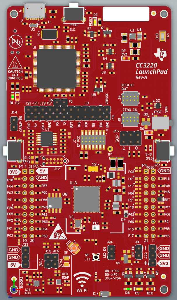

  • Thank you for your answer, Alexis!
    As I understand, you meant this link http://www.ti.com/lit/ug/swru512/swru512.pdf, because yours doesn't work for me.

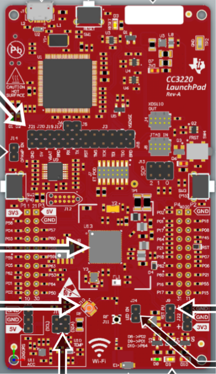

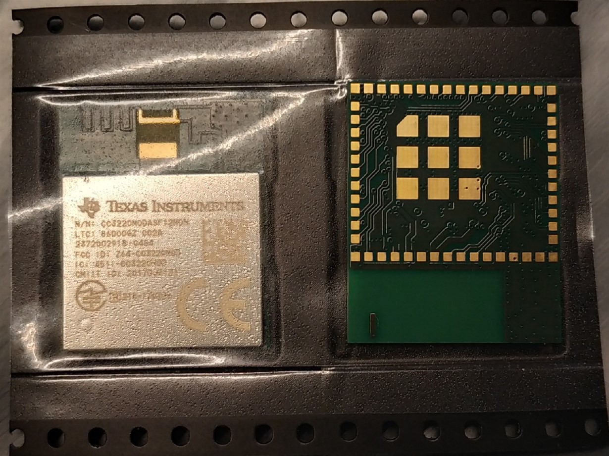

    I don't have CC3220MODASF LaunchPad, I only have CC3220SF-LAUNCHXL. And I have a separate module CC3220MODASF12MON without LaunchPad. In the case of LaunchPad, I realize how to flash a firmware throw USB. But I have incomprehension how to flash the firmware of plain module. Later I will use a custom board with a soldered module, but currently, I would like to know how to launch this module to test flashing and launching it without any excess hardware. So I wonder about minimal requirements to launch module and the easiest way to flash it. A photo of the module, about which I talked, you can see below.
    And the second question was about different designations on the same boards, that you can see on screenshots. For example, J6, J7, J8 are in different places of the boards, although these boards are called similarly.
    Roman

    As I understand, the module already has the PCB with an antenna, you can see it on previous photos, it's not a chip. I just want to try flash firmware to this module and launch it without LaunchPad. We will just try once and after that we will produce a proper PCB.
    So, in this case, everything that I need is to connect all GND and VCC pins to launch the module?

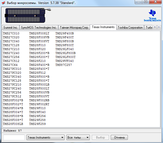

    Can you recommend me a SPI programmer to flash a firmware? I have several, but I don't know which chip I should select (see the screnshoot below). Perhaps you can share with me a specific SPI programmer, which can work with CC3220MOD and CC3235MOD.
    And what does "blue wire" mean in terms of FLASH SPI programming?
    Roman
  • Hi Roman,
    CC3220MOD can be programmed by UART from Uniflash. But if you want program SPI flash directly via pins, you need to use programmer with capability to program SPI flash MX25R3235F.

  • Hi, Jan!
    Thank you for the recommended SPI programmer, but they cost too much to just test. So I will try them later when I will be sure that everything works or if other methods don't work.

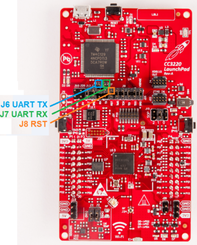

    But which jumpers should I use on CC3220SF-LAUNCHXL? I don't know, because my board CC3220SF-LAUNCHXL has other Pin designations from this guide www.ti.com/.../swra568.pdf. I have Pin designations on CC3220SF-LAUNCHXL like on the screenshot below.
    Roman
  • Hi Roman,
    Programming by Uniflash can be done via any kind of UART to USB converter with capability of 921600bd. That means you can use something like FT232RL or CC3220SF LaunchPad. Choice is up to you. In your case is usage of CC3220SF-LAUNCHXL fine.
    I agree that image at fig-4 is pretty weird. It seems that board is marked Rev-A (production version of board) but silkscreen is from pre-production board and contains pre-production silicone (XCC3220 chip). But this is not important. At this figure are marked right connection points (blue, green, orange).
    Inside module is integrated QFN chip. But pin mapping is different. That means MOD pins numbers != QFN pin number. For hardware connection you need to use pin numbers from MOD datasheet.
    Before you connect your module to Vcc please read this design checklist ( www.ti.com/.../swru462 ). For example SOP lines need to have current limiting resistors, etc.
    Jan

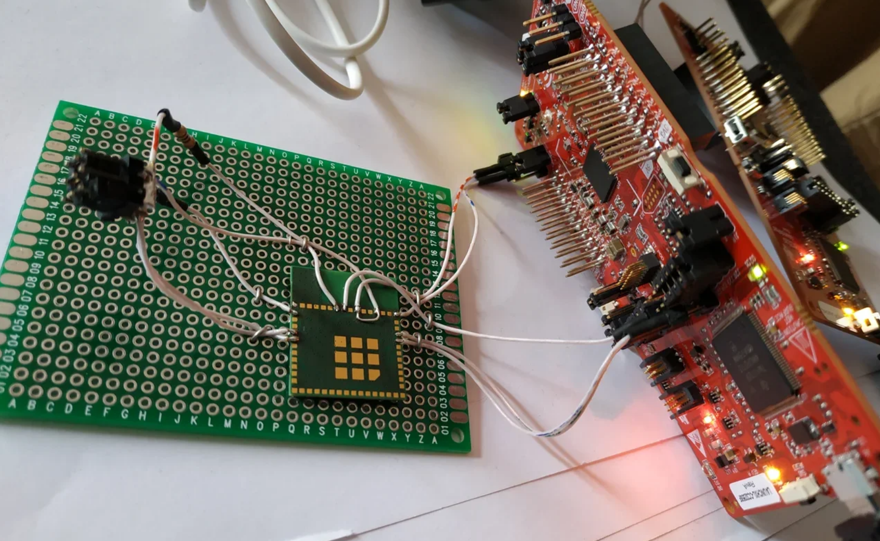

  • Hi, Jan!
    Thank you for your assist! I had tried to program a CC3220MODASF12MON module using UART to USB converter PL2303 and through CC3220SF-LAUNCHXL, but nothing has worked out. In the case of PL2303, Uniflash doesn't detect any devices. In the case of CC3220SF-LAUNCHXL, Uniflash detects something and I can read target memory, load firmware from CCS, but indeed it is connected to CC3220SF-LAUNCHXL, not to the CC3220MODASF12MON module. So I read target memory from and load firmware to intermediate CC3220SF-LAUNCHXL, and not to CC3220MODASF12MON module. I don't know, perhaps we have connected something wrong, but everything seems okay. But Uniflash doesn't detect the CC3220MODASF12MON module, which I need to program. Could someone reveal his/her way to flash firmware through UART connection? Because I don't know what is wrong.
    I will be extremely appreciated for help!
    Roman
  • Hi Roman,
    Sorry, I am not able say what can be wrong in your case. It seems that you not have connected all required pads at module (all GND pads). From your picture is not obvious how your module is connected to LaunchPad. Maybe you have exchanged RX/TX lines. Maybe issue is not connected GNDs, maybe you not have properly connected reset pin, who knows....
    Your communication with CC3220 chip is possible from CCS, because you still have connected JTAG jumpers (TDO, TDO, TCK, TMS).

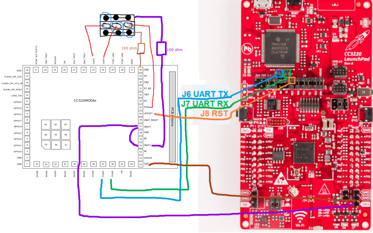

  • Many thanks, Jan!
    We rang-out all GND pads using a multimeter and it seems that all of them are continuous. Do we need to connect them additionally?
    I tried to depict our connections, but it seems that we really mixed up RX/TX lines. Can you prompt us, do we need to swap them?
    And can you say, are other wires correctly connected or not?
    And in case of correct configuration, what will I see in Uniflash GUI, when push Detect button? Should I see CC3220MODASF12MON or CC3220SF-LAUNCHXL?
    Roman
  • Hi Roman,
    I am not able to confirm, if is absolutely mandatory to be all GND pins connected.
    From my point of view your connection looks OK including UART connection (GPIO_02 to J6, GPIO_1 to J5)
    No. Not it is not about detect button. But about ability to connect by Uniflash via UART. You need to be able connect as is lustrated at chapter 6.4 in www.ti.com/.../swru469

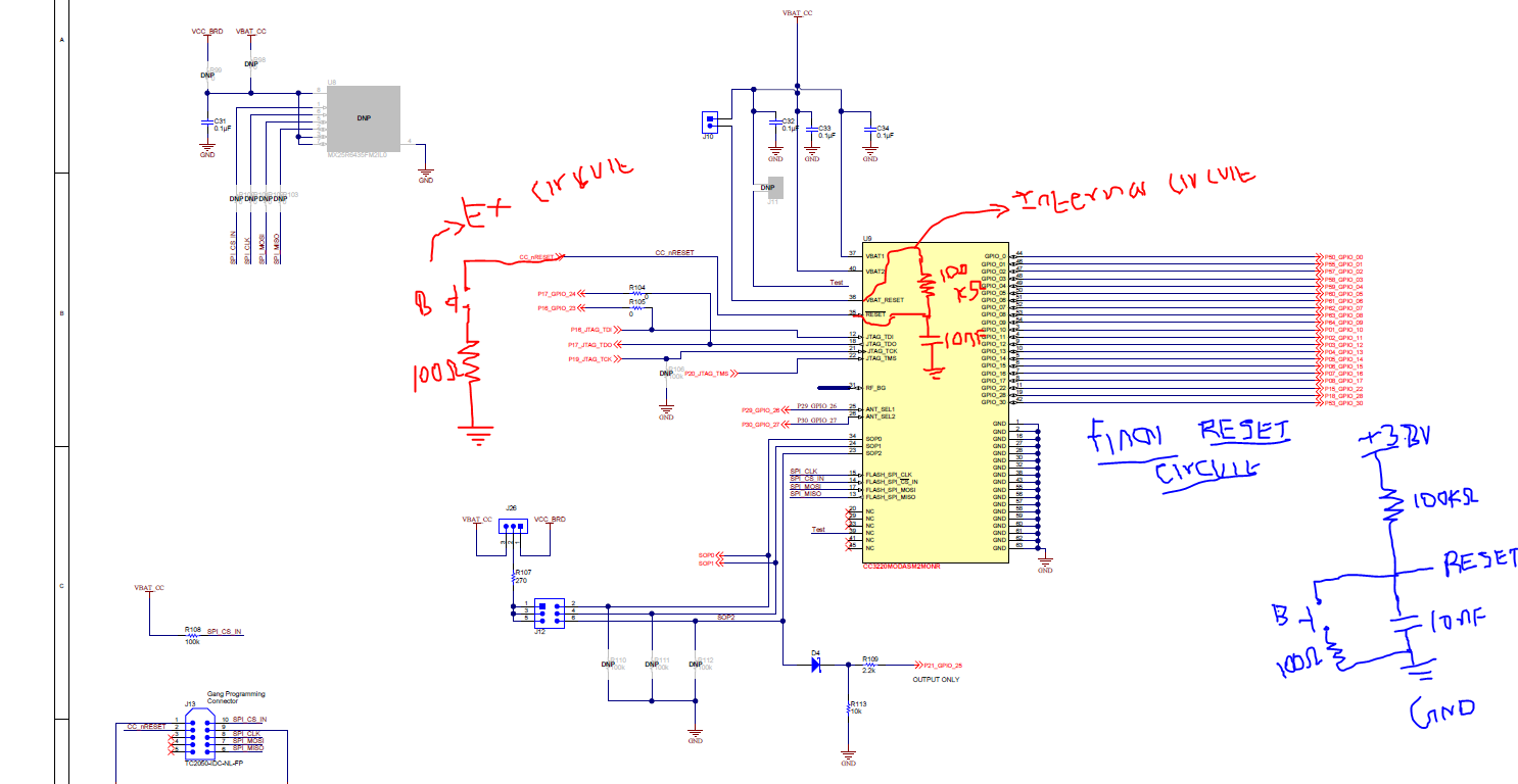

  • Hi Jan,Roman,
    VBAT_RESET must be pulled up to VCC_3.3V.
    Jan my understanding is correct see image ?
    Vasu
  • Hi Vasu,
    Thank you for your comment.
    Connection of VBAT_RESET pin is described at chapter 4.2 in CC3220MOD datasheet.
    In case of connection to CC3220 LaunchPad is this additional pull-up resistor not mandatory, because it is at LaunchPad already (see schematic  of LaunchPad and 100k resistor R17). But at other hand. If you connect additional 100k resistor, it should not happen anything wrong. Only power consumption will be slightly higher.
    Jan
  • Hi Jan,
    Thank you for your clarification,
    I checked with schematic you are right.
    If we go for module with own pcb VBAT_RESET must be pulled up to VCC correct ?
    Vasu
  • Hi Vasu,
    Yes, is should be. Unless you have nRESET controlled by some other external circuits with own pull-up.
    Jan

  • I want to give thanks to you, Jan! You have helped me to resolve my troubles with flashing firmware to a module. It seems that I figured out with this process and now I am able to flash module and launch it. Thank you very much!
    Sincerely,
    Roman
  • Hi Roman,
    Great. I am just curious, what was wrong?
    Jan
