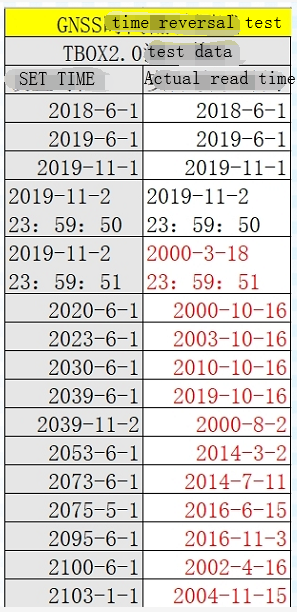

Dear TI team:
   My customer gave me a feedback about GPS time reversal issue:
The U.S. civil GPS service interface board (CGSIC) has issued a weekly GPS count warning on the department of homeland security website for a second flip on April 6, 2019. Then my customer tested WL1861 was also found to have a time reversal problem.The time of the flip is November 2, 2019.
Does TI have any countermeasures against this problem?
Customer test data:
Thanks!
Regards!
