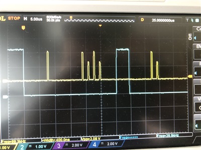

I am using the CC3220 Launchpad with 20 MHz SPI connection to transceiver. I ported the application from STM32 architecture with HAL drivers.
For the transceiver we need to do some time-critical tasks (with mainly small SPI transfers) in between reception of transmission of frames of the transceiver. It turns out that the current implementation takes too long to be on time.
The CC3220 uses a higher SPI CLK (20 MHz) than the STM32 (18 MHz), but still it takes more time on the CC3220 than STM32. When analyzing the transfers, it turns out that the overhead of SPI transfer for my current implementation is too high. An example is shown below for SPI write command where first a header is sent, then a pretty long pause and then the payload (Blue is CS, Yellow is SPI CLK):
As you can see there are a few things that mainly determine the total transfer time:  (1) time between CS and start of transmission, (2) time between end of header and start of payload transmission and (3) time between end of payload transmission and CS. In this case, these times are (1) ~7 us, (2) ~10 us and (3) ~5 us. In the STM32 example these are (1) ~2 us, (2) ~2.5us and (3) ~1.5us.
So my question is: what would be the best way to implement this? My current implementation looks like this:
    transaction.count = (uint32_t) headerLength;
    transaction.txBuf = (void *) headerBuffer;
    transaction.rxBuf = NULL;
    SPI_Transaction transaction2;
    transaction2.count = (uint32_t) bodyLength;
    transaction2.txBuf = (void *) bodyBuffer;
    transaction2.rxBuf = NULL;
    /**< Put chip select line low */
    GPIO_write(CS_GPIO, GPIO_PIN_RESET);
    /* Perform SPI transfer of header */
    bool transferOK = SPI_transfer(spi, &transaction); /* Send header in polling mode */
    bool transferOK2 = SPI_transfer(spi, &transaction2); /* Send body in polling mode */
    /**< Put chip select line high */
    GPIO_write(CS_GPIO, GPIO_PIN_SET);
This implementation is "code-wise" similar to the STM implementation. I have also tried to do one SPI transfer, and use malloc and memcpy to create a signle buffer for transaction.  This way you will not have a gap between the two transmission, but you will need more time (~4-5 us extra for 5 bytes as far as I can see now) to do the memory allocation and copy.  On the other side it would relax the constraints on the SPI transfer time if I am starting to use DMA (but I want to prevent this extra challenge for now if possible). So the options that I am now considering are:
(1) Use of the hardware CS (and hope that it is a lot faster). One problem however is that the original STM32 application code kind of abused the SPI CS to wake the device up as well. I don't see how I could do something similar in such a configuration.
(2) Use driver lib instead of TI Drivers. The driverlib seem to be very close to hardware registers, so using hardware registers directly would probably not help much. I am still not sure however if I would gain a significant amount of time, and if so: where can I get the gain? I was thinking about the SPICSEnable() and SPICSDisable() functions, but if I see the documentation of the functions I don't think they are very useful
Could you help me considering my best options? There should be a way to reduce the time between CS and SPI_CLK right?

  • Hi MJ,
    If you are using GPIO-controlled CS, then you should ensure that the SPI peripheral is configured to not toggle CS in hardware. See my post here for how to do that with the CC3220:
    e2e.ti.com/.../2851536
    You do not need to use SPICSEnable()/SPICSDisable(), as the signals will be controlled by your GPIO. If CS is GPIO controlled, then you should be able to set CS active at the start of the header transfer and then keep it active until the end of the body, avoiding the CS toggle time between the two packets you are observing.
    Other than using a GPIO to set the CS signal active for both transfers, there isn't too much you can do to speed up the other bottlenecks for the transfer. Calling SPI_transfer() twice will involve some function call overhead, but doing a malloc() + memcpy() would also use up time. If you have a fixed size header/body, then you could have a static struct that you can write to directly when building your SPI transaction. That would allow you to pass the header+body as one SPI_transfer() call.
    Using raw driverlib to perform the SPI transfer might result in some cycle savings, but it would be not trivial to setup. You can take a look at the SPI driver code to see what driverlib calls you would need to perform the transfer. This approach would be harder to implement than simply using the driver due to the added complexity of course.

  • Dear Michael,
    Thanks for your reply. I am indeed using a GPIO controlled CS. My configuration is however slightly I noticed:
            .baseAddr = GSPI_BASE,
            .intNum = INT_GSPI,
            .intPriority = (~0),
            .spiPRCM = PRCM_GSPI,
            .csControl = SPI_HW_CTRL_CS,
            .csPolarity = SPI_CS_ACTIVELOW,
            .pinMode = SPI_4PIN_MODE,
            .turboMode = SPI_TURBO_OFF,
            .scratchBufPtr = &spiCC3220SDMAscratchBuf[CC3220SF_LAUNCHXL_SPI1],
            .defaultTxBufValue = 0,
            .rxChannelIndex = UDMA_CH6_GSPI_RX,
            .txChannelIndex = UDMA_CH7_GSPI_TX,
            .minDmaTransferSize = 10,
            .mosiPin = SPICC32XXDMA_PIN_07_MOSI,
            .misoPin = SPICC32XXDMA_PIN_06_MISO,
            .clkPin = SPICC32XXDMA_PIN_05_CLK,
            .csPin = SPICC32XXDMA_PIN_NO_CONFIG
    I am a little suprised that I missed the csControl flag in my code when I changed the config of csPin to NO_CONFIG. It does work with the config csControl set to hardware pin and 4 PIN mode. If I change it to software and 3PIN mode, it will probably optimized the speed slightly, since the SPI hardware tries to do the CS itself. I will try with that configuration when I am back in the office next week.
    Sorry that my picture was not well explained, but 2 separate SPI transfers are shown. I was only talking about the transfer in the first CS low cycle. During this CS cycle (which is software controlled) the code that I showed before is executed (so with 2 SPI_transfer() calls). I was suprised that there was such a big gap in between them, but that is probably because of the 4PIN mode. My guess is that the SPI controller tries to set and unset the non-configured CS-pin without raising an error.  This probably explains why there is such a big gap in between the two transfers.
    Maybe these changes will help me already to reach the right speed. The last thing I could think for speedup would be the DMA control. My hope would be that the program could continue preparing the next SPI transfer (so including malloc() + memcpy() calls) and eventually other tasks as well, and that a mutex before CS activation would guarantee that only 1 SPI call is done at the time. The callback would then release the SPI controller again. This would be the maximum I could get from the SPI interface, since it would be 100% utilized in that case. However I hope that this won't be necessary with the changes above.
    The driverlib would not be so trivial indeed, but I also doubt if I would gain a significant speedup (seen the small function pointer implementation of the TI drivers in the SDK). I can probably better spent my time in optimizing the other parts of the code.

  • HI MJ,
    Using DMA may not speed up your SPI transfers if your transfer sizes are small. This is since setting up the DMA transfers and handling the DMA interrupts will cost some CPU cycles. The SPI driver actually is built to use DMA, and will use it by default if it is advantageous to do so. If you are running the SPI driver in blocking mode and are transferring less than a defined number of words (default 100), then the driver will perform a polling transfer for you. Otherwise, DMA is used.
    Beyond the software CS change, I don't think that there is much else you can do to optimize the SPI transfers at a driver level unfortunately. You would probably want to optimize your application if you still are not reaching the desired transfer rates.
    Michael
  • Dear Michael,
    Thanks for your advice. Tomorrow I will test the CS software changes, so I will hope that will be enough.
    To optimize the rest of the execution: Could you help me out why I can't open the load analyser? My config filed is added in my previous post. I think I have turned on almost all logging possibilites, but still says that that Task Load should be enabled.
    MJ
  • I just did the testing with 3 PIN SPI and Software CS control, and now the large gap between two consecutive SPI_transfer() calls has disappeared. A malloc call is therefore not needed anymore, which speeds up the total write SPI command.
    During debugging I also noticed that the transceiver that is connected should have plenty of time with such high SPI speeds. I am now asking the manufacturer of the transceiver what could be the cause.
