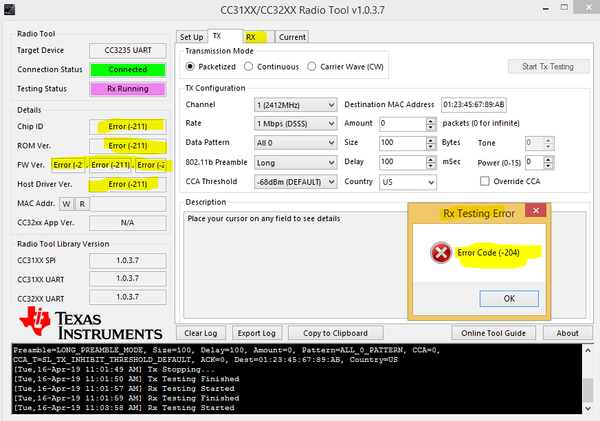

    Now, we are testing radio tool, There are some errors in it.
    Radio tool is unable to get the device details.
    Rx_Test failed.
    Current Test failed.
    Logs of tool are attached & also snapshot with error on tool.

    [Tue,16-Apr-19 11:00:54 AM] Chip ID=Error (-211), ROM_ver=Error (-211), FW_ver=Error (-211).Error (-211).Error (-211), MAC=, Host_Driver=Error (-211)

    You you have Radio tool image inside your device? For function of radio tools is mandatory to be uploaded "special" firmware inside CC32xx devices.

    I am trying device images i.e. "C:\ti\CC3xxx_RadioTool_1.0.3.7\Device Images\CC3235SF Images\Programming.sli" .
    is this the correct one ?

    Yes it should be proper one. Please read www.ti.com/.../getliterature.tsp at chapter 6. Additional option may to be use Uniflash software (v 4.2 and higher). Make sure also that you have selected proper COM port.

  • Thanks . That resolved my issue.
