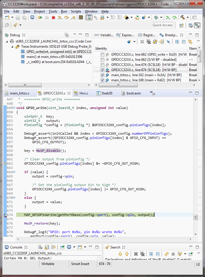

When I run the project, when the code gets to the write to make the first of the new pins high,  the code gets trapped in an interrupt handler.
 *  ======== Hwi_excHandler ========
Void Hwi_excHandler(UInt *excStack, UInt lr)
    Hwi_module->excActive[0] = TRUE;
    /* spin here if no exception handler is plugged */
    while (Hwi_excHandlerFunc == NULL) {
    Hwi_excHandlerFunc(excStack, lr);
I conclude that  I have not  correctly set up the pins or there is a conflicting setup for some other function on those pins but I do not know how to find such a conflict.
Had the comments in the code for  GPIOCC32XX_GPIO_10, and GPIOCC32XX_GPIO_11 not warned my about conflicts with UART and PWM pins I would have had no clue.  Perhaps I need to identify some similar conflicting changes for the new pins in the board.h file but do not see it.
I will provide fuller code examples in a following posts.
Suggestions for what I should do next?

  • It is an exception that is trapping the code.
    After single stepping through code I found more accuratly where the code triggers the exception. It is line 7=674 below the MAP function.
  • Hi Forrest,
    You need to call GPIO_init() before you can call any actions for that peripheral. Please see the drivers examples in the SDK, or you can check out the TI Drivers API documentation in the SDK: dev.ti.com/.../node
    Sarah
  • Bingo Sarah!
    My notes. I looked in the main function and found:
        /* Call board init functions */
        Board_initGeneral();
    I opened the decleration for that function which was in CC3220SF_LAUNCHXL.c and added your reccomended change. It now reads like this:
