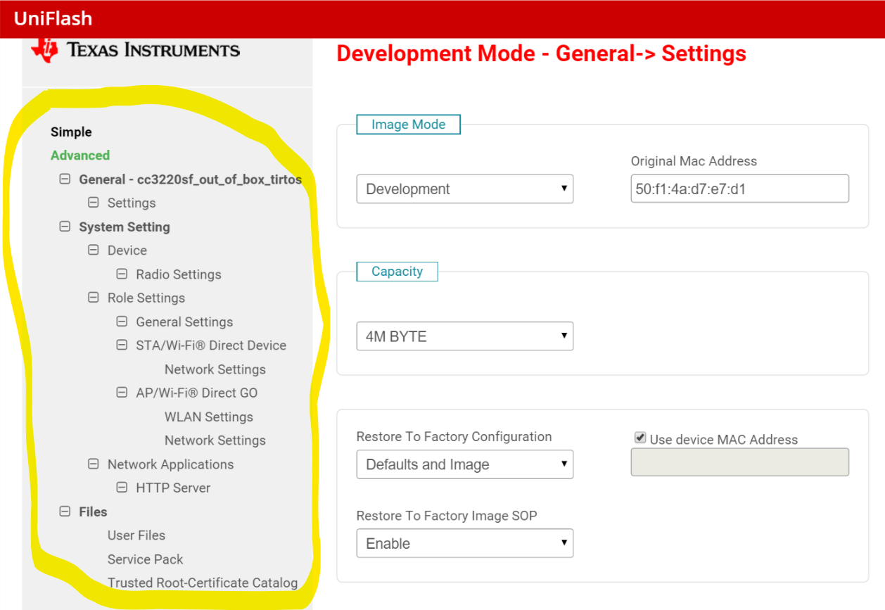

Hi
Relating to following thread, the customer has additional question.
https://e2e.ti.com/support/wireless-connectivity/wifi/f/968/t/793903
Uniflash can make OTA image in TAR file.
However, the information of WLAN profile information would not be included in it.
I attached Uniflash image for explanation.
When OTA image is created with Uniflash, what information is excluded?
Can you tell me what excludeded is from the area surrounded yellow marker?
We might have to consider the other settings than WPAv2 password if needed.
BestRegards
    Only the User Files and the Service Pack are included in the OTA image.
    In addition you have an option to create a special OTA image that will only contain the Certificate Catalog (the catalog can only be updated in a dedicated OTA update).
    If you are not sure about the content, you can check the "1/ota.cmd" metadata file within the OTA tar file.
    It is a text file that lists the files being updated.
