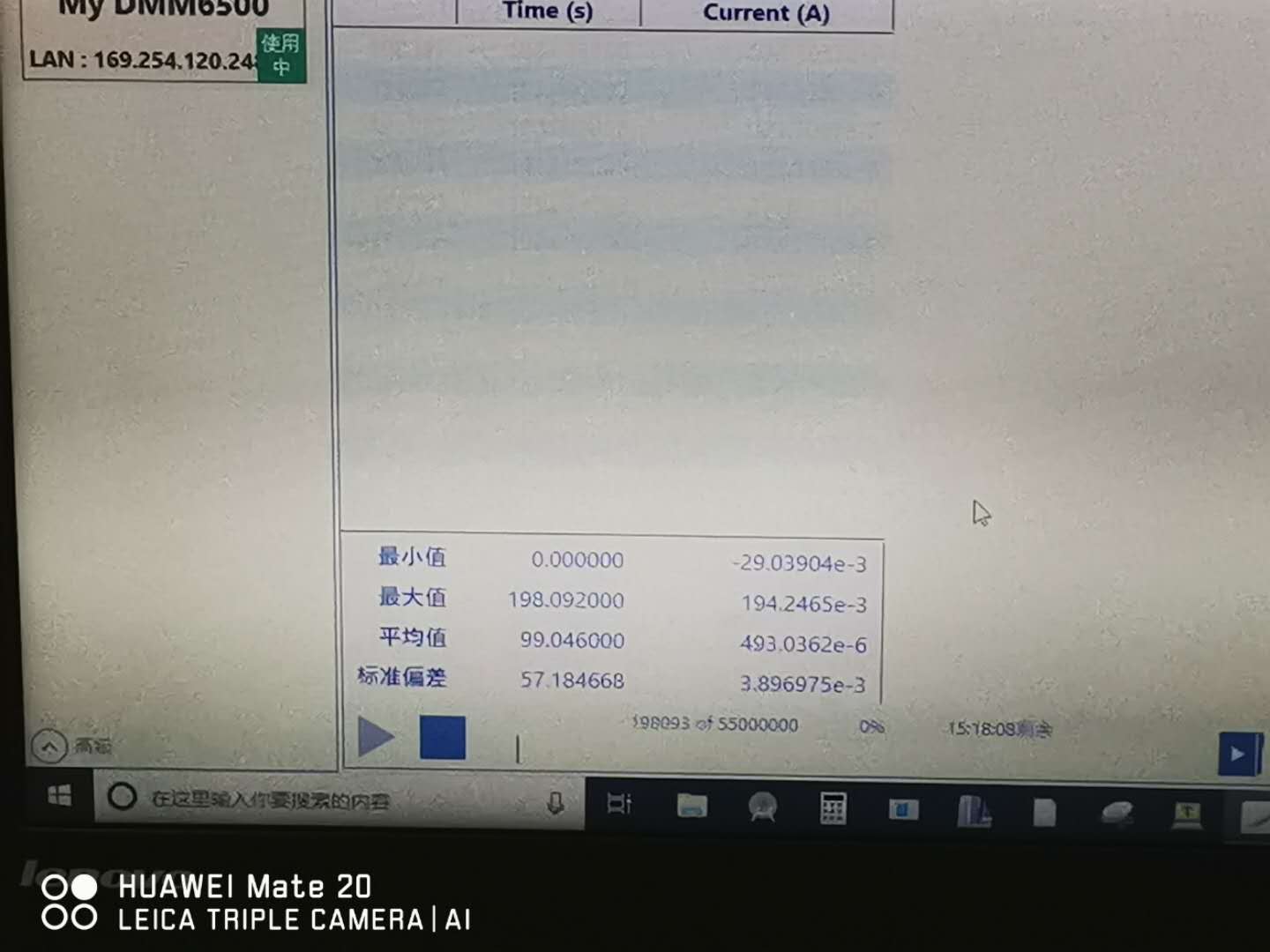

 e made ELOCK CC3220, follow CC3120, CC3220 SimpleLink ™ wi-fi ® Internet - on - a chip ™ Networking Subsystem Power Management test average Power consumption, burn power_measurement. Bin to the development board, UART print data and select (Always - Connected Current, 2000 milliseconds links interval), measured by the average Power consumption in 490 ua, and the data on the documents about 200 ua, as follows
Always-Connected Current, 500 ms link interval, the actual test power consumption is as follows
The information for the test platform and test development board is as follows
Could you please help me check if there is anything wrong with the setting or test method? Thank you

  • Allen,
    Table 4 in the Power Management Appnote (www.ti.com/.../swra502c.pdf) shows that the avg current consumption is 200uA/2000ms sleep interval.
    I believe what you are measuring, 500uA, and showing in your pictures is the avg consumption over time as the device is running the power_measurement example. See Section 2.5.2.3.
    Also, when evaluating the CC3220's low power modes,
    1) Keep in mind that your AP's DTIM interval can affect the device's sleep intervals (Table 3)
    2) Using UART and voltage translators on the LP will increase the avg current consumption.
    3) An SOP pull-up is not required when the device is in functional mode.
    -Seong

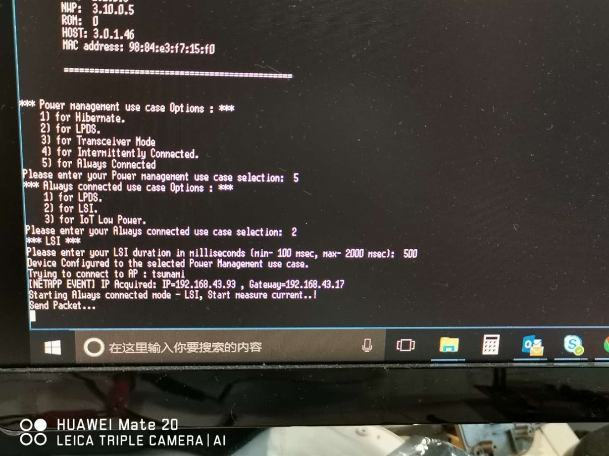

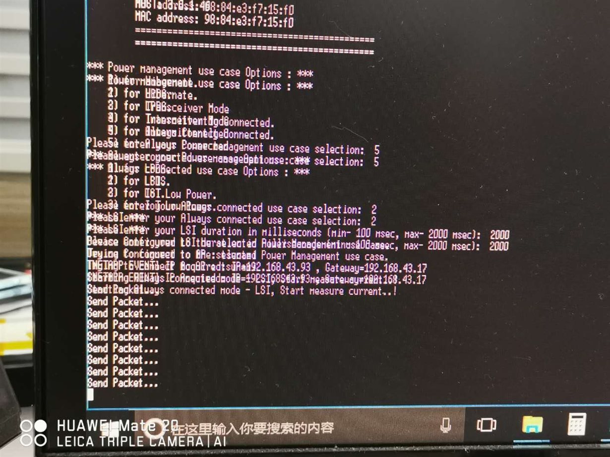

  • The test steps are as follows:
    1. Burning power_measurement. Bin into CC3220 LaunchPad
    2, remove jumper J19
    3. Connect the current test equipment
    4, With the USB cable connected and the CC3220 LaunchPad turned on
    5. UART prints out the data, select 5 (for always connected), select 2 (for LSI) in the second part, and select 2000msec in the third part.
    6. The average current of the test results is about 500 microamps, and the guidance document is over 200 microamps
  • Allen,
    There are different things that will affect the current consumption such as your AP and the environment your test set up is in. The best environment to do your experiment in is in a shielded room or a room with minimal signal traffic.
    In always connected mode, the device is in LPDS and wakes up to receive packets so there will be a fluctuation from 135uA and 50mA. So the first thing I would validate is the LPDS current during LSI.
    Two extra steps I recommend is to:
    1) Modify your code so that the power_measurement example automatically puts the device in always connected mode (LSI, 2000ms) without user input. This eliminates the need for using UART and you can then remove all the isolation block jumpers.
    2) And remove the SOP pull up jumper shown in your LP's picture after you flash the aforementioned modified code. The device will boot in functional mode with the SOP configured as 000.
    Let me know how this affects your measurements.
    BR,
    Seong
