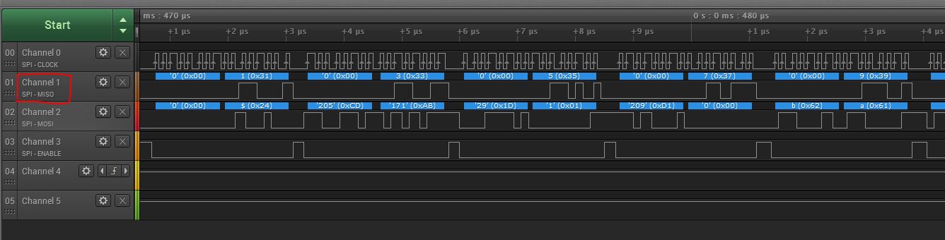

CC3220S: SPI miss 2 bytes between fh8610 and CC3220
Part Number: CC3220S
SPI Parameters: dataSize 16bit, clock 6MHz, polarity 0, phase 0
Issue Detail: When the FH8610(slave) and CC3220 (master) communicate by SPI, the original buf is "123456789123456789", but the actual sending is "1256914589". In other words, 2 bytes are sent successfully, 2 bytes are lost,2 bytes are sent successfully, 2 bytes are lost ......  But receiving data from CC3220 is normal.
Do you have an idea what causes the SPI issue?
thanks
Kevin

  • Hi Kevin,
    Have you verified the full buffer is sent on the data line? Try using a logic analyzer. Include waveform in response if possible.
    Jesu

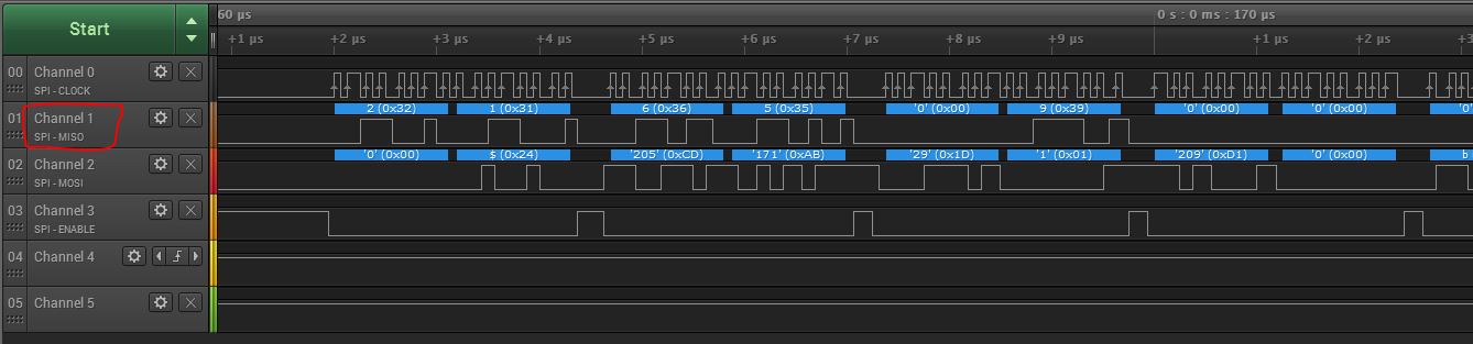

  • Hi Jesu,
    No matter what I set “half of fifo” or "full fifo", this issue always occur. Original buffer is "123456789",  logic analyzer catching shows "12569"(picture 1).
    But, when I change Dma_SetDstWidth from "DMA_TXR_16BITS" to "DMA_TXR_8BITS", logic analyzer catching shows "1 3 5 7 9"(picture 2).
  • Hi Kevin,
    It looks like the problem is FH8610 side because it's not sending out the full buffer for the CC3220. I'm not sure that device works but it seems like your DMA configuration is wrong some how or maybe you need to double clock speed. I am not familiar with the device you're using.
    Jesu

  • Hi Jesu,
    This issue that losing spi data was solved!
    WIFI's "csControl" should equal "SPI_SW_CTRL_CS", but no "SPI_HW_CTRL_CS".
