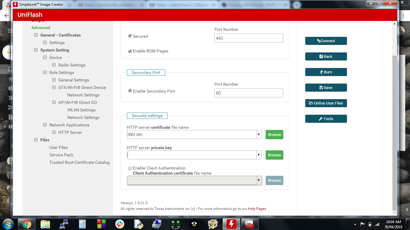

After lots of tries and retries I'm getting -688 error in httpget demo application.I'm doing HTTPS client connection and tries to connect in example.com. Can anyone help me this is a certificate issue I exported from example.com it downloads as .cer format how do I flash? I'm using Benjamin's shared file of httpsget.c and platform.c. Please solve this certificate error I'm doing this for 17 days and got frustrated by this example to execute it properly
Manish
  • Hi Manish,
    I just tested this out by downloading the DigiCert Global Root CA file from my browser (as "example.cer"), loading it to my device's file system, and modifying the httpget application from the latest SDK v3.10.00.04 to use an https connection (referencing "example.cer" as the rootCA). It works as expected without the -688 error.
    Please make sure your device is running the latest servicepack and test with the latest SDK rather than the files directly from my previous post.
    Ben M
  • Hi Ben,
    As per your instructions I did that but it is asking for HTTP server private key. Where do I get server private key? I'll attach a screenshot of that image. See the private key option there.
  • Hi Ben,
    Kindly check two files which have been attached in this reply.
