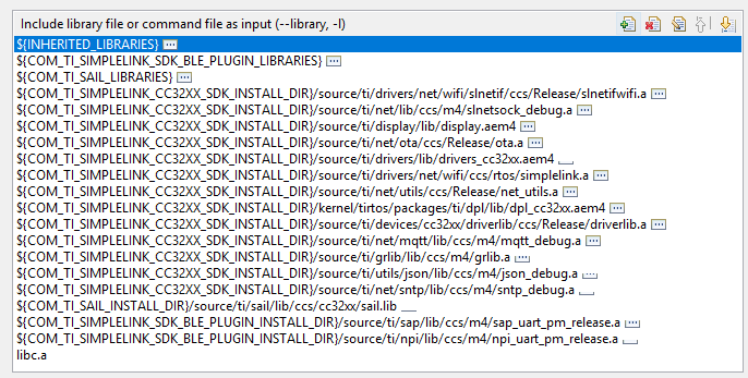

  • Hi MJ,
    Try putting ota.a above drivers_cc32xx.am4g but after the netsock library. I believe that is where all application libraries using the netsock layer should build. Here is my thermostat project:
    Sarah
