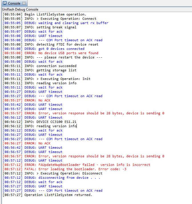

So far i tried to create the file from the code, but I tried out a different method
I created a exactly 600 kByte file, added to the file system with uniflash. With the list file system option i can see the file there, and if I start the wifi and the http server I can access it (mydomain.net/myfile.html). If I try to open the file from code it says the file doesnt exist (error code: -11) .
