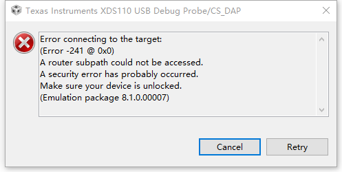

    When I loaded the program according to the Uniflash user manual you Shared, the program was successfully downloaded into FLASH, but after that, the following error occurred in the simulation with CCS. How to solve this problem?

    In case you connect via Uniflash please make sure that your device is set into development mode (see chapter 6.4 inside www.ti.com/.../swru469 ). From jumpers settings at image above (SOP mode 0 - 0 - 0) you need to use four wire JTAG. You need to check that you have select proper target configuration in CCS (4 wire JTAG not SWD).
    Jan
  • Jan,
    Your answer well solved my question. Thank you very much for your patient answer.
