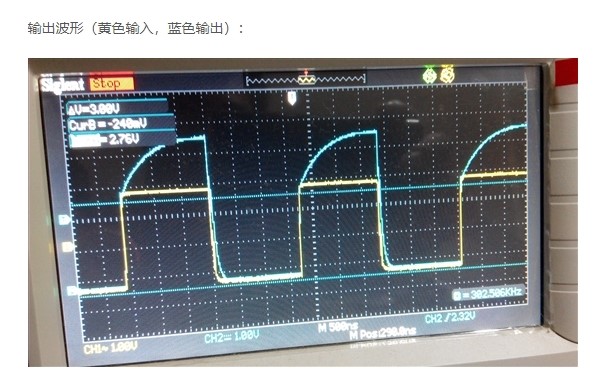

Hi Team
When Customer use AM5708  load wlcore_sdio, log will show a issue :wl1271_sdio mmc3:0001:2: sdio write failed (-110). Customer uses TXS0108E as voltage transfer chip, but SDO clock signal is distorted. Please check below screenshot and log. Customer will provide more details.

  • Is it with AM57x EVM or custom board? Which TISDK and kernel version are being used?
  • Custom board,   SDK is ti-processor-sdk-linux-am57xx-evm-04.00.00.04
  • Jerry,
    Can you provide a snippet of the board layout/schematics that show the SDIO signal path?
    Vince
