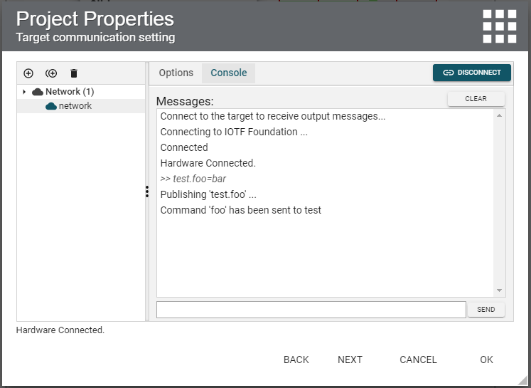

I'm trying to use GUI Composer to create a simple GUI to receive and send messages via MQTT on IBM Watson IoT Cloud. I set up my IBM Cloud profile and device, and am using the watson_mqttclient_CC3235SF example code.
Following the IBM IoT Tutorial I'm able to successfully receive a published message from the CC3235 on my GUI. However, I'm unable to bind a widget to send a message from the GUI to the CC3235. I followed the JSON formatting from the GUI Composer 2 User Guide but I am not detecting any activity on the subscribed topic.

    I was not able to get this to work well either. It seems like there are a couple bugs in GUI Composer that have broken the publishing. I have filed GC-1876 to address this.
    I did manage to send a message via the GUI Composer project properties dialog. Widget-bindings will not work right now, but if you want to test that your device can receive data from a subscribed topic, you can try the properties dialog. You first have to set the "device-type" in the index.gui (this is a bug, you shouldn't need to do this manually). Click the "< >" button in the toolbar and near the bottom of the file, edit the <ti-device-iot> element to include device-type eg.
    <ti-device-iot id="ti_device_iot" hidden device-type="YOUR_DEVICE_TYPE" device-id="12345abc" device-name="test"></ti-device-iot>
    Once that's done, navigate to the menu option "Project -> Properties" to get the console pictured below. You should be able to connect and enter a command in the form of "<bindingName>.<cmd>=<value>". Your device should receive the message assuming it's subscribed to "iot-2/cmd/<cmd>/fmt/json".
