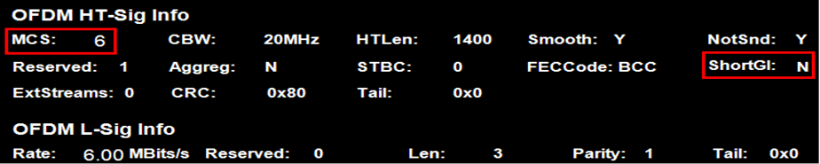

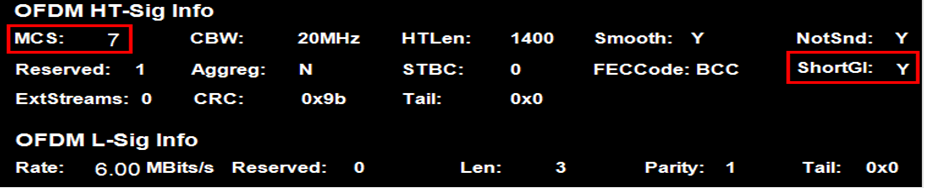

    Our engineer are validating CC3200's TX power & EVM by using Keysight N4010A.
    We found that CC3200's MCS7 EVM is too low.
    However,  MCS0-MC6's EVM are normal.
    After double checked, we found some output from Keysight N4010A like previous two screenshots.(MCS6 and MCS7)
    It indicates us: CC3200 uses LongGI when MCS0-MCS6 but CC3200 uses ShortGI when MCS7 mode.

  • Hi Kevin,
    No it is not possible to change the short GI parameter  in the source code for radiotool.bin. One thing that can possibly be happening in your setup is that the VSA demodulator is choosing the GI manually instead of learning it from the HT-SIG. Please  check this configuration on the VSA (see below).
