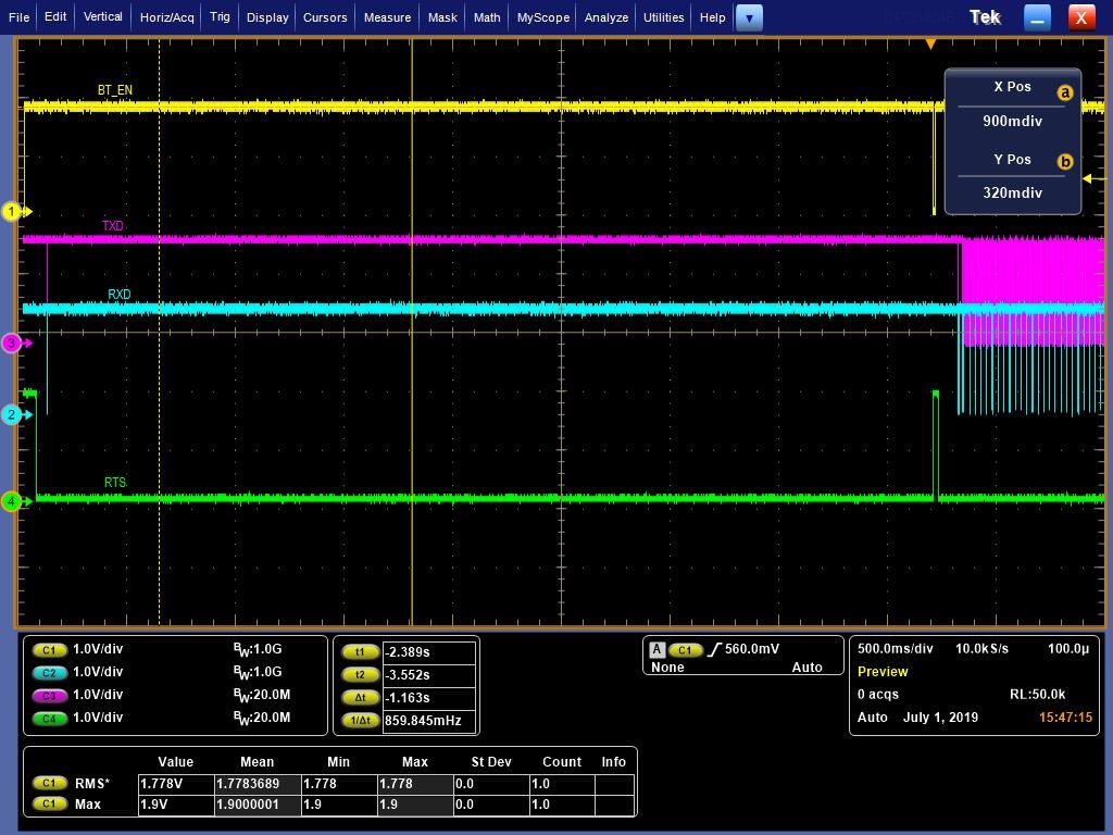

I have read other articles on the forum and I could make sure the CTS & RTS pins are connected correctly.
I also tried porting linux kernel 3.14.52 driver to kernel 4.14.78.
But the same error happened.

By the way, I changed the retry count from 5 to 10.
Could you help me with this?
