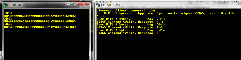

    The read now times out after 2 seconds. However the data is not getting through. More details: I send a ">04" command using a terminal program on my phone connected to the CC3220 WiFi Access Point.   The WiFi is writing the ">04" on to the 485 buss and the response is written back to the bus ("#04....")  The CC3220 UART is not sending the response out the WiFi to my phone terminal. Only the letter "A" and some  characters I think represent the CR LF come back to my phone terminal.
    Here is a screen shot where the left terminal windows is the CC3220 UART1 RS485 bus and the right terminal is the WiFi DEBUG UART0.
    The right terminal window should have response: "#040000086200000000000001C90000016F00"
    <edited>
  • Screen shot from my phone terminal.
  • The InitTerm() function was worked up by an engineer no longer here. So I am now coming up to speed. Looking at it I see that UART0 and UART1 are both initialized the same way by this code. Not sure if that is a problem since we are now trying to make UART1 have this Timeout behavior but am sure I do not know the implications for the DEBUG interface on UART0.

    I have run this on a CC3220MODA Launchpad.

  • I found the problem where our UART_read was timing out with no characters.
    In our init code above was this line:
    UART_control(uart1Handle, UART_CMD_RXDISABLE, NULL);     // GAA 30Aug2018
    This caused the UART not to read. Not sure how our UART0 was reading because the same code is run on it too.
    But when I commented out that line then our project works like the modification I made to the uartecho.
    My co-worker and I suspect that elsewhere in the project there are additional changes to the setup of the
    UARTs which we have not yet located.
    This resolves my problem.
