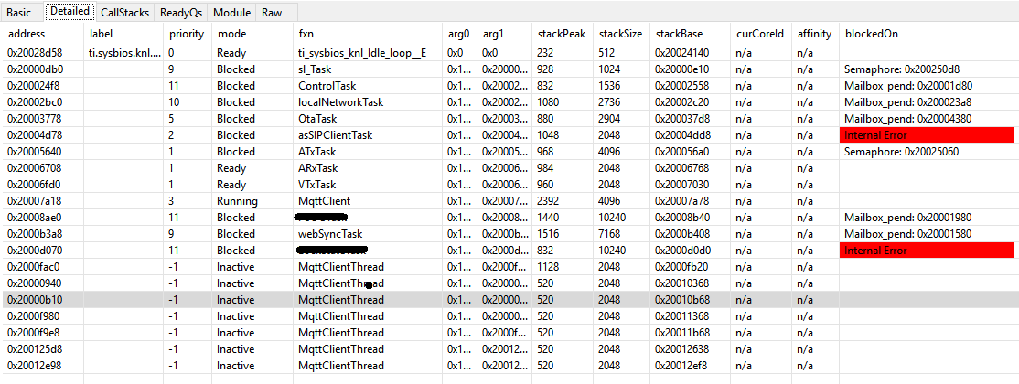

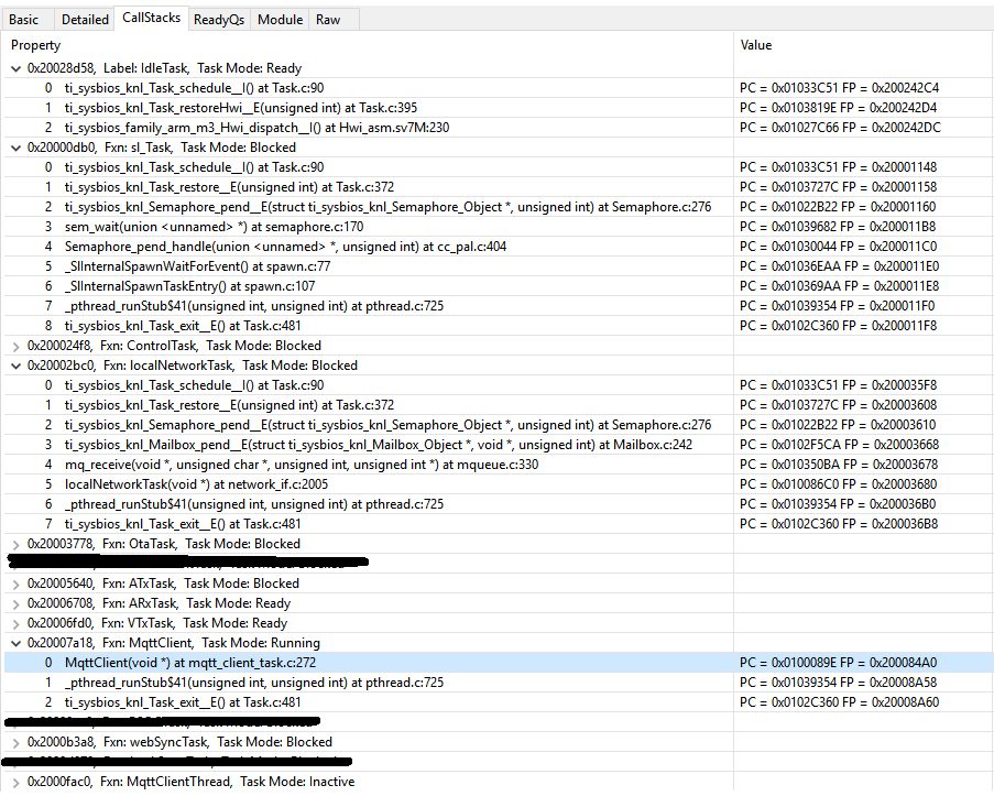

    Below attached is the call stack and task list.
    I noticed in the task list multiple tasks with the name Mqtt_client. Not sure why they are created.

    I don't understand why you have multiple instances of the MqttClientThread. Please verify your code (have you changed anything in the MQTT Client (app) implementation comparing to the example?). The multiple instances are not shown under the CallStacks tab (only under the Detailed tab), did you remove them (when you took the screenshot)?
    Did you put a breakpoint in the SimpleLinkFatalErrorEventHandler? The call stack doesn't seem to show this function.

  • Hi Kobi,
    I am also not sure about multiple MQTT client threads.
    I have not edited the attached images.
    The multiple instances are created when the client disconnects and reconnected again.
    The client does a pthread_exit(0); whenever a disconnection happens.
    And it does  pthread_create when reconnects.
    Is it the correct way of doing it?
    I noticed eventually after multiple reconnections pthread_create fail with error code 12.
    I need to check if I have modified something that can cause this behavior.
  • The pthread_exit() should terminate the thread.
    Are you sure it actually gets to the pthread_exit() call?
    you can handle re-connection within the client thread (i.e. instead of exiting, the thread would try to reconnect), but I would focus on verifying the pthread_exit() execution.
