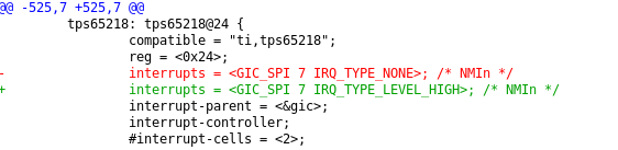

    thank you for your investigation. We have a custom board, as I wrote in my first post, so maby something is different to your setup...
    My steps to upgrade to the latest SDK:
    1) clone the newest Yocto Arago Repo and used the "processor-sdk-06.00.00.07-config.txt" config
    2) Added my meta-layer (adapted it to the new yocto release)

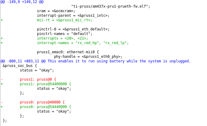

    3) Updated my device tree with the changes made in am437x-idk-evm.dts especially the pru parts.
    4) Updated the kernel config to use the newly named pru config names

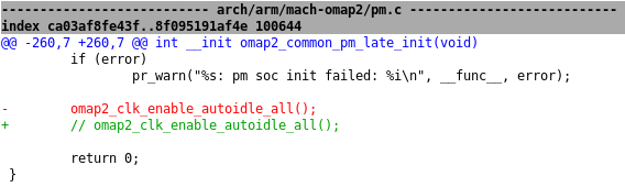

    5) In the 5.2 Release I have to disable the omap2_clk_enable_autoidle_all() in the kernel. Else my network devices were not working correctly. I have to do this in the 6.x release too.

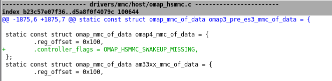

    6) Additionally, I had to apply the following patch to get wifi working in 5.2, so applied this one also in 6.x
    Thats all that I have to change for the 6.x update. Please find below the full dmesg log and my full device tree. Maybe this helps to spot the problem...

    	tps65218: tps65218@24 {
    		compatible = "ti,tps65218";
    		reg = <0x24>;
    		interrupts = <GIC_SPI 7 IRQ_TYPE_LEVEL_HIGH>; /* NMIn */
    		interrupt-parent = <&gic>;
    		interrupt-controller;
    		#interrupt-cells = <2>;

    &pruss_soc_bus {
    	status = "okay";
    	pruss1: pruss@54400000 {
    		status = "okay";
    	pruss0: pruss@54440000 {
    		status = "okay";
    &pruss1_mdio {
    	pinctrl-0 = <&pruss1_mdio_default>;
    	pinctrl-names = "default";
    	status = "okay";
    	reset-gpios = <&gpio0 20 GPIO_ACTIVE_LOW>;
    	reset-delay-us = <2>;	/* PHY datasheet states 1uS min */
    	pruss1_eth0_phy: ethernet-phy@0 {
    		reg = <0>;
    	pruss1_eth1_phy: ethernet-phy@1 {
    		reg = <1>;

    But the vwlan_fixed2: disabling message still appears and no mlan0 device is available.
    Can I provide you any further information that may help?
    Kind Regards,
    Martin
  • It does n't seem mmc3 slot is even detected. I would expect some thing like below in the log messages when the slot is detected..
    mmcx: new high speed SDIO card at address 0001
    Can, you send us the dts file, you have been using.
  • This is true. The mmc2: new hight speed SDIO card at address 0001 is only shown in the image with sdk 5.2.
    The reason for this is maybe, that the vwlan_fixed1 and vwlan_fixed2 gets disabled for some reason.
    [    3.315142] vwlan_fixed1: disabling
    [    3.319086] vwlan_fixed2: disabling
    These gpios are lo in sdk 6. In sdk 5.2 these were high.
    gpiochip5: GPIOs 160-191, parent: platform/48322000.gpio, gpio-160-191:
    gpio-172 ( |vwlan_fixed1 ) out lo
    gpio-173 ( |vwlan_fixed2 ) out lo
    I have already posted my full device tree of sdk 6. The differences to the dts file of sdk 5.2 are also described there. What I missed in that post is this change:
    This change fixes the warnings I described in my previous post when using the 5.2 dts file with the sdk 6.0 image.
    Of course, the am4372.dtsi file also has changed by ti in the sdk6. But I do not touch anything there.
    Kind regards
    Martin
