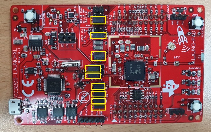

1. Check the Board Jumper setting.

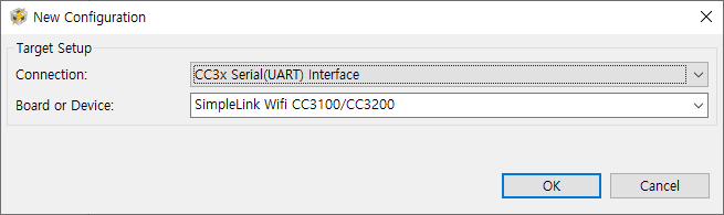

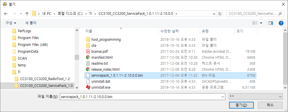

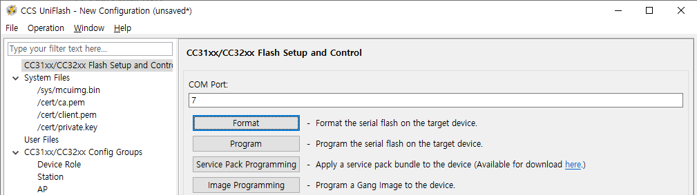

3. Format and Service Pack Programming through 'CCS Uniflash'
[17:25:49] Begin Format operation.
[17:25:50] INFO: > Executing Operation: Connect
[17:25:52] INFO: setting break signal
[17:25:52] INFO: connection succeeded
[17:25:52] INFO: getting storage list
[17:25:52] INFO: > Executing Operation: Init
[17:25:52] INFO: reading version info
[17:25:52] INFO: DEVICE CC3200 ES1.33
[17:25:53] INFO: reading version info
[17:25:55] INFO: > Executing Operation: Format
[17:25:55] INFO: Erase storage SFLASH
[17:25:56] INFO: erase storage succeeded
[17:25:56] INFO: erase storage completed
[17:25:56] INFO: > Executing Operation: Disconnect
[17:25:56] Operation Format returned.
[17:27:31] Begin ServicePackProgramming operation.
[17:27:32] INFO: > Executing Operation: Connect
[17:27:34] INFO: setting break signal
[17:27:35] INFO: detecting FTDI for device reset
[17:27:36] INFO: connection succeeded
[17:27:36] INFO: getting storage list
[17:27:36] INFO: > Executing Operation: ServicePackProgramming
[17:27:36] INFO: Path to the service pack file: C:/TI/CC3100_CC3200_ServicePack_1.0.1.11-2.10.0.0/servicepack_1.0.1.11-2.10.0.0.bin
[17:27:36] INFO: reading version info
[17:27:36] INFO: CC3200R Device detected.
[17:27:36] INFO: NWP/MAC/PHY Version from Service Pack:
[17:27:36] INFO: NWP Patch version: 2.10.0.0
[17:27:36] INFO: MAC Patch version: 1.5.0.2
[17:27:36] INFO: PHY Patch version: 1.0.3.37
[17:27:36] INFO: DEVICE CC3200 ES1.33
[17:27:37] INFO: reading version info
[17:27:39] INFO: Downloading file "/sys/servicepack.ucf" with size 33700
[17:27:42] INFO:
New Token is 0x2C6D35AE
[17:27:42] INFO: Download complete
[17:27:42] INFO: > Executing Operation: Disconnect
[17:27:42] Operation ServicePackProgramming returned.

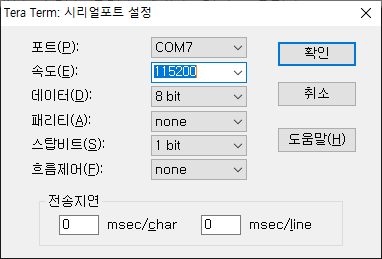

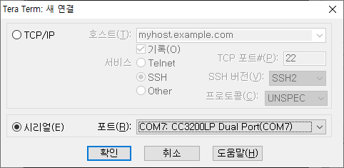

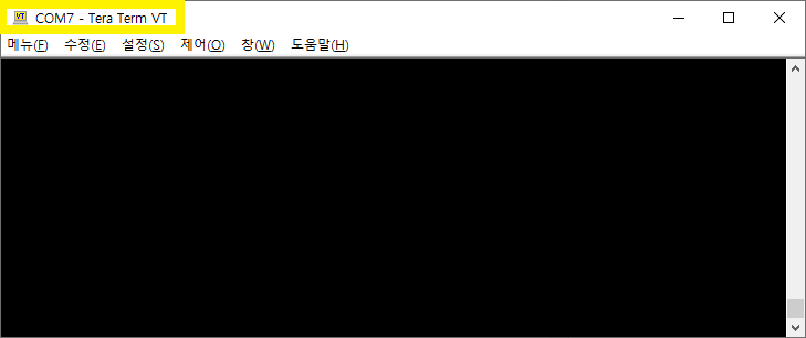

5. Open 'Tera Term' and setting
6. Press 'debug button' in IAR

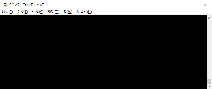

7. Finally Tera Term Screen doesn't show anything.
What is the matter??? Plz Help :(

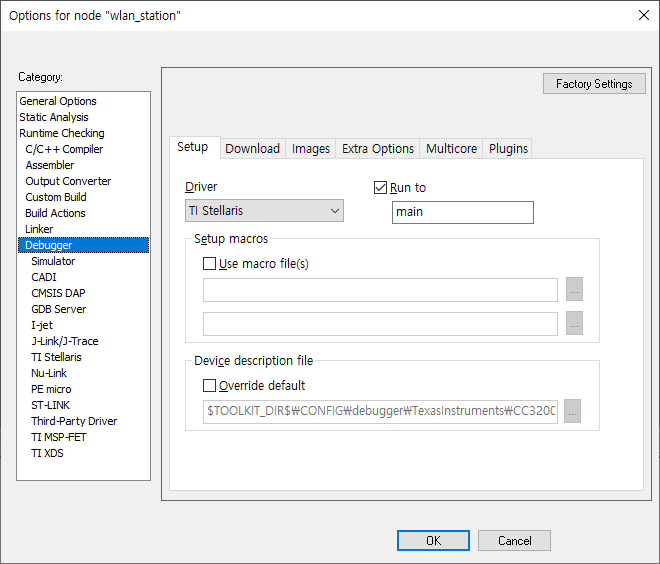

    After you press the green button to download and debug, the application should be halted at the beginning of main. Please make sure you press "Go (F5)" (white button with triangle in it).
    I just checked and this appears to be working for me following the exact instructions you are following. I don't think NOTERM is defined by default, so you should be good there.
    Ben M
  • Hi, im late because im doing another work for project.
    by the way,
    i used the button "make and debugging" in IAR
    the function is automatically doing "go"
    when i check the "go" button at my problem case,
    the button already pressed (= on)
    Thx
    I would expect that the system would halt at the start of main based on the default settings you are showing. Can you check why this is not happening?
    Ben M

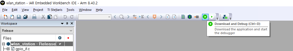

    Can you share a picture of your screen (the IAR GUI) after you press the "Download and Debug" button?
    The printout that you see in the Debug Log section of the IDE looks correct -
    Mon Nov 25, 2019 16:15:33: Initial reset was performed
    Mon Nov 25, 2019 16:15:34: 38868 bytes downloaded (34.20 Kbytes/sec)
    Mon Nov 25, 2019 16:15:34: Loaded debugee: C:\ti_2\CC3200SDK_1.3.0\cc3200-sdk\example\getting_started_with_wlan_station\ewarm\Release\Exe\wlan_station.out
    Mon Nov 25, 2019 16:15:34: Software reset was performed
    Mon Nov 25, 2019 16:15:34: Target reset
    In the window with the "main.c" source code, it should show a green arrow by "void main()" indicating that the application has been loaded and the processor is halted at the beginning of the main function.
    Like this -
    Do you see that?
    If not, was your serial terminal application (Tera Term) connected to the LaunchPad COM port before you pressed the Download and Debug button?
    That can cause a conflict between the debugger and the serial output. Please try disconnecting Tera Term from the COM port before you try to debug.
