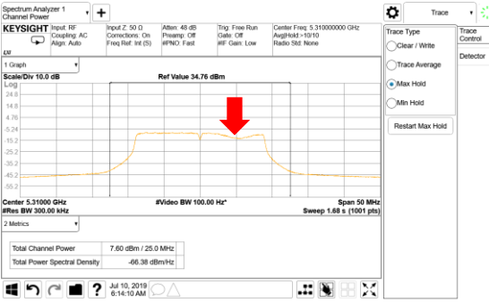

Our partner has performed measurements on the 5GHz bands. Unusual artefacts were observed. While testing against the IEEE802.11n specification, it failed. On the picture below, we can observe a dip in the middle of band 60.
Same observation were made on band 62 and 64.
Then, our partner checked band 60 against IEEE802.11n, the result was a fail. The dip was too consequent and the spectrum was too round.
On my side, I couldn't observe the dip. But I performed the measurement on another device with most probably another SW and other settings. I'm not equipped to test against IEEE802.11n. I suspect that it has something to do with the setting of WL1837MOD.
Did you already observe such behaviors? What are your recommendations?
Thanks for helping.
