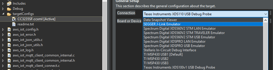

  • Fair points.  I will not use the term "flash"; it looks like the term that you guys use is "memory load".

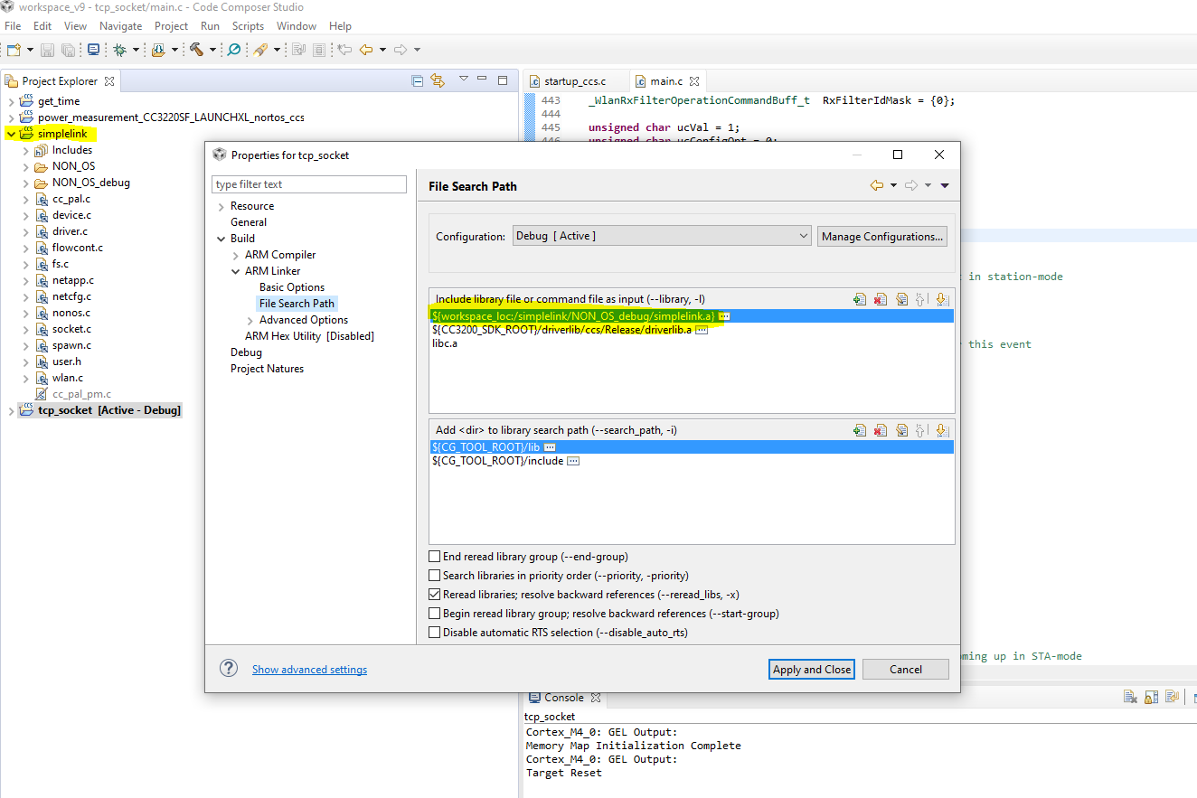

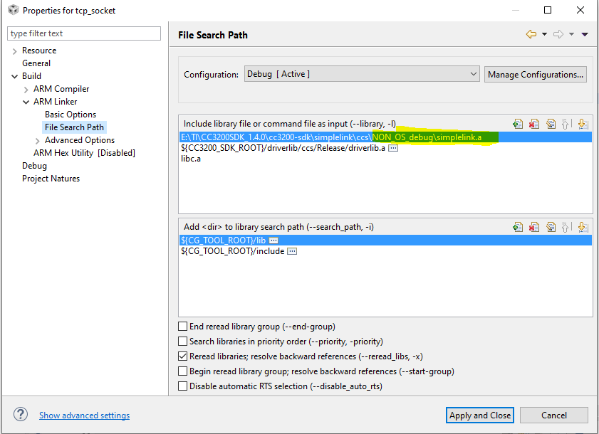

    I took a step back, installed CCS, and tried to debug the TCP example for the CC3200, with the SEGGER JLink target, using the debug library, as advised in this thread:
    However, it is hanging in the sl_Start call within ConfigureSimpleLinkToDefaultState call which is the exact same thing that's happening when I try to debug from outside of CCS.
    Can you please verify that the TCP example with no-os does/does not debug on your end?  Am I forgetting to do something?
    ALSO: After waiting a long time, I get the following error at my UART output after sl_Start hangs for a long time:
    I think whatever gets this to work from within CCS will also solve my non-CCS issues.  Any advice?
  • I also tried just importing the Simplelink CCS project into CCS and building with target Debug (as suggested in the above linked thread).  Verified simplelink.a was built (timestamp), and it still doesn't work.

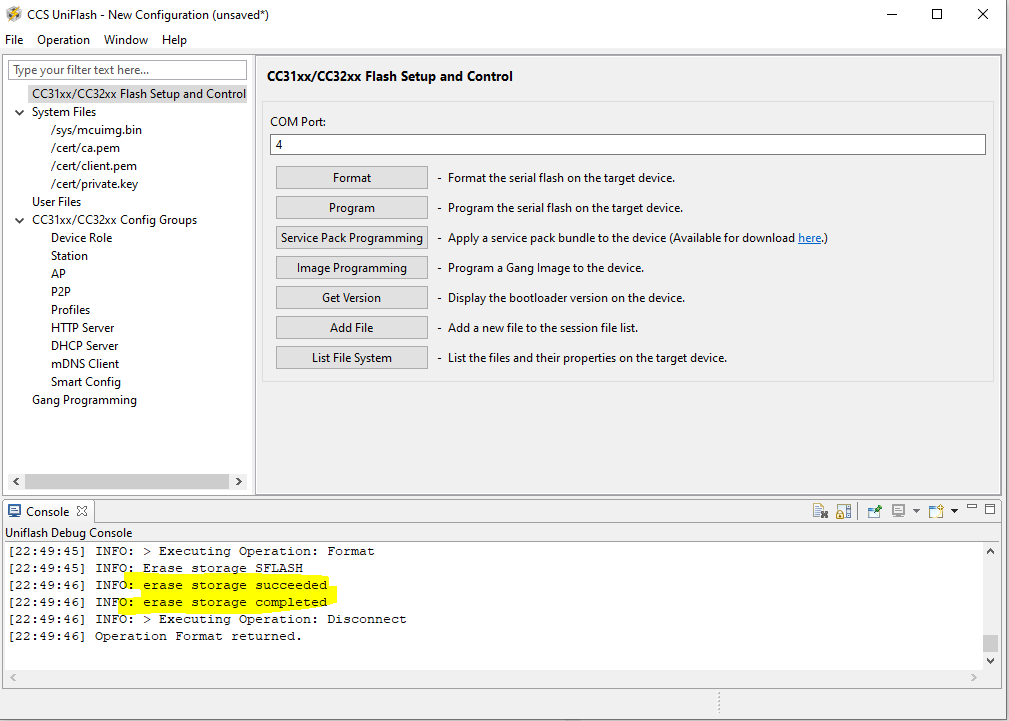

    • If you want to know if you have same issue same as described above, please follow steps (all steps are important):
      1. Connect your hardware and debug probe
      2. Using Uniflash software perform format of sFlash, upload of latest Servicepack, do not upload your MCU binary
      3. After successfully SP programming set proper SOP mode (e.g. 0-0-0) and restart your board (use physical reset of CC3200)
      4. Try connect your debug session
      5. If you will be able goes through sl_Start(), that you have a same issue as is described above thread.

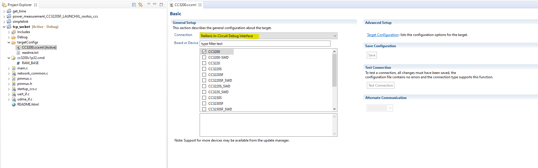

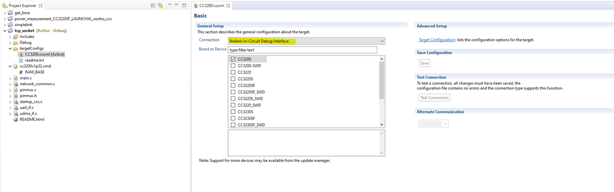

    It appears the default debugger on the LaunchXL board is the Stellaris in circuit debugger, is that right?
    I'm a little confused about this.  This must not be the right part.  Which connection should I choose, because this doesn't work.
    The part number on the package of the chip is CC3200R1.  Do you need the other numbers?
    Please provide photo of your LaunchPad when you try to use on-boad debugger. I want to check your jumpers settings.
    • settings of your target configuration in CCS looks OK
    • did you changed SOP mode and press restart button after Uniflash programming?
    Jan
  • Good catch.  My external SEGGER debugger was still plugged in.  I reattached the jumpers across TDO, TDI, TMS and TCK and the Stellaris debugger works.
    It successfully makes it past the sl_Start call.
