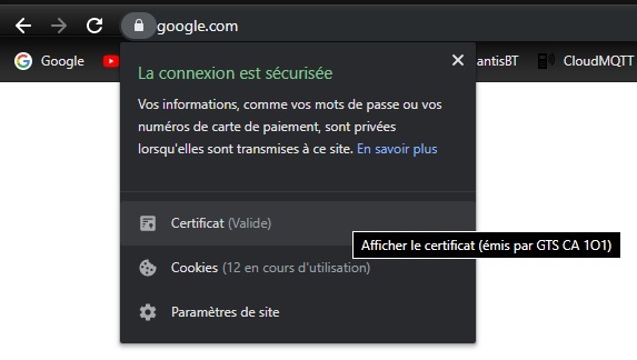

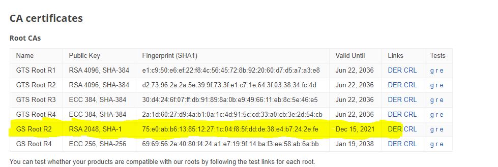

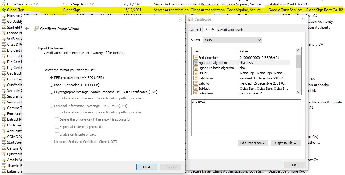

I downloaded the CA certificate like this way (from windows 10 machine):

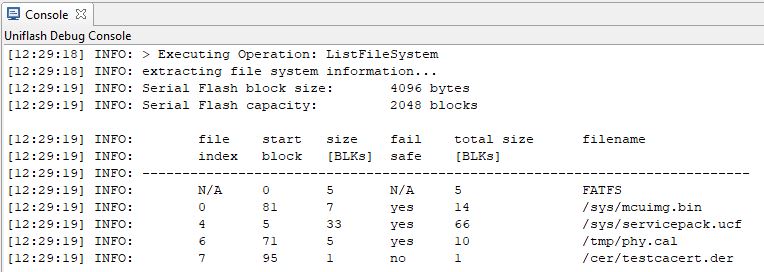

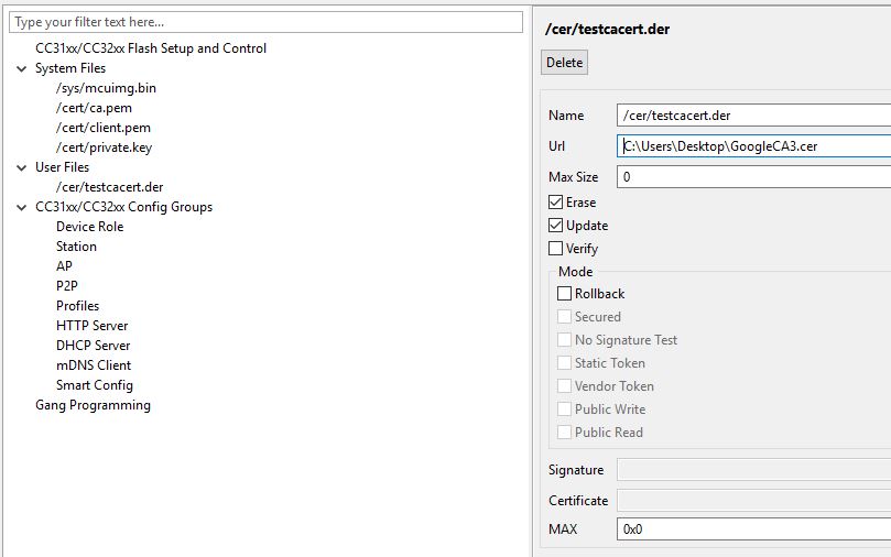

Then, I loaded the file using UniFlash:
