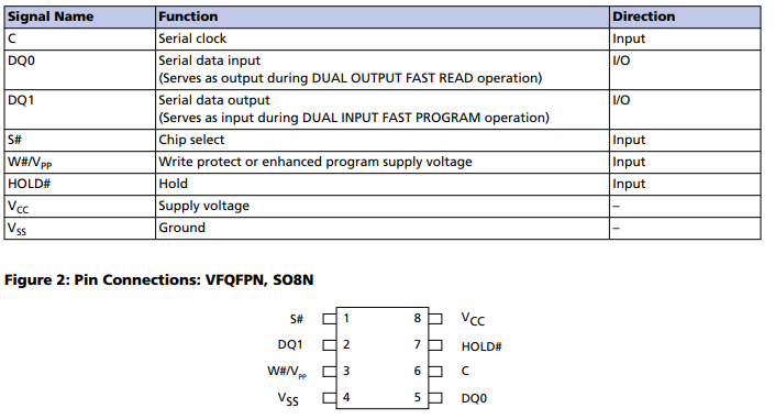

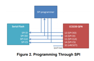

Hi
I am building a custom design based on CC3200 reference desgin. According to the production line guide, serial flash can be programmed either over UART or directly through SPI. I am quite interested in the SPI method. Would it be possible to use a programmer (such as TL886II) and connect a ICSP cable to the serial flash? I didn't see a ICSP header on the CC3200 Launchpad, and my impression of ICSP pins is not quite the same as SPI pins, so I would like to confirm if ICSP pins can be used to connect to the SPI pins of serial flash (M25PX80).
