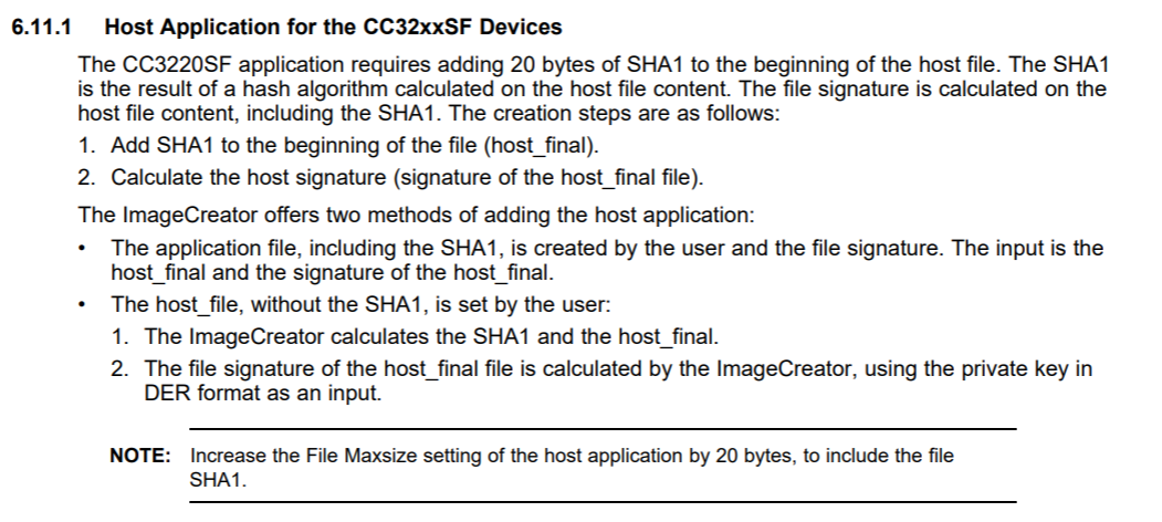

    The customer found that using Uniflash 5.2 download .bin that compiled by IAR to LAUNCHXL-CC3235S is normal, but they want to use CC3235SF.
    They guess below is the reason, but they don't know how to resolve it.
    So could you please give some suggestions?
    Thanks a lot!

    According to swru469f  6.11.1. for CC32xxSF devices, 20 bytes sha1 digest been needed to add to host file. But in Uniflash 5.2.0, after we add the host.bin file in simple mode, we found a 32 bytes sha256 digest added automatically. even when we use CLI to add the mcu file, the 32 bytes sha256 also added automatically. when we add the 20 bytes sha1 by using openssl, we have no method to add the .bin file into the project without the 32 bytes sha256.
           This 32 bytes sha256 digest cause my CC3235SF LAUNCHXL not able to reboot according to the swru469f 6.11.1.
    My CC3235S LAUNCHXL works well in same operation.
          Could you provide more information about this bug and how to solve the problem with some method?
    CC3220 devices use SHA1 to verify the MCU image. CC3235 uses SHA2 by default so the behavior you’re seeing is expected. I'm still not sure what problem you are experiencing. Could you describe in detail what the exact problem is? What is the customer trying to accomplish?

  • Are you sure CC3235SF using SHA2?
    I use the uniflash demo project of OOB (example from SDK), it works well with my CC3235SF LAUNCHXL, and I check the file mcuflashimg.bin, it is SHA1.
    I have test same project with my CC3235S LANUCHXL, it works well. But it not for my CC3235SF LAUNCHXL. I am sure I have change the device between CC3235SF and CC3235S with different LAUNCHXL, So I think the problem is SHA2 or SHA1.
