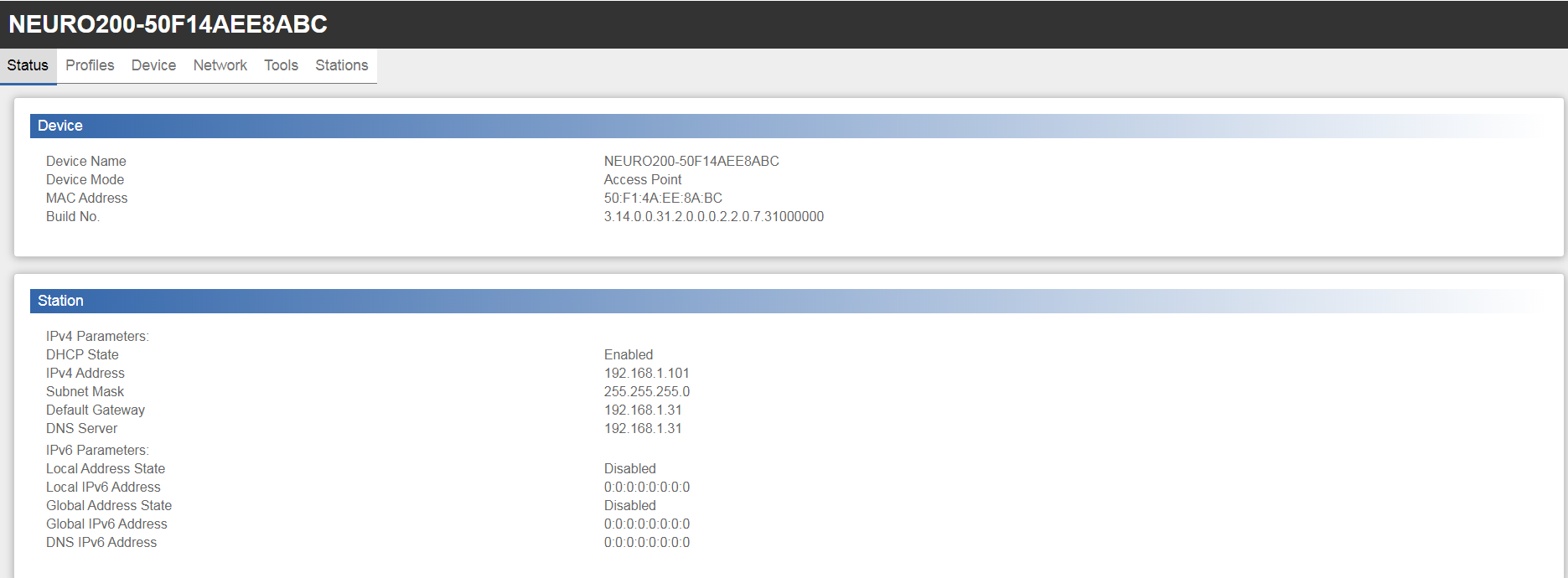

    The issue is the following:
    1) Setup: TMS570LC43 (nonos) with CC3120MOD using SPI
    2) The setup was tested with the original servicepack present on the CC3120MOD. All Simplelink API calls return successfully.
    3) In order to update the servicepack using the host API, I use the function sl_FsWrite() to write the .ucf file to "/sys/servicepack.ucf". The file is transfered in chunks by TCP socket.
    3) The file is closed successfully using sl_FSClose() and the key (".ucf.signed.bin")
    4) After the device is restarted, call to sl_DeviceGet() returns the newly installed versions. Also, if the device is started as an accesspoint mode with the default http server, the new versions are displayed.
    5) The issue occurs here: at this point, calls to sl_wlanSet() returns SL_ERROR_INVALID_PARAM.
    Is this a corrcect way to update the servicepack on the CC3120MOD using the host API ? Is there a better way to do it ?
    Georges Brown.

    Meanwhile, I would just like mention again that after the servicepack file is successfuly written and closed and the default HTTP server is used, it is possible to connect to the device with a web browser:
    The Build No. displays the expected versions.
    When I go in the device tab and try to change the SSID, it does not work. I get the fooling error in the browser: ERR_CONNECTION_REFUSED
    If the NWP is pending commit, would such a behaviour appen ?
    Than you,
    Georges Brown
