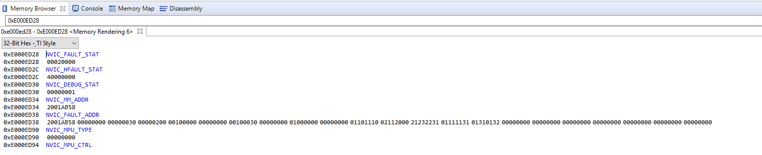

  • Hi Michael,
    Thanks a lot for the suggestion. Looking at the debugger's value I can see the following:
    I can see also that sometimes when the program hangs, I get an HW exception at  system\kernel\tirtos\packages\ti\sysbios\family\m3\Hwi.c.
    What does this imply?
    Thanks a lot!
    Artemis
  • Hi Artemis,
    You can take a look at the end of chapter 3 of the CC3220 TRM to decode those registers: http://www.ti.com/lit/swru465
    Taking a look for you, FAULT_STAT of 0x20000 = INVSTAT fault, HFAULT_STAT 0x40000000 = forced hard fault has occurred. Those two registers together mean that as your program was running, an instruction was executed that attempted to use the EPSR incorrectly. This is almost always due to memory corruption of some sort resulting in garbage data being executed as an instruction. As the TRM explains, you can check the PC value that is stacked for return from the Hwi loop to see which exact caused the failure. However, that's not a very useful exercise since the instruction is almost certainly a corrupt instruction that's meaningless.

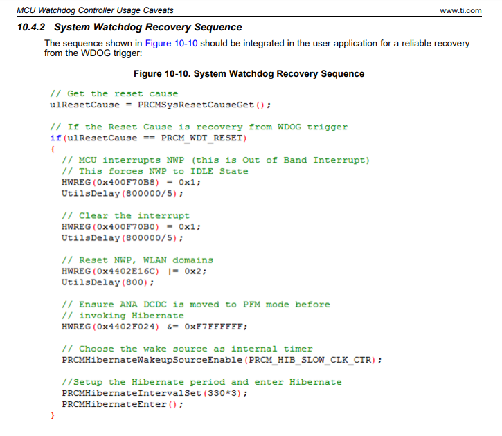

  • Hey Michael,
    Thanks for the suggestion. Looking at the PC value its a bit difficult to debug, but it seems that some instruction correlated to the NWP trying to connect again to the WiFi. I will also check the stack and come back to you about it.
    Also, for recovering from the watchdog reset, is this necessary and sufficient to be included at the start of the code, as the manual suggests? (Please see attached figure below p.360)
    Thanks again,
    Artemis
  • Hi Artemis,
    As I know that this code is not mandatory for CC3220 and CC3235 devices. It is mandatory for CC3200 devices only. But don't ask my, why is inside CC3220 and CC3235 TRM.
    Jan
