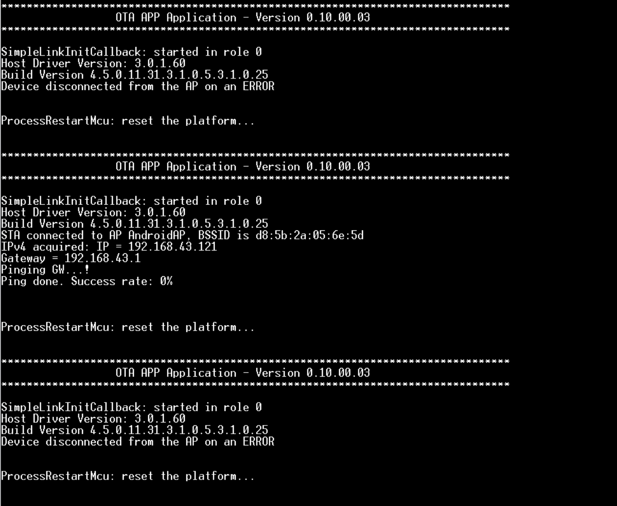

    I was following the steps they mentioned in http://dev.ti.com/tirex/explore/node?node=ACE5ggZRybEJNZUcnzc3ww__fc2e6sr__LATEST but I am having some issues. As per the documentation if I press SW2 button then the output should be like the following
    But I  am always getting the following messages.
    Is there some configuration I am missing.
    Thank you.
    Venkatesh.
  • Hi Venkatesh,
    Seems that you are having basic problem with the connection to the local network (i.e. to your access point) before the OTA can start.
    Have you been able to connect the same AP (and ping it or exchanging data) with other example?
    Br,
    Kobi

  • Hi Venkatesh,
    The OTA configuration seems ok (of course, it should correspond to your github project).
    I've noticed that you have an extra space in the OTA_VENDOR_ROOT_DIR, you should remove it.
    But again, you current issue is not about the OTA, but about the basic wifi connection.
    You can use the NetworkTerminal example to try connecting to your access point.
    You can also check other simple example (such as the "httpget") to make sure you can access remote (internet) servers.
    Once you know how to enable the connectivity, you will be able to test the OTA.

  • Hallo Kobi,
    Thank you for the Info. Icould fix that issue. But currently I am getting an error while connecting to the socket. The following is the response I am getting.
    I used the git hub configurations as mentioned above.What else could be the problem?
    Thank you.
    Best Regards
    venkatesh vasanthapu
  • The -456 means one of the following:
    1. The root CA certificate is not found in the path you've provided in OTA_SERVER_ROOT_CA_CERT (make sure the full path of the file matches exactly to the content of your file system).
    2. The root CA file in the file system has a bad format. Please make sure you are providing a valid DER formatted file (a DER file can be opened in Windows and you can inspect the content) or PEM file.The best way is to download the certificate from your computer (in Windows, open the certificate manager by pressing windows+R to open the "Run..." dialog, then typing in "certlm.msc" and go to "Trusted Root Certification Authorities/Cerificates" and look for the required root CA. When you open the file, go to "Details" where you can copy the file).
    br
    Kobi
  • Hallo Kobi,
    Thank you for the Info. It was a problem with the OTA_SERVER_ROOT_CA_CERT. I was able to do the OAT for the sample project mentioned in the http://dev.ti.com/tirex/explore/node?node=ACE5ggZRybEJNZUcnzc3ww__fc2e6sr__LATEST  using GIt.
