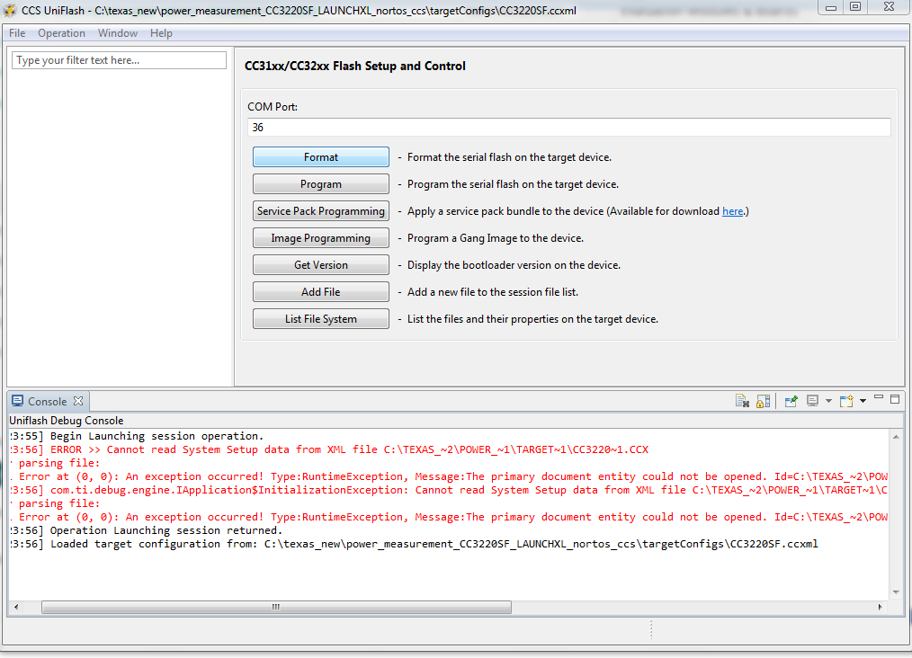

I have downloaded UNIFLASH v3.4.1.When I am trying to load the Application to the target device, I am getting the following error.Please help me with this.

CC3220 devices are not supported by Uniflash 3.4. You need to use Uniflash 4.6 or 5.x.
At this answer I already provide you information which version you need to use. It will be highly appreciated if you follow advices which was already provided to you and not post same questions again. Thank you.
