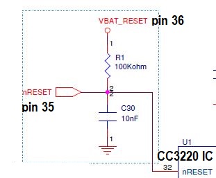

  • Dattaguru,
    Please provide the gerbers as well. I've reviewed the schematic. See my feedback below:
    1. The matching network are the same values as our reference design. These will vary on your own board, so please perform antenna matching to ensure 50 ohm impedance.
    2. There is a 100k resistor and 10nF cap RC network internal to the module that is tied to the module pins 35 and 36 and the CC3220 IC's reset pin 32 (see below). So you can eliminate R19 and C7, tie pin 36 to VCC, and keep the switch connected to pin35.
    3. As Jan already mentioned, there are pull down resistors tied to the SOP pins internal to the module, so you can remove R1, R2, and R3. R4 is still required to pull the SOP pins high.
    4. Add 100k pull up resistors to pins 46 and 47. I see there are already provisions for this, as Jan said.
    5. As Jan mentioned, there is already a filter internal to the module.
    6. Jan's comment on pin52 actually applies to the CC3120MOD. You can use this pin as a GPIO or UART.
    BR,
    Seong
