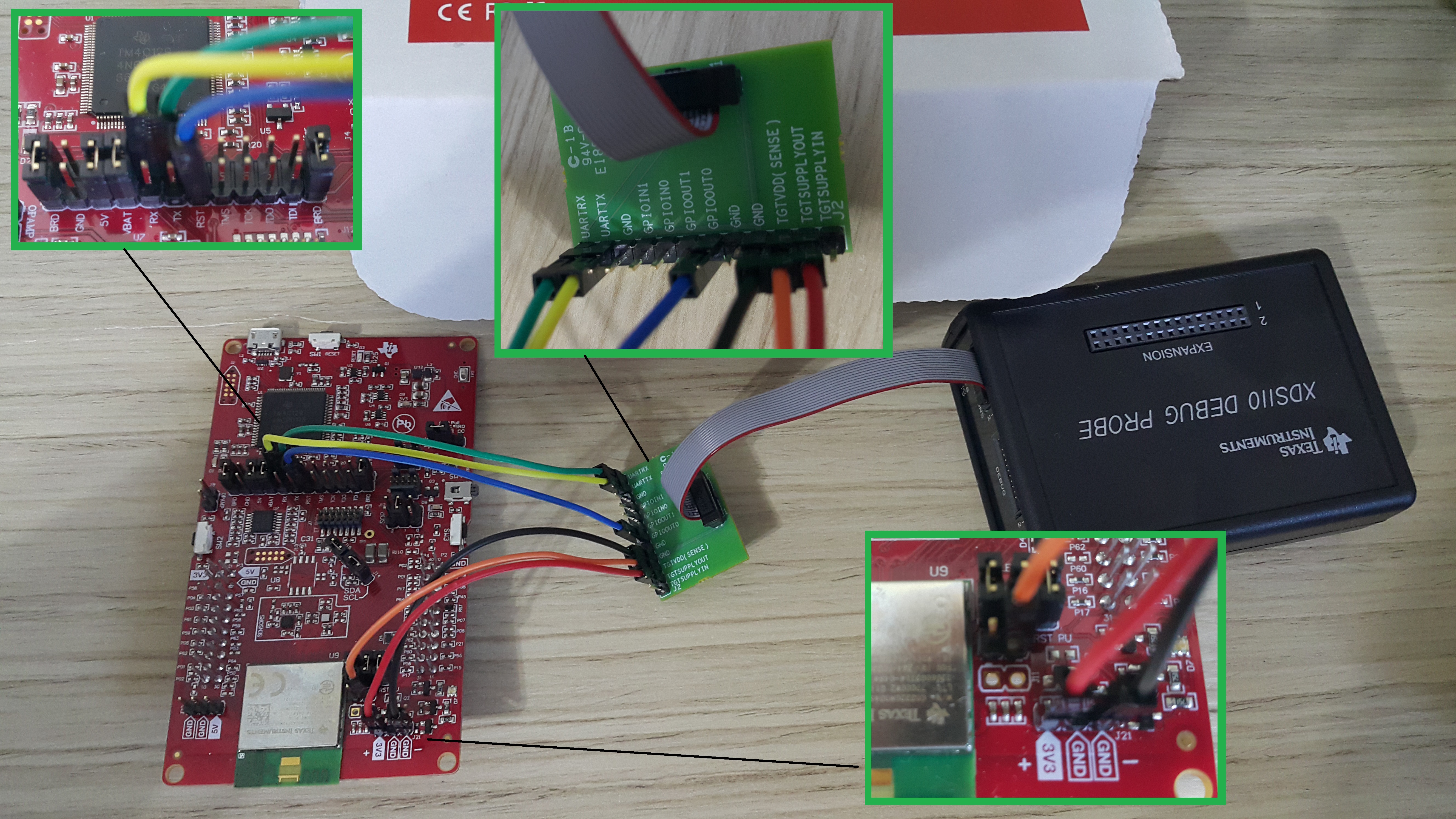

I made the connections with a CC3220MODASF LaunchPad to illustrate.
Description of cable colors:
Black: GND;
Red: TGTSUPPLYOUT -> VBATs;
Orange: TGTVDD(SENSE) -> VBATs;
Blue: GPIOOUT0 -> nRESET;
Yellow: UARTTX -> GPIO02;
Green: UARTRX -> GPIO01.

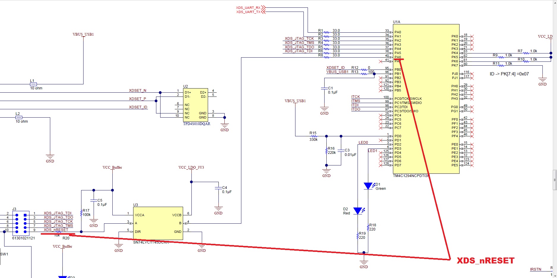

    2 - I checked the schematic diagram of the CC3220MODASF LaunchPad,
    as shown in the image below, the RESET pin on the CC3220 is
    controlled by the PA6 pin (# 40) of the TM4C1294NCPDTI3R
    processor. I was unable to find the schematic diagram of the
    XDS110 Probe to compare and find out if PA6 is GPIOOUT0 or
    GPIOOUT1. Is there a schematic diagram for the XDS110 Probe?
    Thanks a lot for the help.
    Yes, you can reflash a CC3220 from production to development. You do so by erasing the external serial flash, which is a step that Uniflash will perform for you automatically as part of the flashing process.
    Unfortunately the design files for the XDS110 are not public. I suggest you connect the XDS110 to your PC, run uniflash, and then monitor the GPIOout signals with a scope/logic analyzer/tool of your choice to see which one is toggled when you click "connect". Uniflash should auto-detect the cc3220 and then run attempt to connect, which will involve toggling the reset pin externally through GPIOout of the XDS110.

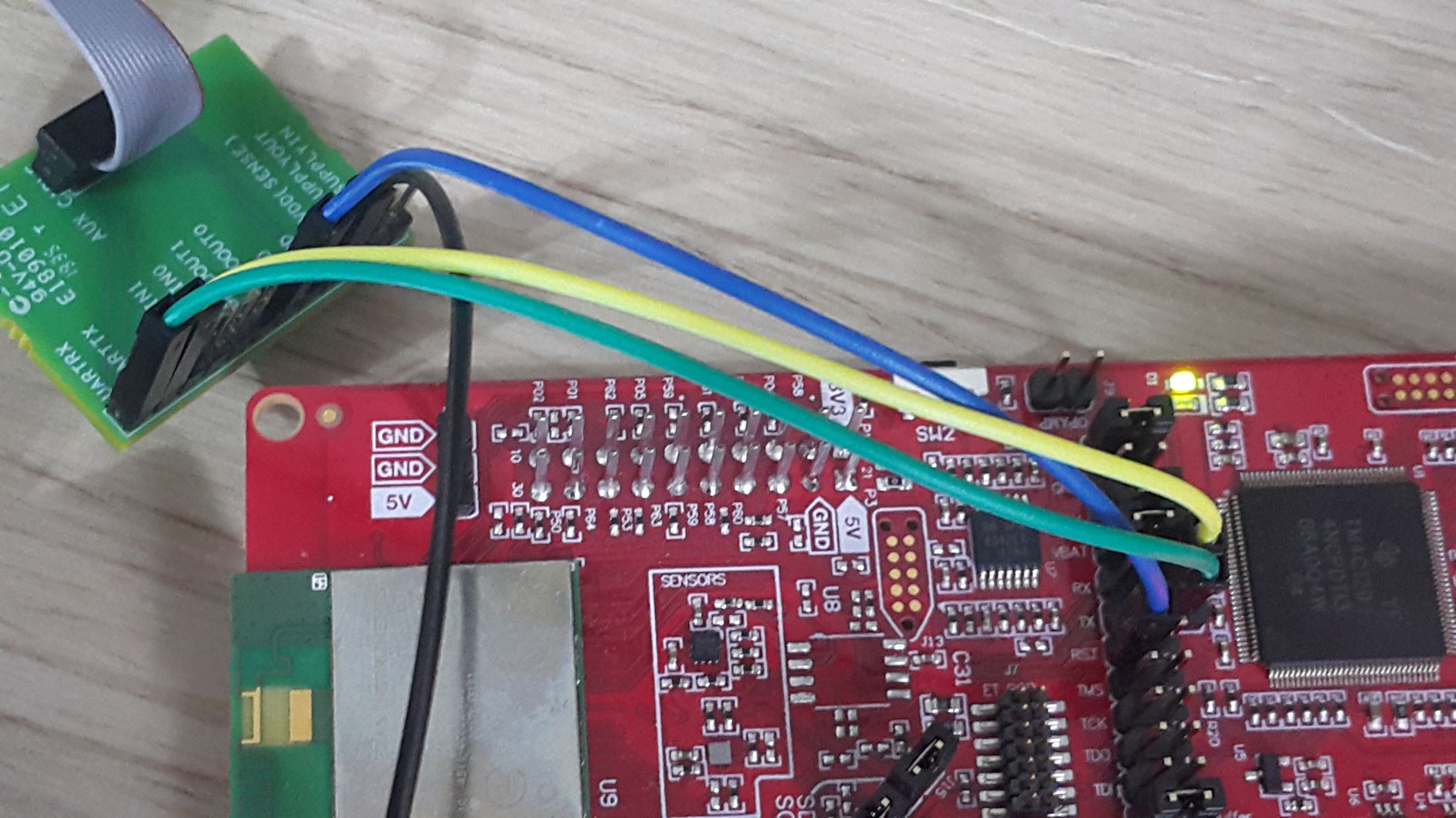

    1 - I made the connections between the LAUNCHCC3220MODASF board and the XDS110 probe (breakout board).
    1.1 - I removed the jumpers that had J6 (TX) and J5 (RX) from the LAUNCHCC3220MODASF board.
    I connected the UARTTX signal of the breakout board to the center pin of J5 (RX), yellow wire.
    I connected the UARTRX signal to the center pin of J6 (TX), green wire.
    1.2 - I removed all 5 J3 jumpers.
    I connected the GPIOOUT0 signal to the RST pin of J3, blue wire;
    I also tested with the GPIOOUT1 signal connected to RST.
    1.3 - I connected the breakout board ground (GND) with LAUNCHCC3220MODASF, black wire

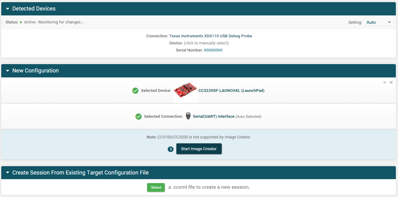

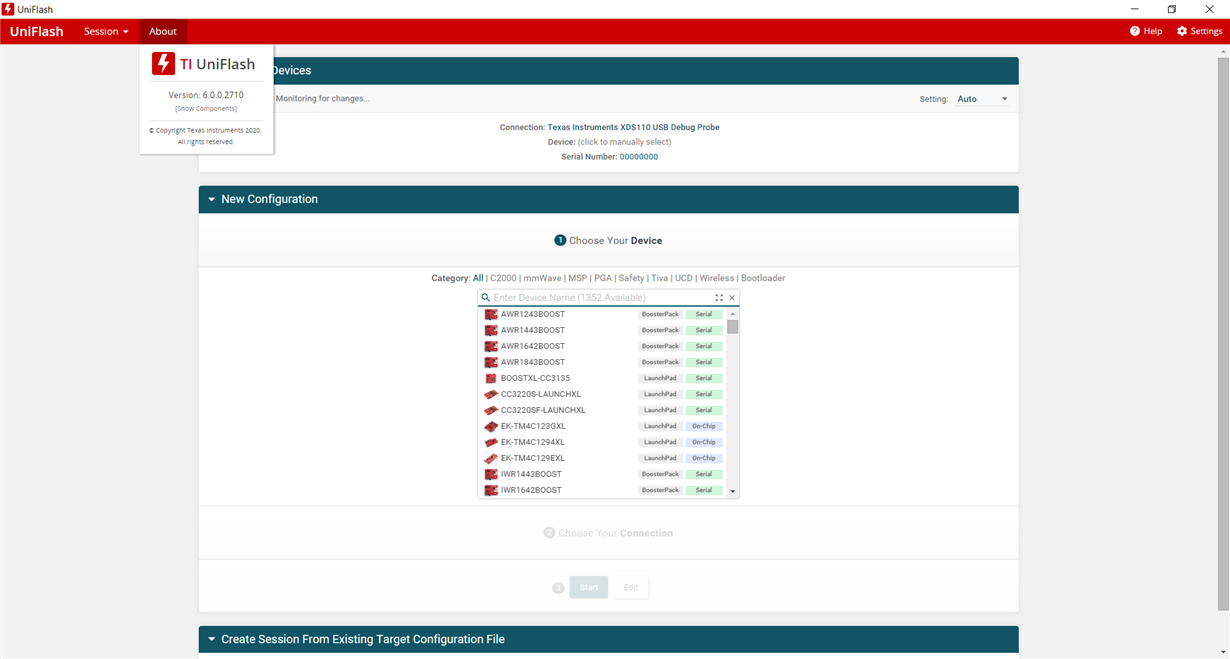

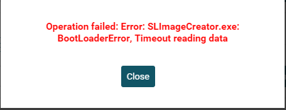

    2 - I ran the UniFlash program version 6.0.0.2710.
    3 - I chose CC3220SF-LAUNCHXL LaunchPad Serial.
    4 - The welcome screen appeared.
    5 - I chose to create a new project, filling in the options as shown below.
    6 - The Development Mode - Simple View screen appeared.
    7 - I pressed Connect, because I read somewhere that in Debug mode it is necessary to search the MAC address of the target.
    After a few seconds, the error message below appears.
    What am I doing wrong?
    I also tried to use the GPIOOUT1 signal connected to RST, but it didn't work either.
    I tried to change the target to CC3220SF (BOOTLOADER) Serial and I was also unsuccessful. I would like to take the opportunity to ask for an explanation of the device options indicated as "On-Chip" and "Serial".
    Thank you.
  • Hello Michael.
    Excuse me, in my previous post, I think I attached the wrong photo.
    I put a photo where the TX and RX connections are not crossed.
    As I was not getting results, I tried to invert the TX and RX connections between the probe and the lauchpad.
    I tested it both ways and was unsuccessful, when pressing "Connect" the same error message appears.
    This is the photo illustrating the connection with crossed TX and RX.
    Sorry for the mistake.
    The steps you are performing should be correct. A couple things to check though:
    1. What are your SOP pin settings? In order for Uniflash to be able to connect, the device bootloader needs to be placed into either flashing mode (SOP = 100) or functional 4WD mode (SOP = 010)
    2. Are you able to use a logic analyzer or scope to check the UART TX/RX lines + reset at the CC3220 EVM header pins? This will ensure allow us to see whether the XDS110 is sending the expected commands to the CC3220.
    Michael

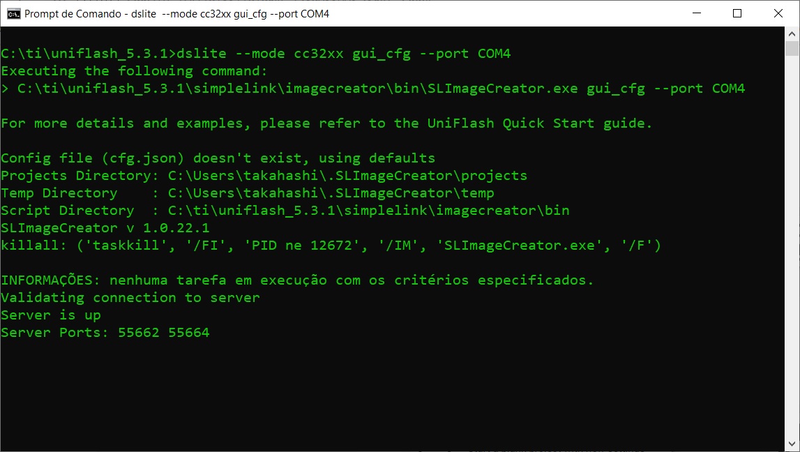

    I found a tip in a post and decided to try using the command prompt.

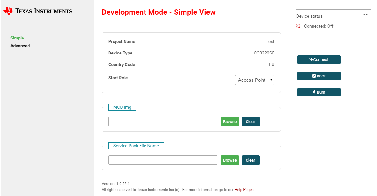

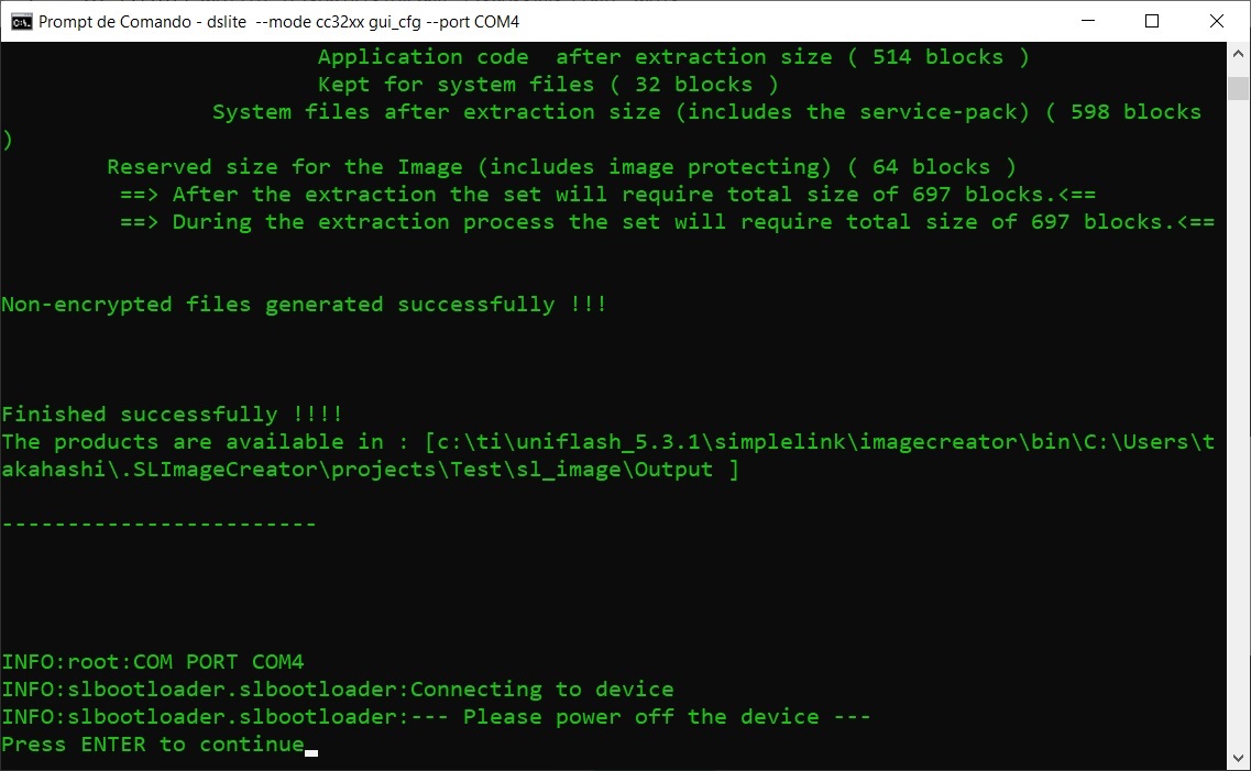

    1 - I opened a command prompt window in the UniFlash installation folder and ran the command: "dslite --mode cc32xx gui_cfg --port COM4", as shown in figure 1;
    Figure 1.
    2 - In my case, I used COM4, ​​as this is the number that is assigned to the port "XDS110 Class Application-User UART";

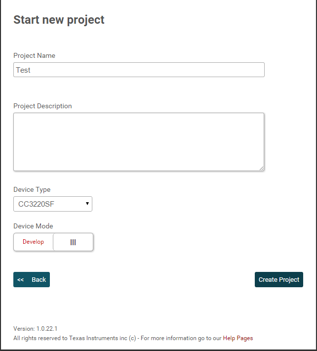

    3 - When executing the command, the command prompt displays the messages in figure 2 and a browser window appears, figure 3,
    presenting a type of UniFlash web interface;
    Figure 2.
    Figure 3.

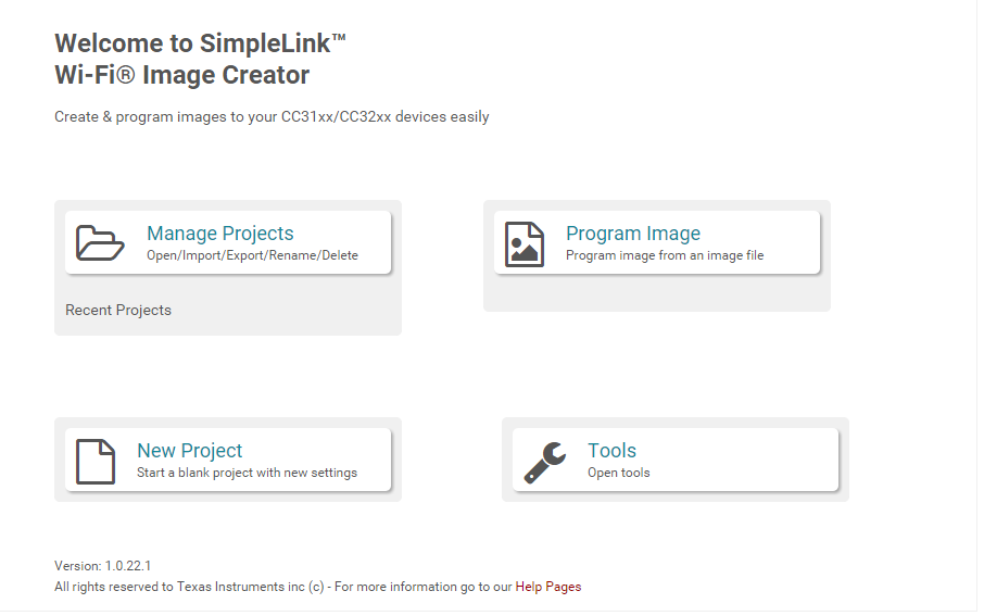

    4 - In the web interface window, I selected the "Test" project, which is probably the project I had previously created in the UniFlash program, see figure 4;
    Figure 4.

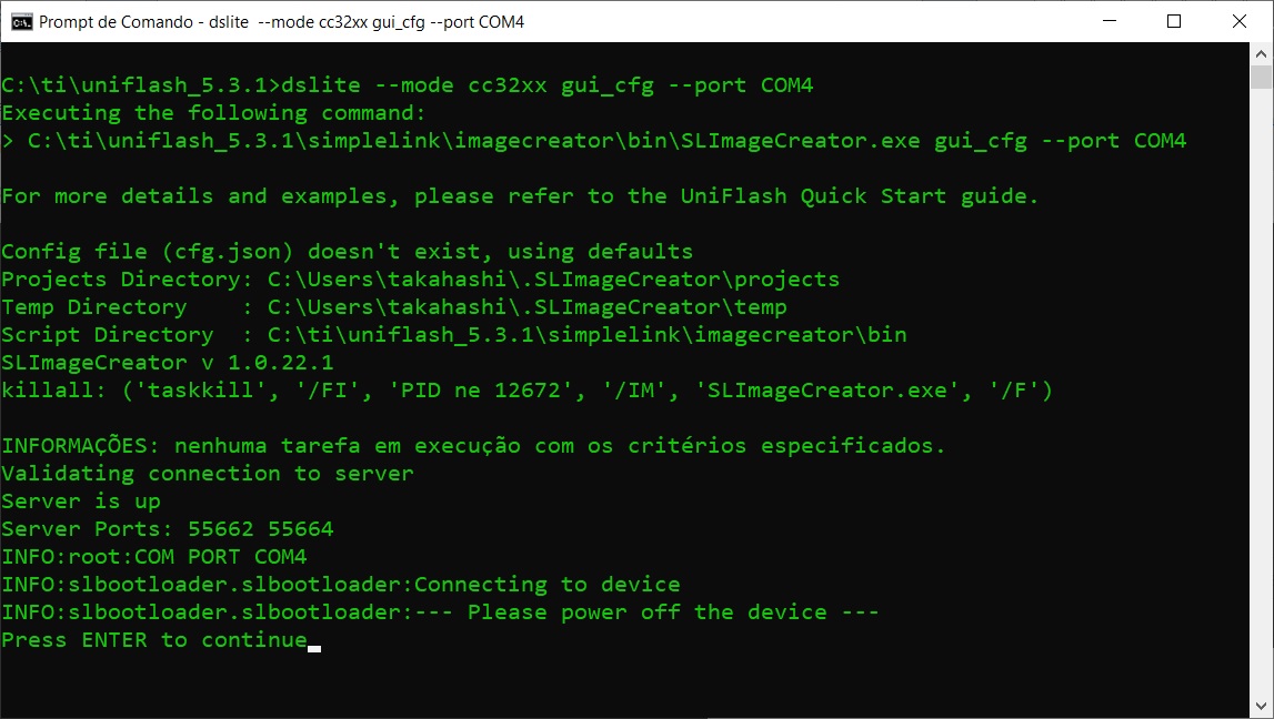

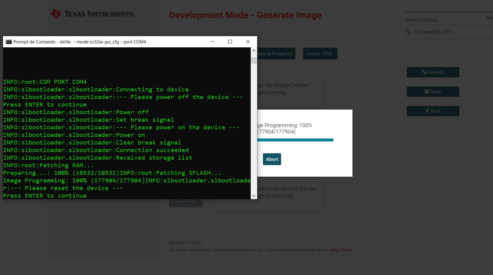

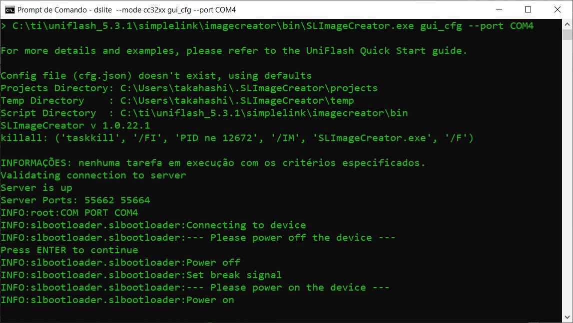

    5 - After selecting the Test project, I selected the "Connect" option. At the command prompt, I was asked to turn off the device, as shown in figure 5;
    Figure 5.
    6 - I disconnected the USB cable that powers my launchpad. I pressed ENTER and the command prompt advanced to figure 6;
    Figure 6.
    7 - I reconnected the USB cable to the lauchpad and on the web interface the device information appeared in the right corner, as shown in figure 7;
    Figure 7.

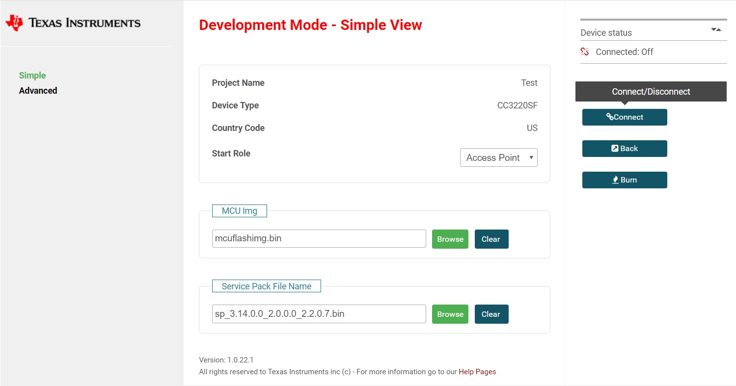

    8 - I was able to validate the UART communication between the XDS110 probe and the launchpad. I tried to flashing the project, pressing "Burn", showing the screen in figure 8;
    In my test, the MCU image is the bin file of the "Out Of Box of the CC3220" project and the Service Pack is the most recent version that I downloaded.
    Figure 8.
    9 - At the command prompt, the message appears again asking me to turn off the device, see figure 9;
    Figure 9.
    10 - I disconnected the USB cable again, press "ENTER" and everything ends as shown in figure 10.
    Figure 10.
