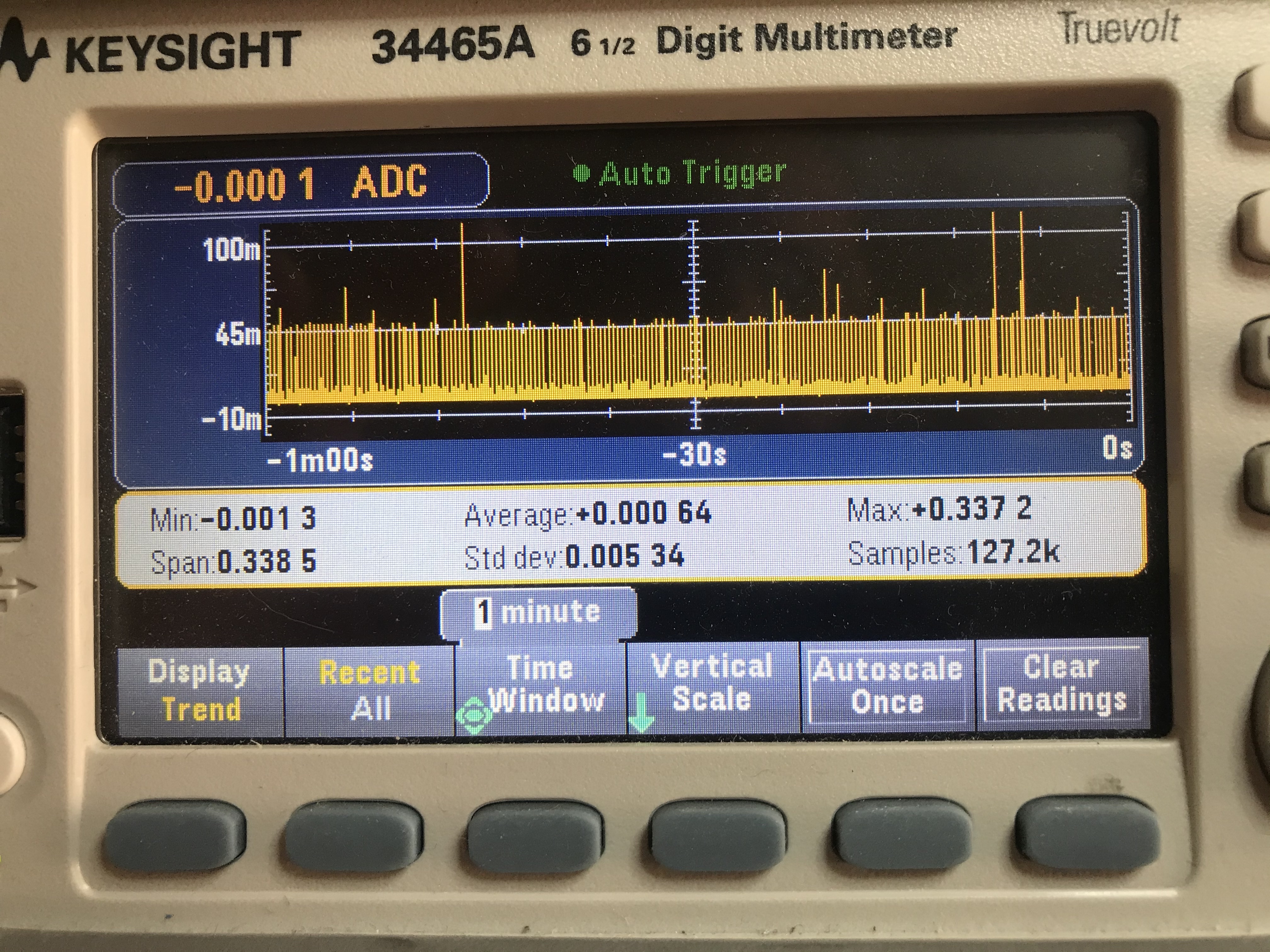

Hi folks,
I've been using the power_measurement example that comes with SimpleLink SDK and noticed that when I introduce a call to SNTP_getTime() the device doesn't seem to enter the low power state I expect. This one is most definitely a trap that I have fallen into and I assume I am missing something pretty basic here.
How do I maintain an Ultra Low Power state, assuming the TCP stack is kept on the Network Processor and the MCU only needs to wakeup to handle network events behind the TCP stack? I get the same outcome with FreeRTOS or TIRTOS, to illustrate this and with using SL_WLAN_IOT_LOW_POWER_POLICY:

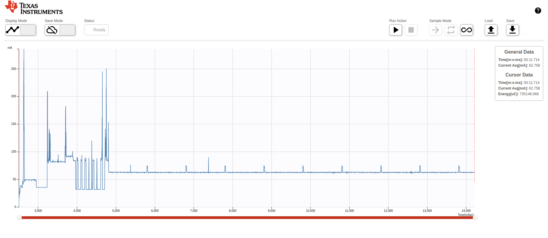

Without the call to SNTP_getTime()I get 640uA, which is great:
Adding a call to SNTP_getTime() and successfully receiving network time (graph after time sync is received, now 60mA steady):
Any pointers appreciated.
EDIT TO ORIGINAL POST: Please see further below, after investigating it appears a call to SlNetIfWifi_getConnectionStatus() creates this situation.
Will.

    That's exactly right, I've got this just after the call to time sync:
        while (1) {
            Power_enablePolicy();
            sleep(10);
    Is the device falling back to some other default power config? Even explicitly calling the power config with SL_WLAN_IOT_LOW_POWER_POLICY doesn't do anything.
    What am I missing?

    "Adding a call to SNTP_getTime() and successfully receiving network time (graph after time sync is received, now 60mA steady)"
    "I must stress, this is measured after successfully getting time and looping around Power_enablePolicy() / sleep()."

  • To further elaborate on this, and by reading and tracing through the SimpleLink SDK, this call is made in the chain:
    SlNetIfWifi_getConnectionStatus(NULL);
    which in turn calls
     sl_WlanGet(SL_WLAN_CONNECTION_INFO, &Opt, &Size, (uint8_t *)&connectionParams);
    which ultimately causes the device to never re-enter Low Power.
    By experimenting and by-passing the call for getting connection status and 'hacking" as follows, I can get the device to enter and maintain its lowest WiFi connected power state:
    int32_t _getConnectionStatus(void *ifContext) {
        UART_PRINT("Hacking connection is good");
        return 1;
    SlNetIfConfigWifi.ifGetConnectionStatus = _getConnectionStatus;
    Can you please provide some insight as to why this is and, how to correctly proceed if I am not using the SDK appropriately.
    Thanks.

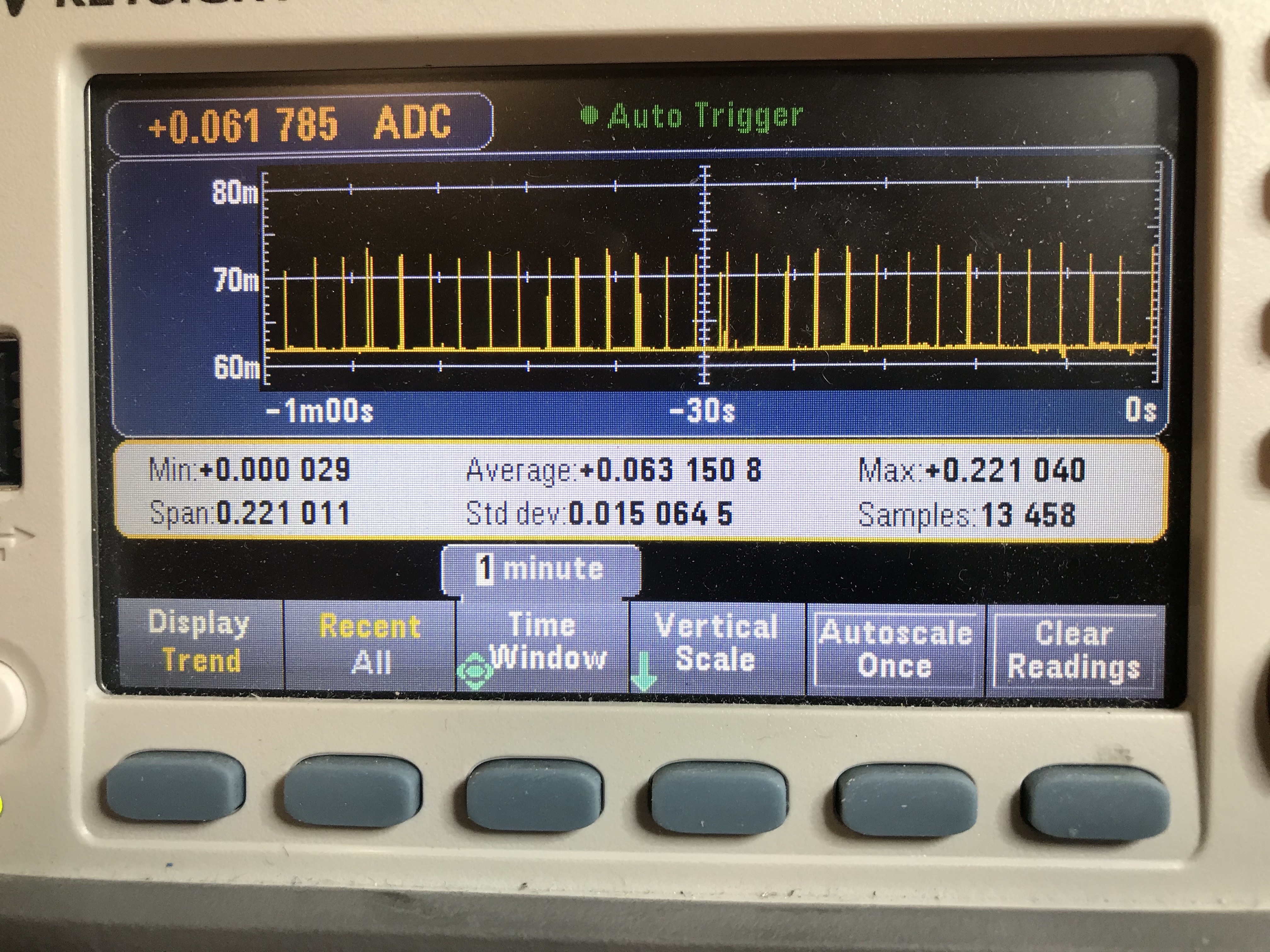

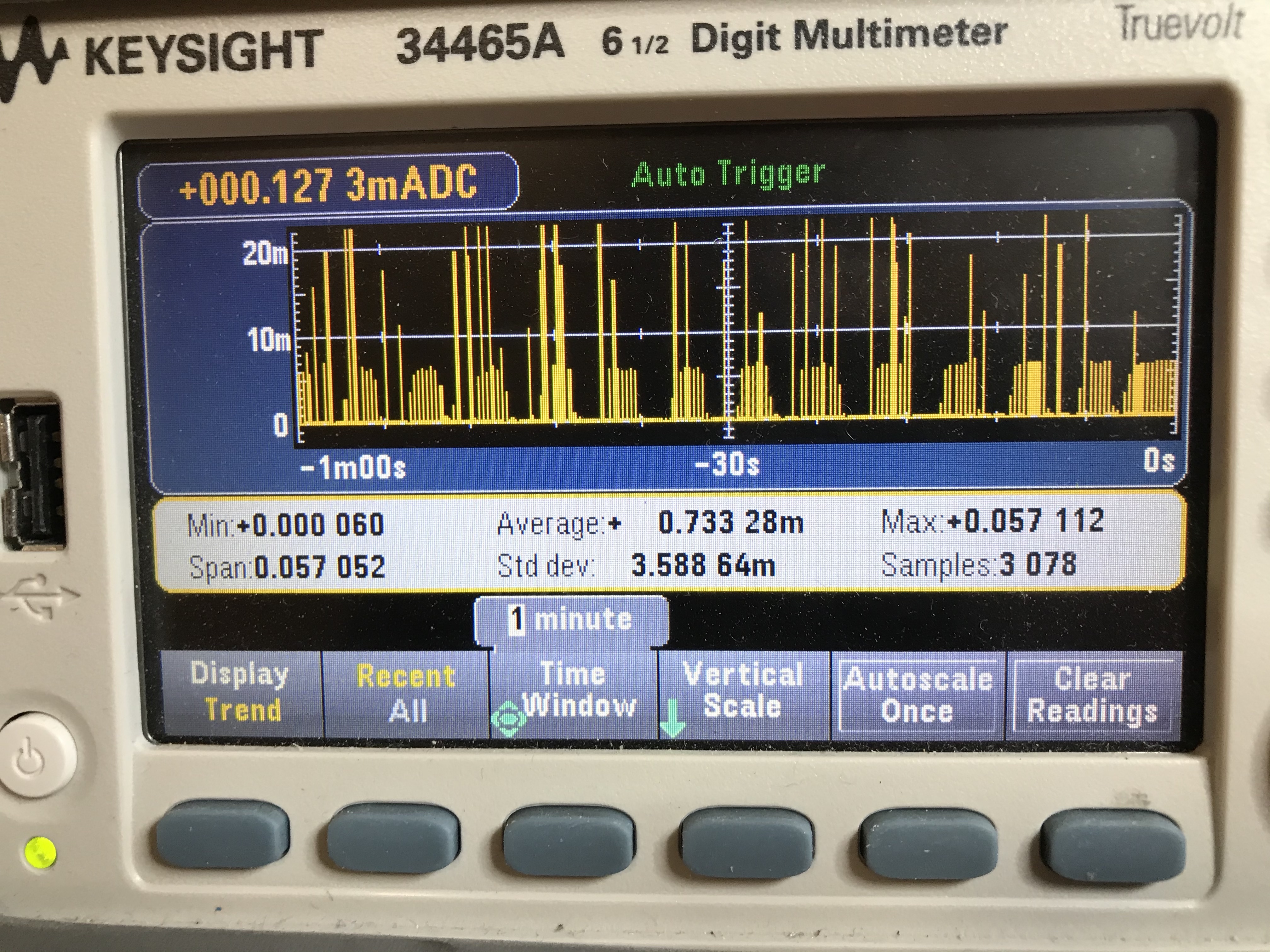

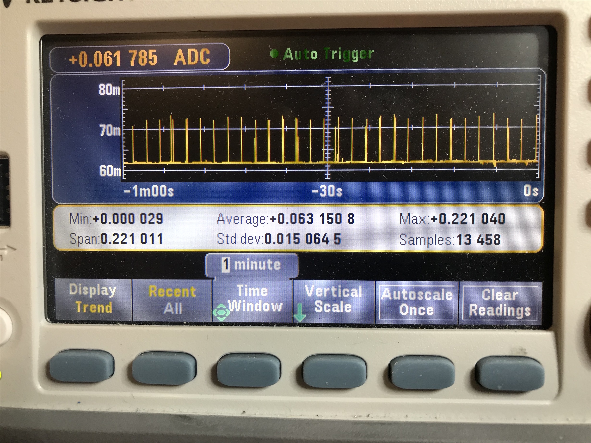

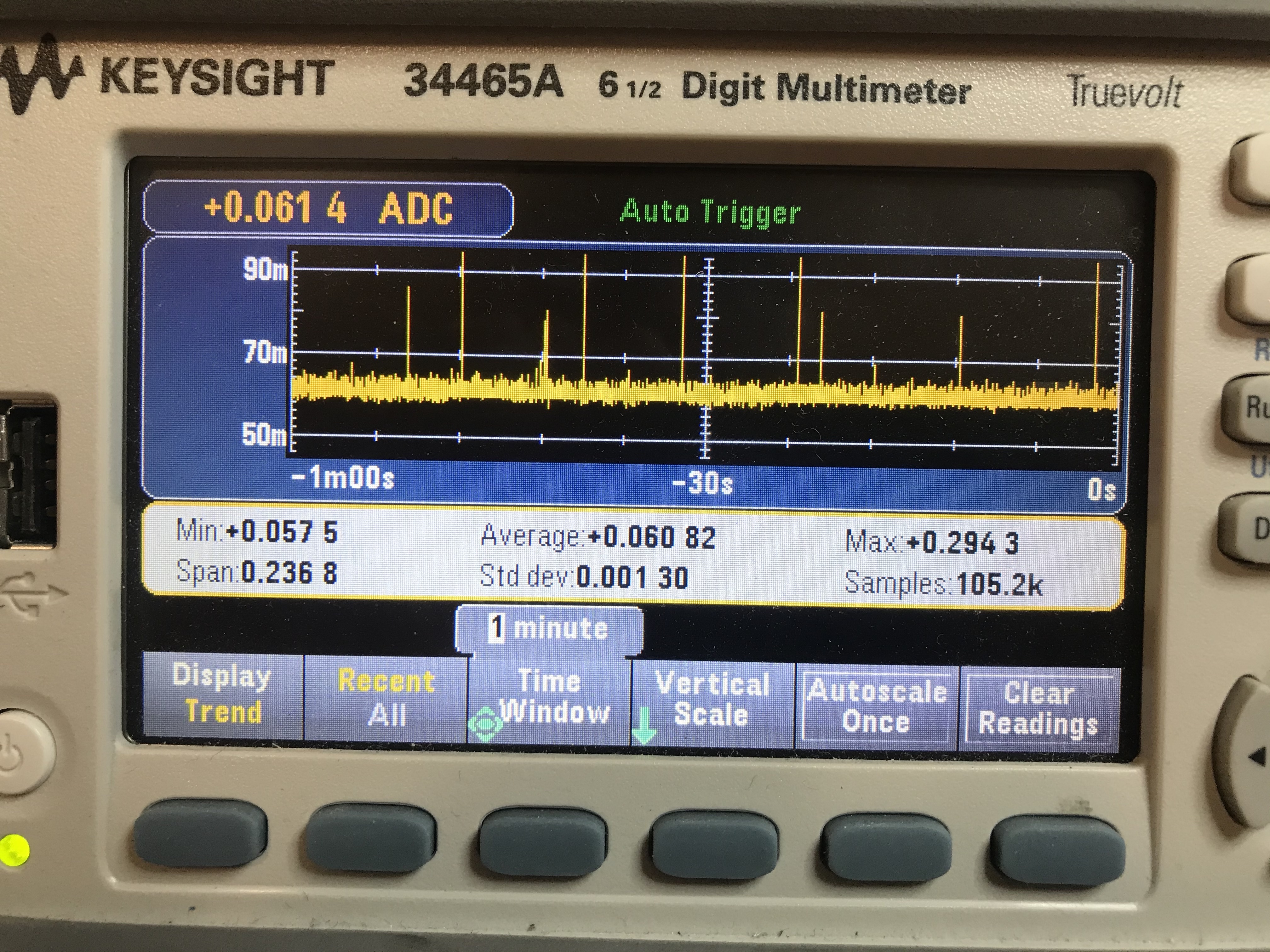

    By using tcpechotls_CC3235SF_LAUNCHXL_tirtos_ccs and using the file attached above:
    - Comment out SNTP_getTime() line 97 in startsntp.c, we get 733uA - fantastic:
    - Add SNTP_getTime() line 97 in startsntp.c, now >60mA steady:

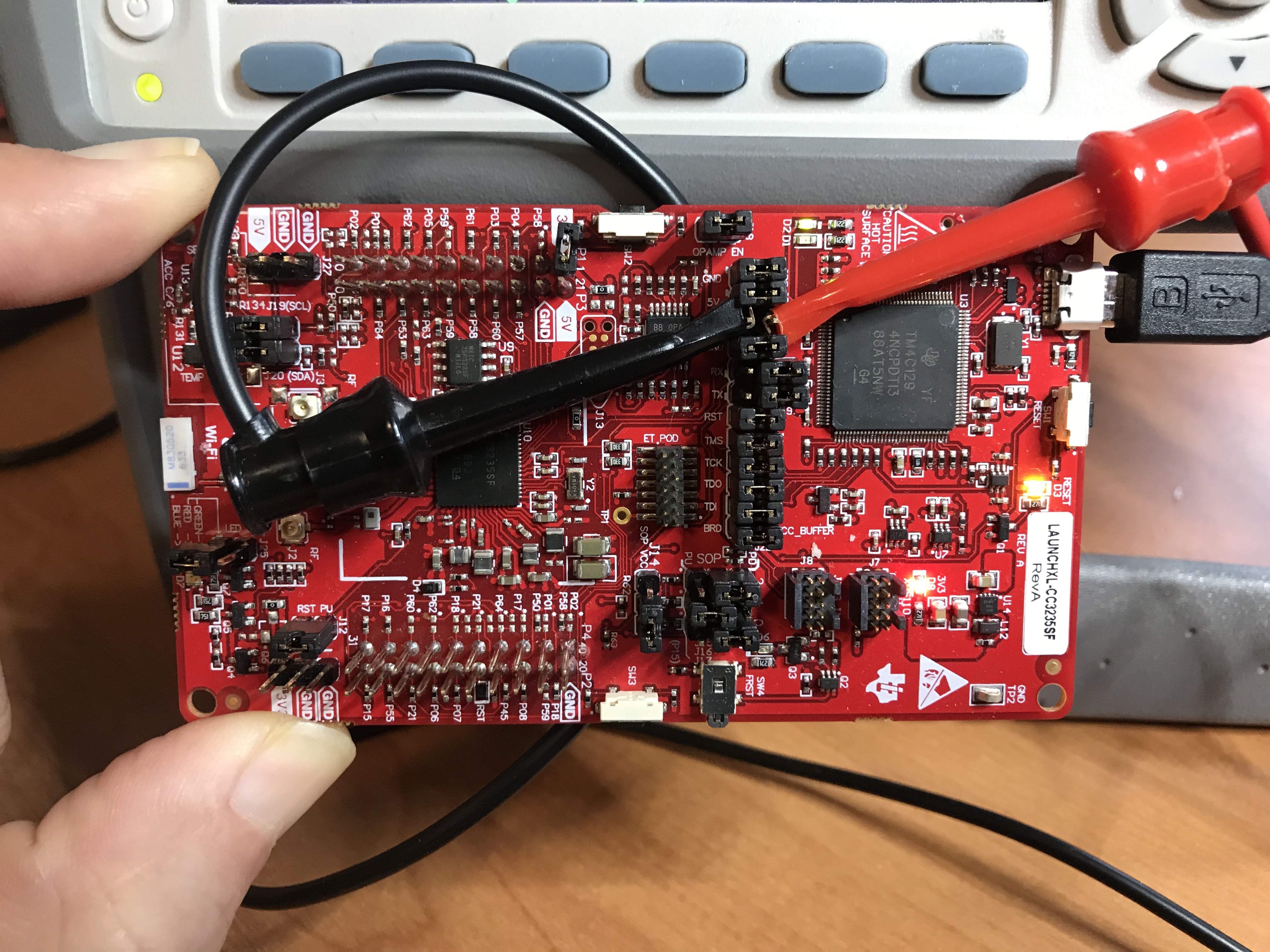

    DUT:
    With regards to:
     The device seemed to have entered LPDS after startSNTP returned
    How did you confirm that the device did enter its lowest WiFi Connected power state? Could you please post your own measurements back as per steps above?
    Will.

  • Thanks,
    I think you are misunderstanding.
    The board does enter LPDS initially but it is later, when further calls are made, which we've described at length, that power consumption jumps - and remains forever high. The JTAG disconnection is by no means an indicator.
    How can we progress this please?
    Will.
  • Hi Will,
    I was able to get my hands on some power measurement HW to run my test with more certainty and I can confirm I'm getting sub 1mA current after enabling the power policy when startSNTP returns. May I suggest you try working with the code I attached? I'm not getting the behavior you describe with startSNTP.
    Jesu

    3- Run and observe power draw in the 10s pause before call to SNTP, and then after.
    Here's the video: drive.google.com/.../view
    Can you share with us where you are measuring power draw from, and what SDK / Service Pack you are using. Here is ours:
    This is using simplelink_cc32xx_sdk_4_10_00_07, service pack sp_4.6.0.1_3.1.0.5_3.1.0.25.bin. Our board is RevA, Version details:
             CHIP: 0x31100019
             MAC:  3.1.0.5
             PHY:  3.1.0.25
             NWP:  4.6.0.1
             ROM:  8738
             HOST: 3.0.1.61

  • Hey Ralph,
    Sure,  as you say, just calling SlNetIfWifi_getConnectionStatus() seems to break Low Power, but I haven't investigated it any further. It's non-blocking and returns fine from what I have seen. It's unclear to me if other calls might have a similar effect. What I can say however and, even with the hack I posted earlier in this thread, logging the power draw over time shows it jumps up in the tens of milliamps for minutes at a time and then settles back down, even if the NWP holds a connection fine and no reconnect or network activity takes place. I can't see why this is.
    The cut down example above for TI to repro doesn't do anything with the time that is returned from SNTP, we want it to be as basic as can be to demonstrate it. Obviously the real firmware we are working on does use it, but as you can appreciate that's a moot point right now as Low Power doesn't work for us.
    Keen to see if you can share your experience.

  • Hey Will,
    I could finally reproduce the issue here. Not sure what I was doing differently before but oddly with the same test I get ~63mA on average. It seems like even when sleep is called the NWP stays awake which causes the current to remain high. Image below shows start up then sleep current after SNTP returns.
    I'm in the process of capturing some NWP logs to see what could be going wrong and working with some teammates in the background to identify the root cause.
    Jesu

  • Hey Will,
    I have good news. I was able to find the root cause and a solution that I verified via power measurement. Turns out sl_WlanGet in SlNetIfWifi_getConnectionStatus was causing some memory issues that we addressed via service pack. The service pack will be released in our next CC32XX SDK which should be coming out in the next week or two. Sorry for the delay.
    Jesu
