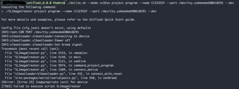

I am trying to flash the CC3235SF launchpad via the UART interface. For this I use the following Uniflash CLI command:
./dslite.sh --mode cc32xx project program --name CC3235SF --port /dev/tty.usbmodemE00A10291 --dev
When executed, the command returns 'Inappropriate ioctl for device' error:
If I omit the --port option, I am able to flash the chip. But now the flashing is done via the xds110 debug probe and that is something what I don't want.
Does somebody know what this error means and how I can fix it? I have already tried several versions of Uniflash, but I keep getting the same error.

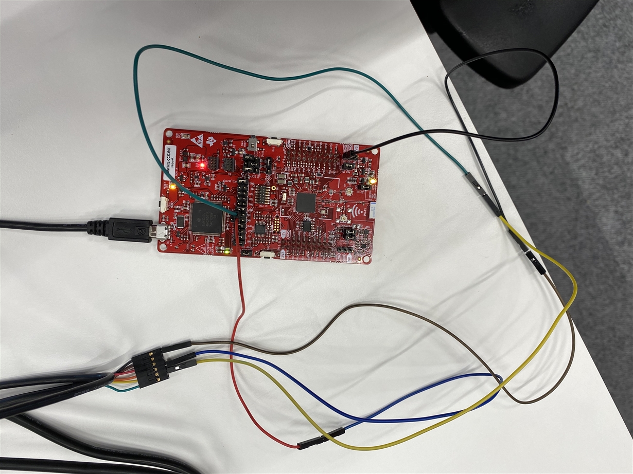

    I use a mac for flashing the CC3235SF launchpad. I tried the same command on a windows and I can successfully flash the launchpad with the --port option specified (and also without).
    I also tried it using a ttl-usb converter (TTL-234X-3V3). I disconnected the RXD and TXD jumpers on the launchpad and connected the CC3235SF side to the RXD and TXD of the ttl-usb converter respectively.

  • Hey Kobi

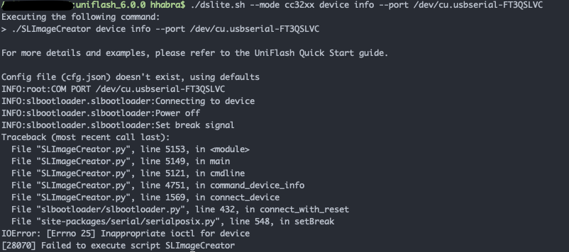

    Currently, we are designing/testing a custom board based on the CC3235SF. We want to flash it by using a generic ttl-usb converter (TTL-234X-3V3). When I try to flash (or request device information) using the ttl-usb converter. I got the 'Inappropriate ioctl for device' error whit specifying the --port option: ./dslite.sh --mode cc32xx device info --port /dev/cu.usbserial-FT3QSLVC. If I leave out the --port option, the commando fails because it is trying to connect to a XDS110 probe. (which is logical because there is no XDS110 attached to it).
    When I connect the XDS110 on the CC3235SF-launchpad to our custom board (only using TxD and Rxd, I manual reset the device so RST is not needed) and using the --port option. I got the same error. When omitting the --port option, it all works because imageCreator can detect a XDS110.
    This is the reason why I posted this question and why I wanted to try to flash the CC3235SF on the CC3235SF-launchpad without using the XDS110, because this gives us a more realistic scenario of what we want to accomplish.

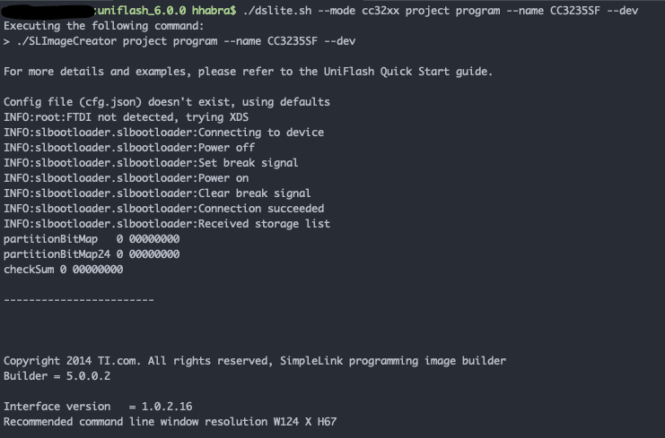

    MAC pc --> XDS110 (on CC3235SF-launchpad) --> CC3235SF (on CC3235SF-launchpad), leave out --port option ------> WORKS
    MAC pc --> XDS110 (on CC3235SF-launchpad) --> CC3235SF (on CC3235SF-launchpad), with --port option ------> FAILS (Inappropriate ioctl for device)

    MAC pc --> XDS110 (on CC3235SF-launchpad) --> CC3235SF (on our custom board), leave out --port option -------> WORKS

  • It looks like the ttl-usb converter doesn't support the “break signal” ioctl which is required for our bootloader connection.
    XDS does implement it and usually the UART drivers should contain it.

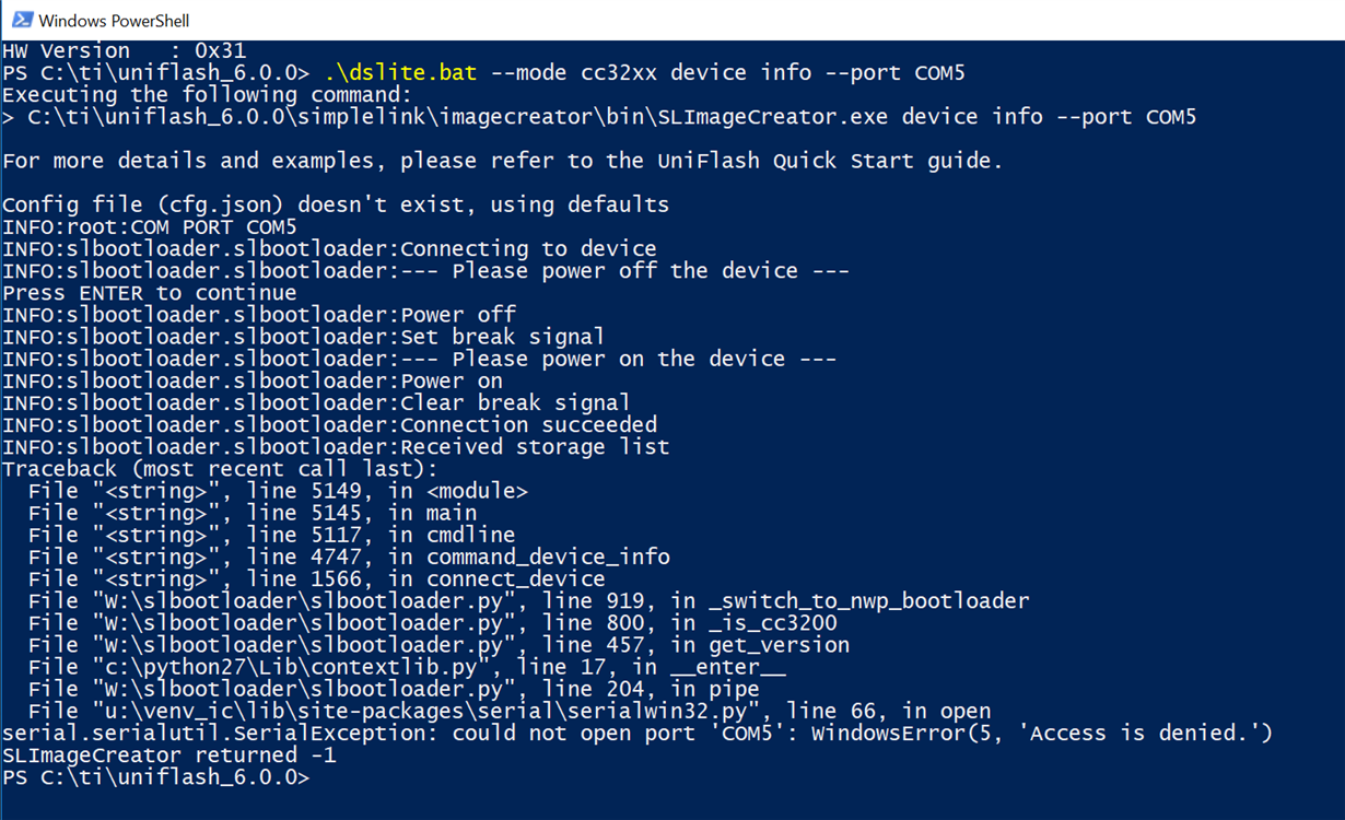

    As RogerMonk answered in this post: https://e2e.ti.com/support/wireless-connectivity/wifi/f/968/p/635118/2344247#2344247. It is possible to use a generic FTDI ttl-usb converter to flash the microchip.

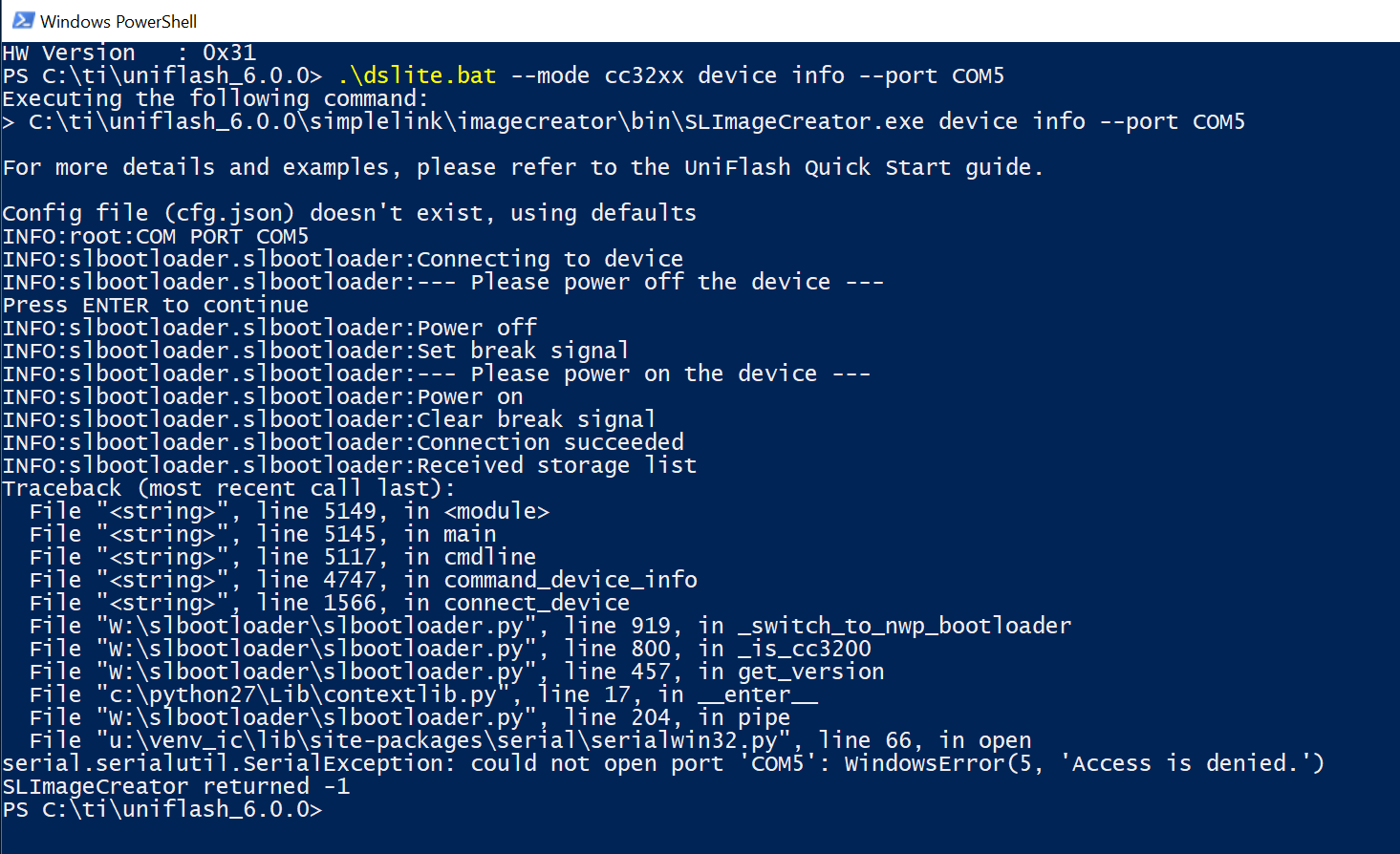

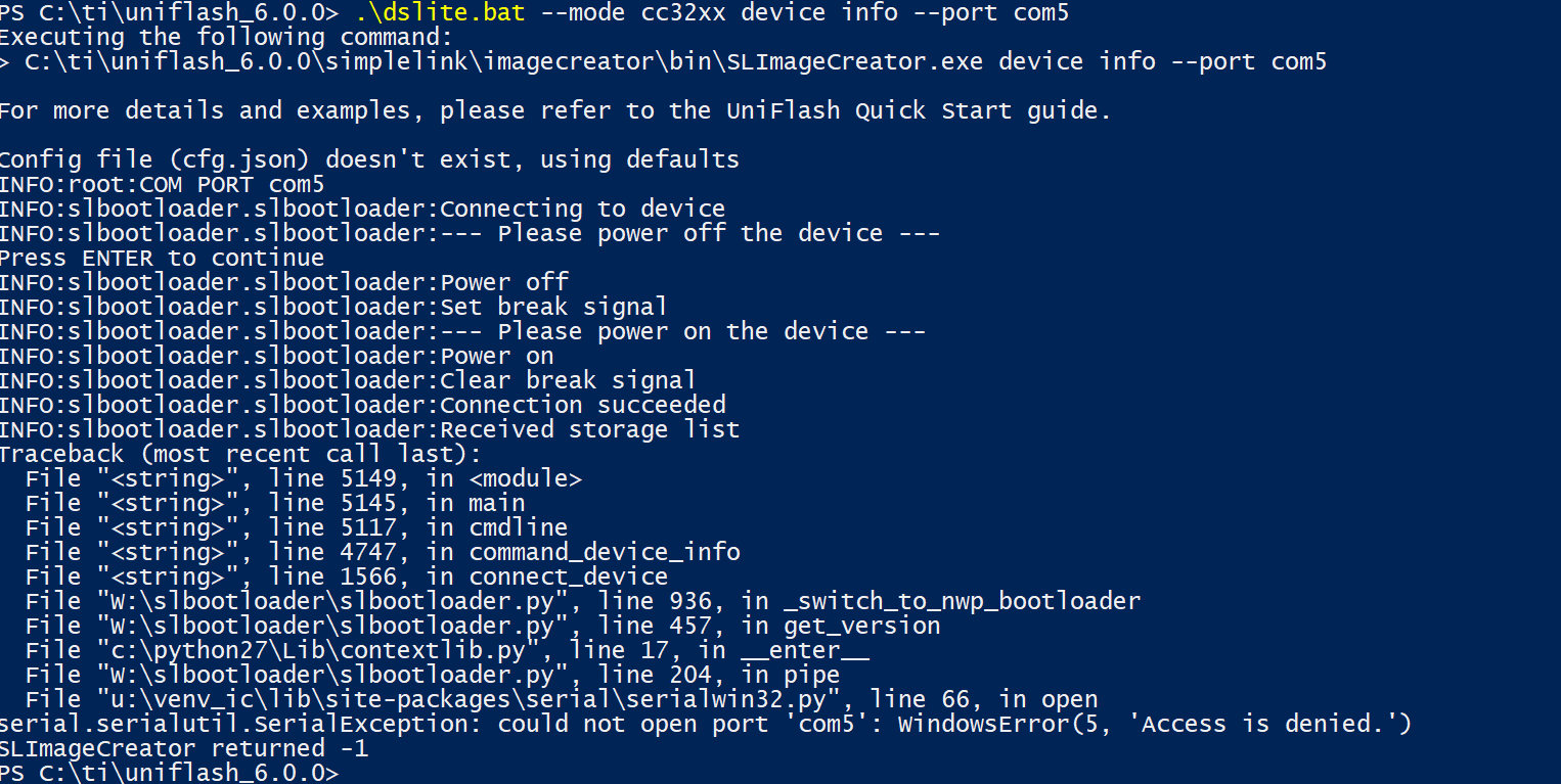

    I have also tried requesting the device info from our custom board using a generic FTDI ttl-usb converter on a windows pc. The ttl-usb converter can set the break signal, but then at the 'receive storage list' step I got the error: Could not open port com5.
    So this means that the ttl-sub converter is able to set the 'break signal' on windows.
    Is it possible that there is a bug in the uniflash software on mac? Also, do you know why I get the 'Could not open port com5' on a windows pc?

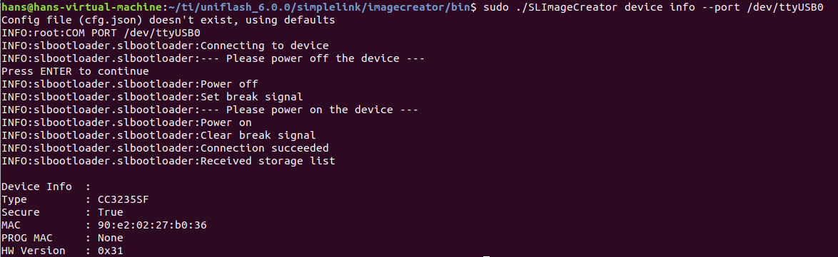

  • Update:
    I tried requesting the device info from (& flashing) our custom board on ubuntu with the ttl-usb converter from FTDI and the —port option specified. This works like expected. And it also works through the XDS110 on the CC3235SF launchpad.
    Ubuntu —> generic ttl-usb —> custom board
    Ubuntu —> XDS110 on CC3235SF launchpad —> custom board
    I used Ubuntu 18.04.4 LTS and the latest version of uniflash (version: 6.0.0).

    EDIT:
    We solved flashing on a windows machine. The problem was due the fact that I used a company laptop and there was a policy active that prohibit writing to a com port.
    The issue on macos still exists. The 'inappropiate iotl for device' comes from pyserial, because it cannot set the break signal. I have found an issue on the github page of pyserial explaining that some tweaks need to be made to successfully set the break signal on macos https://github.com/pyserial/pyserial/issues/103. Is it possible that your tools team could have a look at this, because I think there is a bug or misconfiguration in the uniflash software for macos.
    I have tested this on macos catalina (10.15) and mojave (10.14)
  • so just to clarify:
    Does the issue exist on mac os even with XDS when using the "--port" option?
  • Sorry for my late reply...
    Yes, that is correct.
    When using the XDS on macos and specifying the --port option, it returns the 'inappropiate iotl for device'. Using the same setup on a Windows or Linux machine it all works
  • Ok. thanks.
    This was reported as a bug and will be solved in on e of the next releases.
