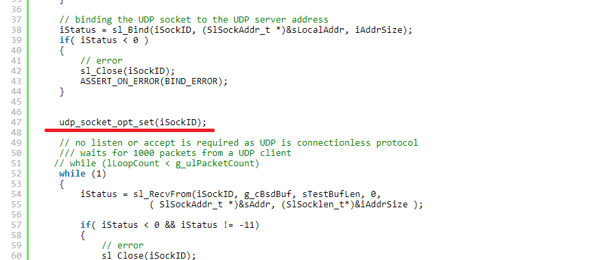

I use the udp_socket project it appears unknown delay(about 16ms), Based on this project, only modified the following parts:
int BsdUdpServer(unsigned short usPort)
SlSockAddrIn_t sAddr;
SlSockAddrIn_t sLocalAddr;
int iCounter;
int iAddrSize;
int iSockID;
int iStatus;
long lLoopCount = 0;
short sTestBufLen;
int count = 0;
// filling the buffer
for (iCounter=0 ; iCounter<BUF_SIZE ; iCounter++)
g_cBsdBuf[iCounter] = (char)(iCounter % 10);
sTestBufLen = BUF_SIZE;
//filling the UDP server socket address
sLocalAddr.sin_family = SL_AF_INET;
sLocalAddr.sin_port = sl_Htons((unsigned short)usPort);
sLocalAddr.sin_addr.s_addr = 0;
iAddrSize = sizeof(SlSockAddrIn_t);
// creating a UDP socket
iSockID = sl_Socket(SL_AF_INET,SL_SOCK_DGRAM, 0);
if( iSockID < 0 )
// error
ASSERT_ON_ERROR(SOCKET_CREATE_ERROR);
// binding the UDP socket to the UDP server address
iStatus = sl_Bind(iSockID, (SlSockAddr_t *)&sLocalAddr, iAddrSize);
if( iStatus < 0 )
// error
sl_Close(iSockID);
ASSERT_ON_ERROR(BIND_ERROR);
udp_socket_opt_set(iSockID);
// no listen or accept is required as UDP is connectionless protocol
/// waits for 1000 packets from a UDP client
// while (lLoopCount < g_ulPacketCount)
while (1)
iStatus = sl_RecvFrom(iSockID, g_cBsdBuf, sTestBufLen, 0,
( SlSockAddr_t *)&sAddr, (SlSocklen_t*)&iAddrSize );
if( iStatus < 0 && iStatus != -11)
// error
sl_Close(iSockID);
ASSERT_ON_ERROR(RECV_ERROR);
lLoopCount++;
//UART_PRINT("iStatus = %d\r\n",iStatus);
UART_PRINT("0");
delay_us(900);
if(iStatus>0)
UART_PRINT("11111111111111111111111111111111111111111111111111iStatus = %d\r\n",iStatus);
UART_PRINT("Recieved %u packets successfully\n\r",g_ulPacketCount);
//closing the socket after receiving 1000 packets
sl_Close(iSockID);
return SUCCESS;

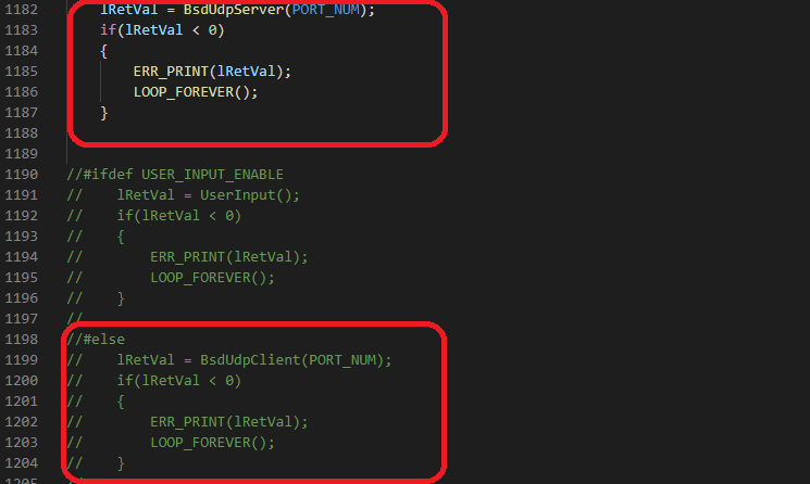

// MAIN FUNCTION
void main()
long lRetVal = -1;
// Board Initialization
BoardInit();
// uDMA Initialization
UDMAInit();
// Configure the pinmux settings for the peripherals exercised
PinMuxConfig();
// Configuring UART
InitTerm();
// Display banner
DisplayBanner(APPLICATION_NAME);
InitializeAppVariables();
// Following function configure the device to default state by cleaning
// the persistent settings stored in NVMEM (viz. connection profiles &
// policies, power policy etc)
// Applications may choose to skip this step if the developer is sure
// that the device is in its desired state at start of applicaton
// Note that all profiles and persistent settings that were done on the
// device will be lost
lRetVal = ConfigureSimpleLinkToDefaultState();
if(lRetVal < 0)
if (DEVICE_NOT_IN_STATION_MODE == lRetVal)
UART_PRINT("Failed to configure the device in its default state \n\r");
LOOP_FOREVER();
UART_PRINT("Device is configured in default state \n\r");
// Asumption is that the device is configured in station mode already
// and it is in its default state
lRetVal = sl_Start(0, 0, 0);
if (lRetVal < 0 || lRetVal != ROLE_STA)
UART_PRINT("Failed to start the device \n\r");
LOOP_FOREVER();
UART_PRINT("Device started as STATION \n\r");
UART_PRINT("Connecting to AP: %s ...\r\n",SSID_NAME);
//Connecting to WLAN AP
lRetVal = WlanConnect();
if(lRetVal < 0)
UART_PRINT("Failed to establish connection w/ an AP \n\r");
LOOP_FOREVER();
UART_PRINT("Connected to AP: %s \n\r",SSID_NAME);
UART_PRINT("Device IP: %d.%d.%d.%d\n\r\n\r",
SL_IPV4_BYTE(g_ulIpAddr,3),
SL_IPV4_BYTE(g_ulIpAddr,2),
SL_IPV4_BYTE(g_ulIpAddr,1),
SL_IPV4_BYTE(g_ulIpAddr,0));
lRetVal = BsdUdpServer(PORT_NUM);
if(lRetVal < 0)
ERR_PRINT(lRetVal);
LOOP_FOREVER();
//#ifdef USER_INPUT_ENABLE
// lRetVal = UserInput();
// if(lRetVal < 0)
// ERR_PRINT(lRetVal);
// LOOP_FOREVER();
//#else
// lRetVal = BsdUdpClient(PORT_NUM);
// if(lRetVal < 0)
// LOOP_FOREVER();
// lRetVal = BsdUdpServer(PORT_NUM);
// if(lRetVal < 0)
// LOOP_FOREVER();
//#endif
UART_PRINT("Exiting Application ...\n\r");
// power off the network processor
lRetVal = sl_Stop(SL_STOP_TIMEOUT);
while (1)
_SlNonOsMainLoopTask();
If I add the delay sentance"delay_us(900)" to the code, the unknown delay time will disappear.If not,it will appear about
16ms delay time,such as the following picture.Why is it?Can you help here?
